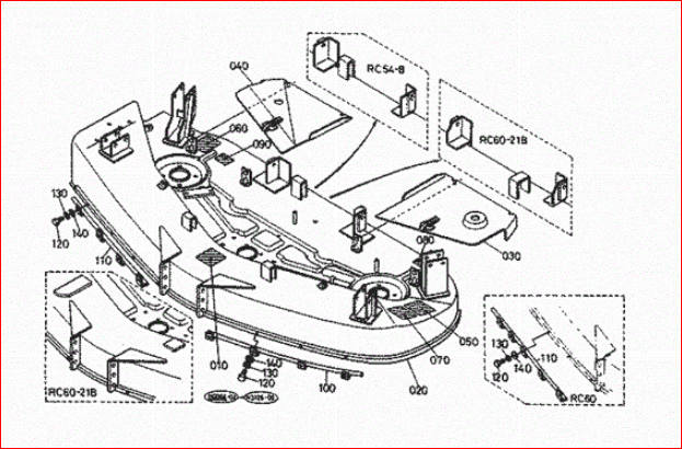

I have a BX 1750 that I bought and somebody painted the deck and the model number plate is gone. Is there any way to tell what model deck by the serial number from the tractor? Serial number 60738 is on tractor.

BX1750? OR is it a B1750?
If the latter - then it should be a RC60-B

They tell me that the bevel gears can be found for that model. Will any other gear box work?
Hello Waubuno1
If the deck is a RC60-B (the model deck specified for your tractor), the gearbox is a 67539-99040. The gearbox is supposed to fit the RC60-21B and RC60-B decks. Messicks wants $1112.86 for the gearbox complete. I didn't check the availability of individual parts.
