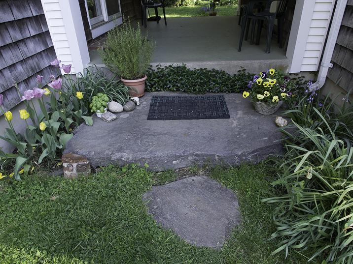

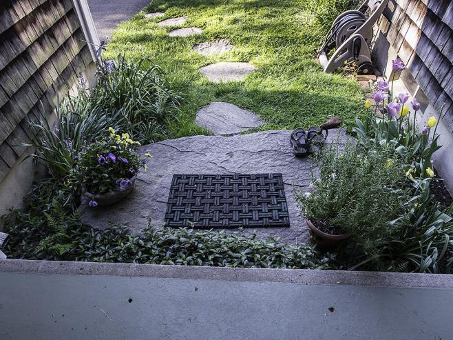

..flat stone which is acting as a doorstep... but needs to be higher.
Only access is from straight on... the stone is wider than my lift bucket.
My thought is to use a stone and crowbar to lever it up... weight is to be the downthrust of the bucket. Then shove a few bricks under and as far back as possible... praying that the lever doesn't slip... (I'll use a 2x4 to shove the bricks. No way i'm gonna get my hands near that.) Hopefully the bricks can get far enough under it so that i can put the bucket, or back wheels on the stone, tilting the stone forward... then i can put bricks under the far edge...
The whole thing needs to go up about 3-4 inches.
Ideas??

I think Glen has it. If you can get the lip of the front bucket under the thing and then curl the bucket back it'll probably lift. The curl cylinders have a lot more leverage than the lifting cylinders. A pair of shovels and some 2x4s would probably do it too. Get it up pretty high, slide a few rows of bricks or shovel some fine gravel in there and lower it down. The back should pop up and then you can finish the job. Just take it slow, don't want to get hurt and I'm guessing there'll be hell to pay if you drop a rock on those flowers :)

Thanks to all of you... The crux of the whole problem is that the front edge of the loader is too short.. The FEL has the guts to tilt it up, i'm sure.
I think I'll drive a chain under it, wrap it around and use another chain to lift the back edge, brick that up, lower the rock, rehook at the front edge, tilt and brick that.
And all the while listening to pained squeals when the grass gets crimped...
No way i'll do this while the spring flowers are in bloom... :) That order has been issued.
Sigh, it ain't easy being me.

Whats stoping you from geting another piece of stone smaller in size and adding an extra step? It would save on flingers, limbs and plants and wouldn't look bad either.
Other thought just lift up the front edge that you can get too and stand it up on end and build up the ground underneath.

Well....Eric's got my vote...add another step ....BTW....the tulips are very pretty....

From the picture I assume that the rock is about 6 to 8 inches thick and setting "on the surface" and not buried deeply.
I would try to get some scissor jacks (from the cars in the junk yard), dig down and under the edges of the rock, put some pad (2 x 12?) on the dirt then the jack. Jack the rock up a little at a time on each corner and get it somewhat higher than you really need. Block it up securely and install whatever (concrete, rock dust, gravel) you want to fill in space under the rock. I think I would use some concrete and pour it into the cavity under the rock. Then lower the rock into the concrete bed. "Gently" hammer it or press it down with the tractor if needed to level it.

I'd get a webbing sling and tip the back end up, dump some course gravel & spread it around with a rake, drop it back down and lift the front slightly, put gravel there and it'd be done. Bricks provides little surface area. I would have said sand first but you'll have some spillage on the sides. Doing the front first would make filling the back difficult.
