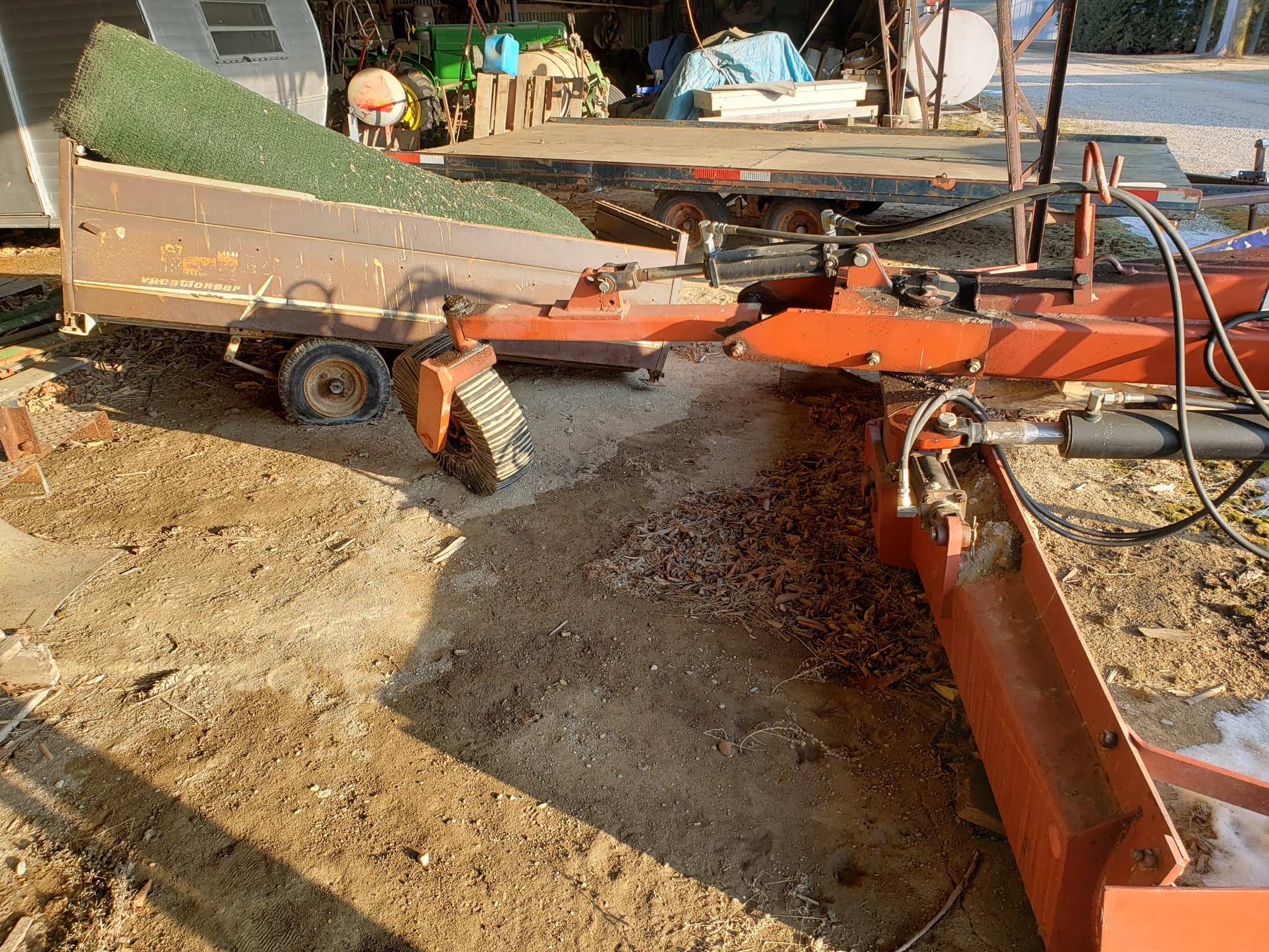

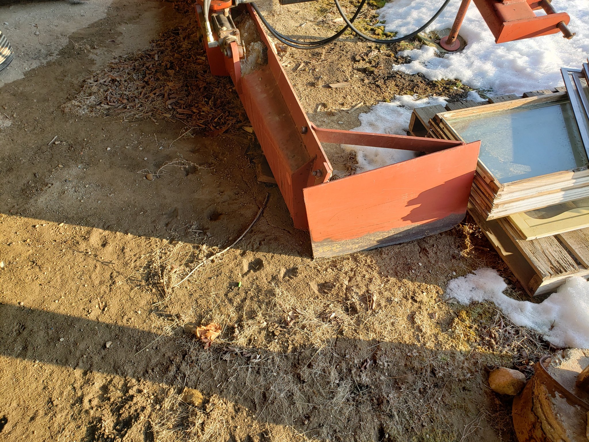

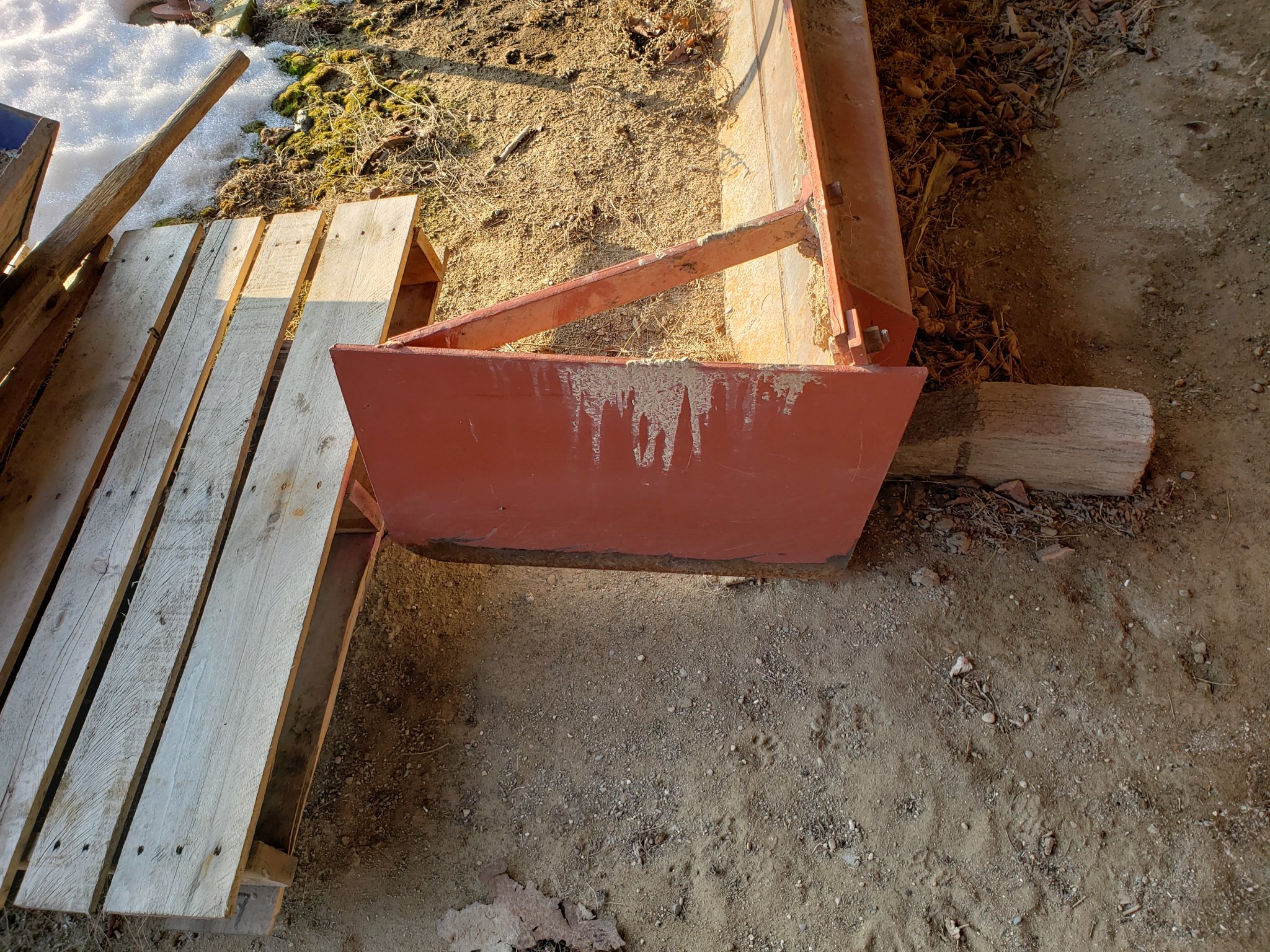

This is a Rhino blade I use on a MX. I don't have pictures handy of the Land Pride we use behind a L3560, but the concept is the same. With the side plates on it will haul quite a lot of dirt. The tail wheel really makes it a much nicer unit to do more precision grading, but if you have a small job and time and patience, you can still do a good job. I've used this blade to build and maintain roads, To put a crown on, and I've dug a pretty decent size drainage ditch with it. Plan on similar jobs with the Land Pride.

We built the side plates (wings) on the blade I posted pics of out of scrap we had around. I am now where I can get some pics of the side plates on the Land Pride blade,. but they attach to existing holes on the ends of the blade moldboard. I think its 3 bolts there, plus the support arm takes one bolt, They can be put on or removed in minutes, especially if you have a cordless impact available.

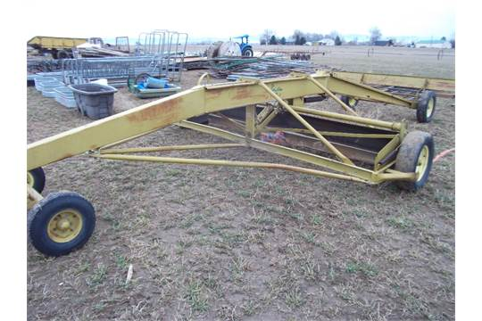

This is the style of leveler we used on some of our land. It works fine for filling dips, has some limitations though.

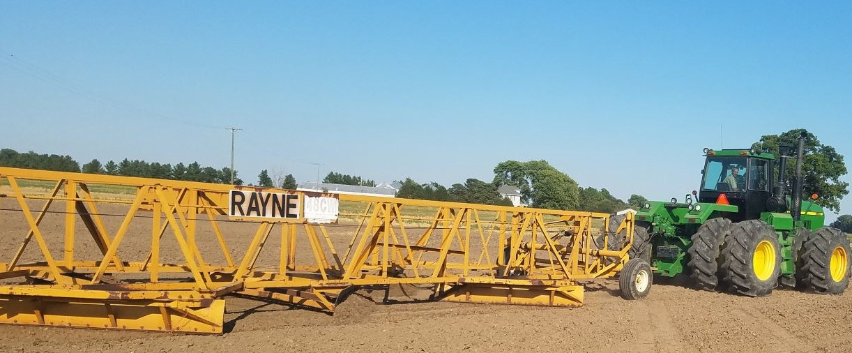

This is a leveler we use now. I've covered about a 1/3 of our farm with this particular leveler, and would like to eventually do another third. Lots of iron engaging the ground, but it works well because of the length of the tool - its 48' long. Its tough to replicate the job something like this will do when we're talking about sub 80 hp tractors. But, the concept of spreading stuff out a bit is still relevant. I think anyway.
