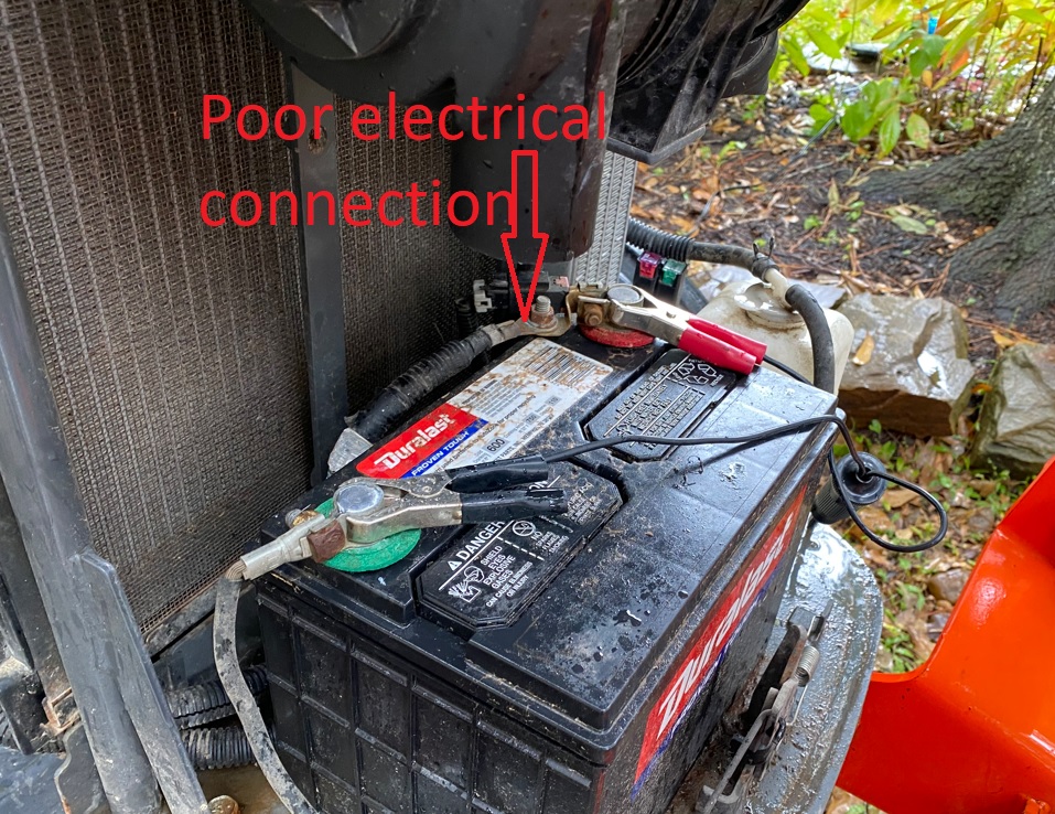

Problem solved. I pulled the positive wire, scrubbed both ends with a wire brush. Used a little electrical grease. Then tightened it back down. It started right up.
Thank you all for your help and suggestions.
I would suggest cleaning the negative side also. It is probably about the same.

Ok, it’s not the starter. The battery is constantly 12v even when I turn the key. When I connect to the positive on the starter, it's 12. When I turn the key, it drops to almost zero.
I had read the above and replied with below, and sure enough that’s what was wrong. So my perfect logic and testing method led you down the right path, good find.
If the starter checks out and works, test the main battery feed cable to the starter, the positive cable that goes to the starter. You can test it for continuity but what I like to do as it sometimes might show 12v but falls on its arse when you try and start it is remove that cable from the equation and attach a jump lead, so run a jump lead from the battery positive terminal to the starter
