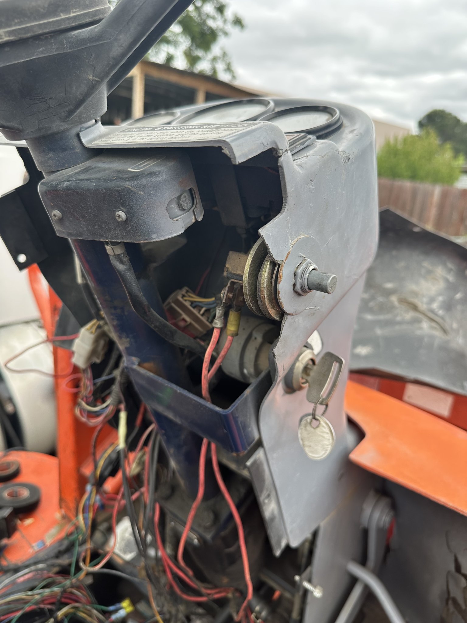

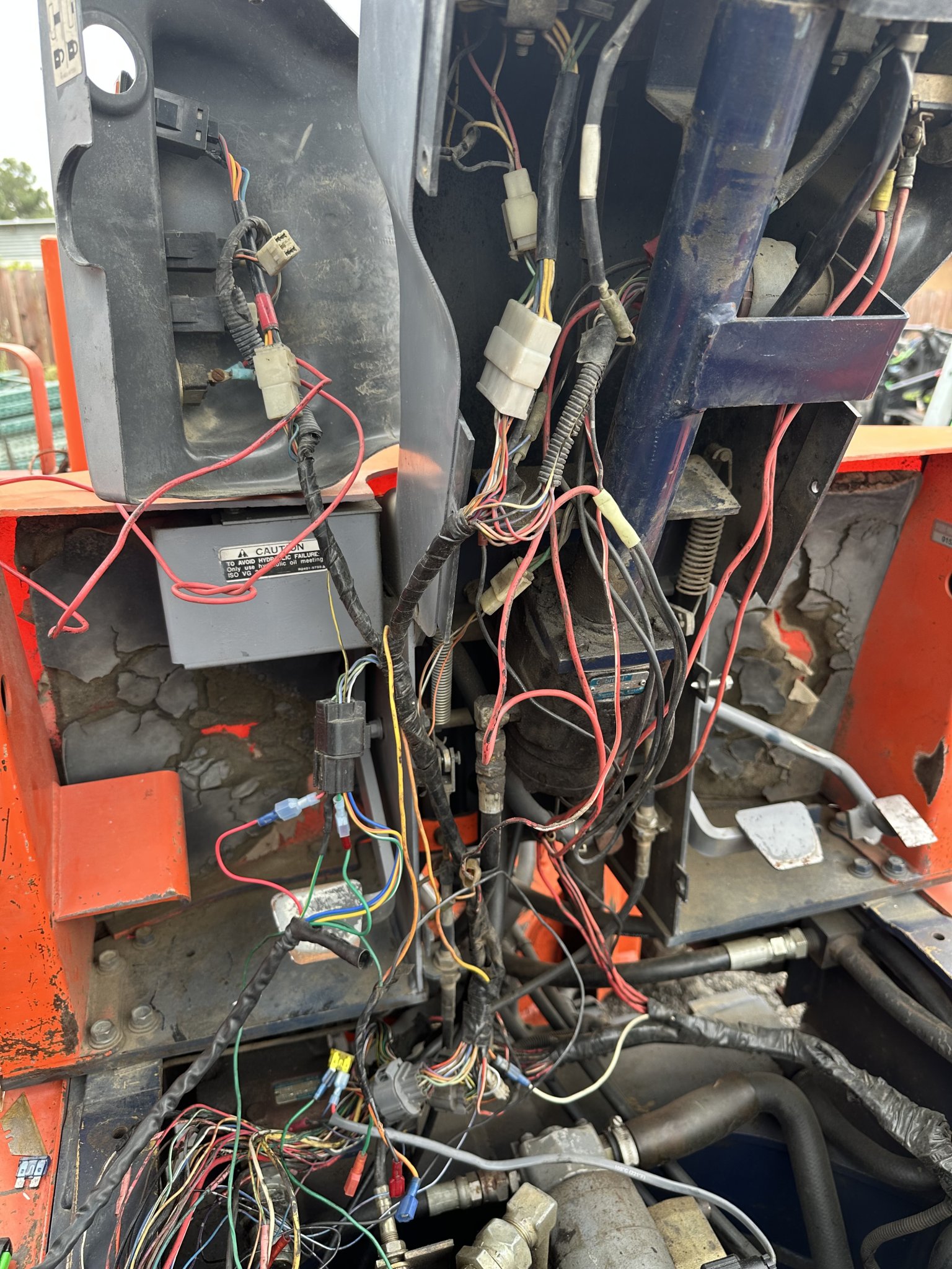

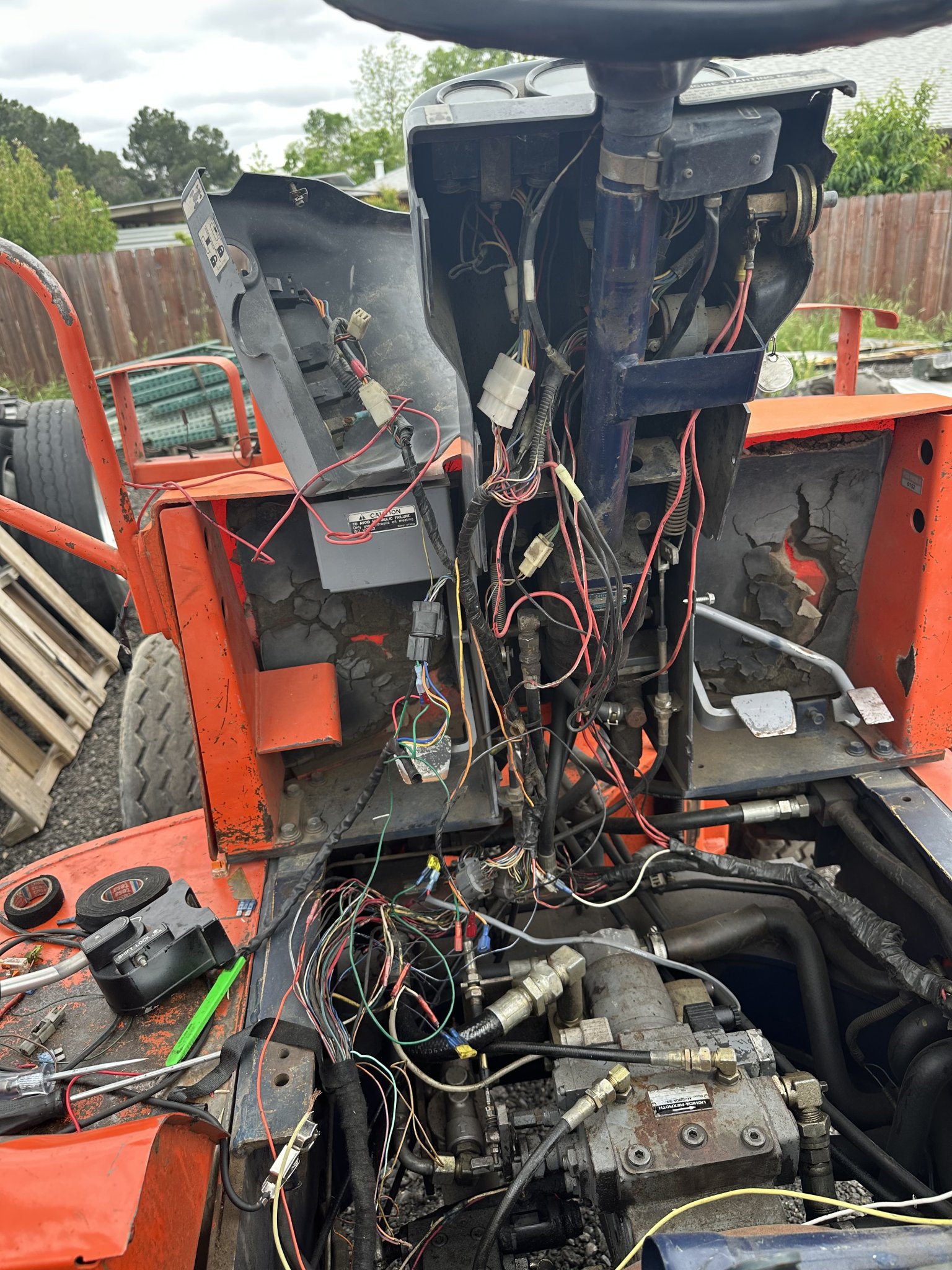

I need to buy wiring harness for a 2004 Kubota r420 serial number 10256 and part number for the wire harness is R2401-53413.
Any ideas where I can buy it I’ve been searching for days

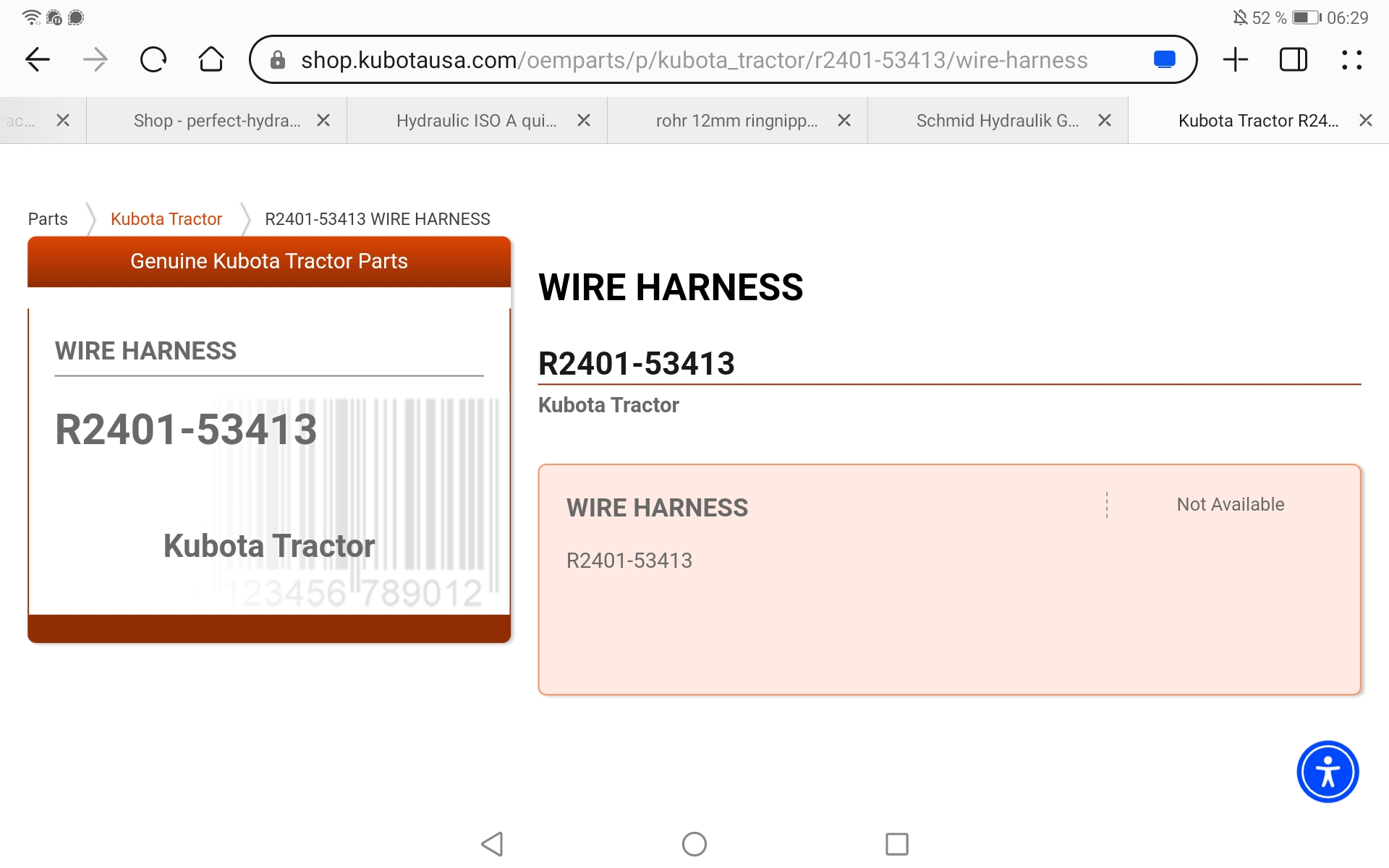

Seems it is not available (any more?).
There are mutiple versions of that harness, that's why you get that message in a normal search.

Wolfman said there are several versions. Maybe one with another number can be used and is available. But I would not have a clue how to find out. A good dealer would know.

Did you look at the link in Wolfmans post #5? It looks as if there are several wire looms required, each available in different versions. I do not know what the difference between those versions is but it may not be a 1:1 swap; you may have to spend a lot of time there too. And that after paying between $2000 and $4000 :oops: depending on the versions you need.

My sympathies. I was expecting that it burnt up or had a major rodent event. Are you doing this as a restoration or just need it to be functional? And safe?
I rewired much of my ol B7100 but it's a MUCH less complex electrical system. But the biggest PITB for me are harness interconnects and the various terminations. And wire colors. Just a long exercise of patience and good tools. It's terrible to strip wire when it's corroded and badly tarnished under the insulation.
Best wishes. And do yourself a favor and get wire from a supplier like Platt or Graingers. And shrink tube with adhesive sealant.

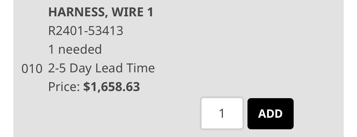

I allready know what exact wire harness I need I have the part number and the price for it is around 1,300-1,500$ I know that there’s different versions of it so I contacted the dealer and they gave me the vin of the exact part that fits my tractor.
the thing is it’s discontinued and I can’t find it at other companies either and I don’t know how else can I find it other then messicks,dealer,another Kubota I need ideas and recommendations

@david_vechirko , are you good with electrical stuff? Just seeing that abortion of wires in your pictures would have me finding individual problems vs replacing a harness in total. And how much stuff has to come apart so you can lay in the new harness and dress it out?
Are you going to open up everything and lay the new harness in with the old and remove/reconnect circuits one by one? Or will you totally remove the old one, lay in the new one, and all the connections will be logical? I don't want to be a naysayer but you have a huge project on your hands regardless of the direction.

Assuming the machine does NOT run, carefully remove 100% of the wiring harness as ONE piece.
layout on a clean,white painted 4by8 worktable,
take lots of pictures,
remove any obvious 'addons'.
print of the wiring diagram(s) and start 'ringing out' every wire.
use a 'highlighter' to mark which wires you've confirmed as good.
