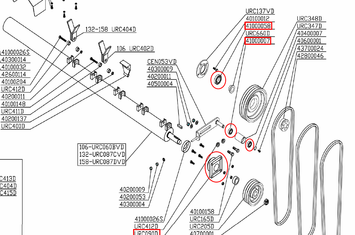

Last summer I noticed a "chirp" with the cutter running and reached out to Good Works Tractor Co. I told them I might not have pumped enough grease into the cutting drum bearings and asked them to quote replacement bearings. They sent out a complete set of bearings at no charge which is above and beyond what I expected. Other than the chirp, I've had no maintenance issues so far, and the quality is evident wherever you look.
@mcmxi Came across this reply as it looks like I have a bearing out on the cutter shaft on my Del Morino (a smaller funny top). How was pulling the shaft, did you need to remove the belts / pulleys / etc? The schematic doesn't show much on how it attaches on the far side, so figured I'd ask while the bearings are being shipped. Any info appreciated, and thanks.
My apologies for any confusion, but it was the bearing on the output shaft of the gear box that I needed to replace, which was an easy fix. See bearing # 41000058 in the schematic below (outlined in red at top of page).
Gotcha - thanks for the reply.
The bearing on the cutter shaft is what I'll need to replace, the URC090D in the image above. If anyone's curious will report back how that replacement goes.
Also I'm getting those bearings from Good Works, but looks like with the Ibex partnership / whatever that relationship is that parts including belts and blades/hammers are easier to come by on tractortoolsdirect.com with the same part numbers... ordered some stuff from there too as backup and will see how that goes. Prices generally better too.
I would definitely be interested in hearing how that bearing swap went. I wasn't sure what was causing the noise from my flail late last year but figured it was a bearing, so reached out to GWTC to get a price on replacement bearings and they sent me a complete set at no cost. I wasn't expecting that.

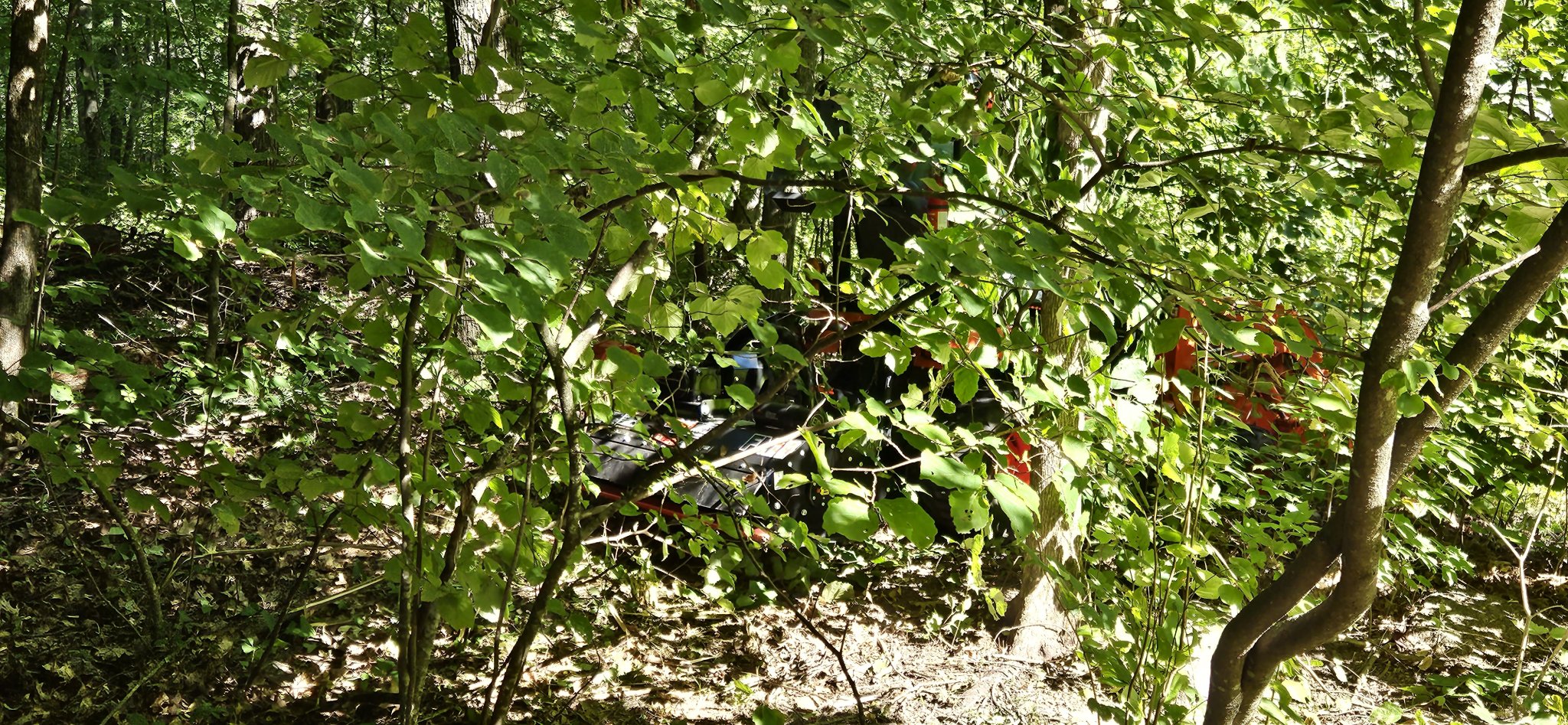

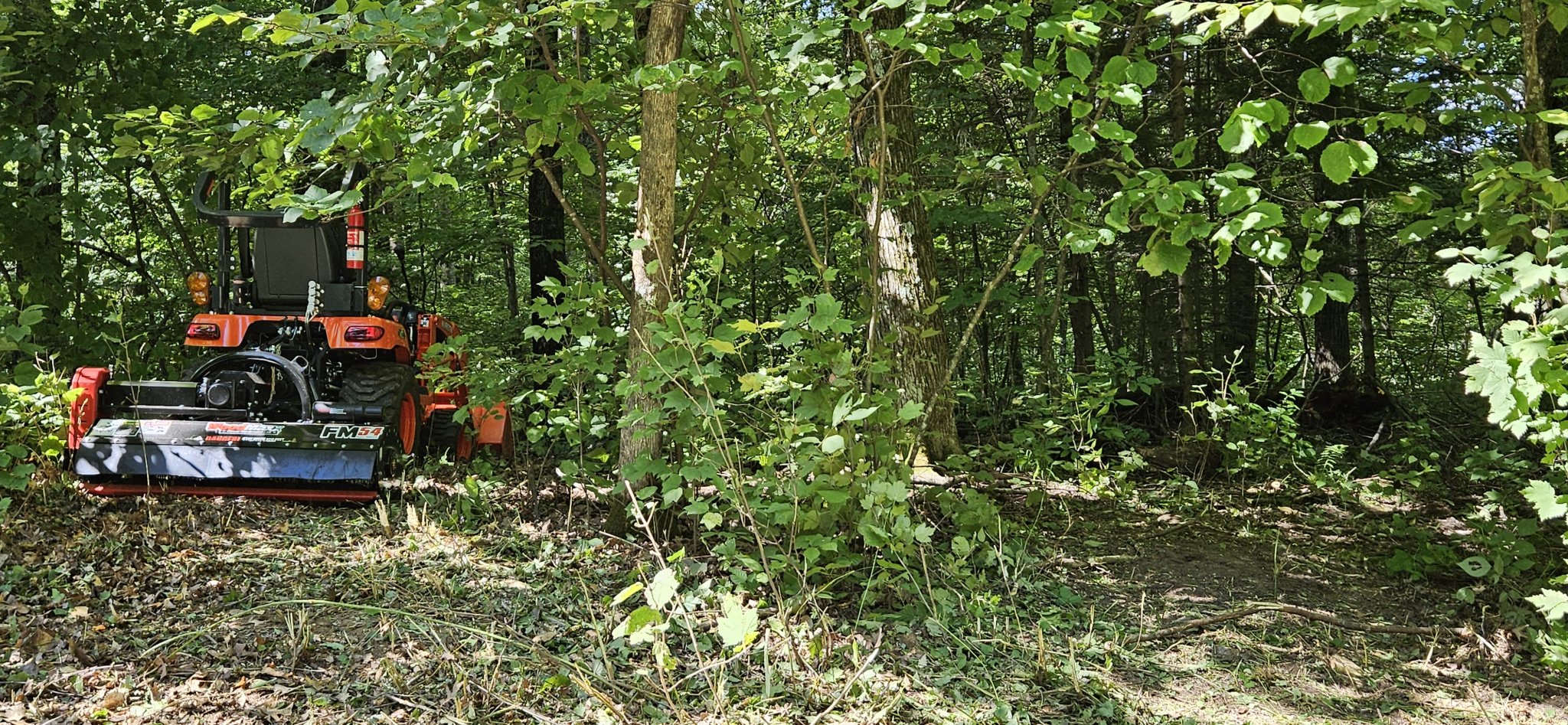

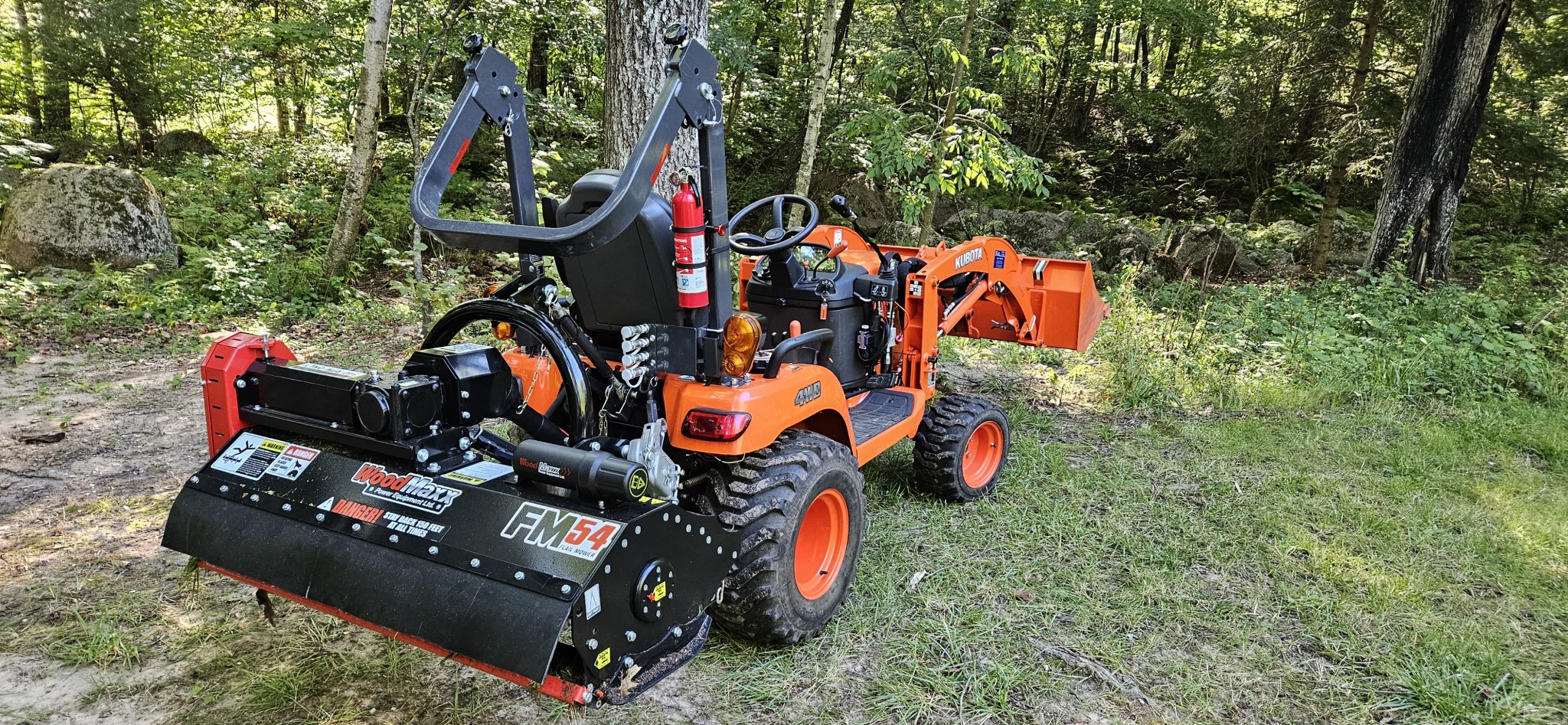

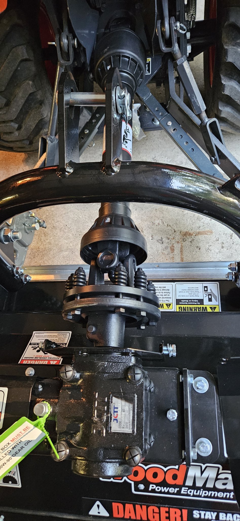

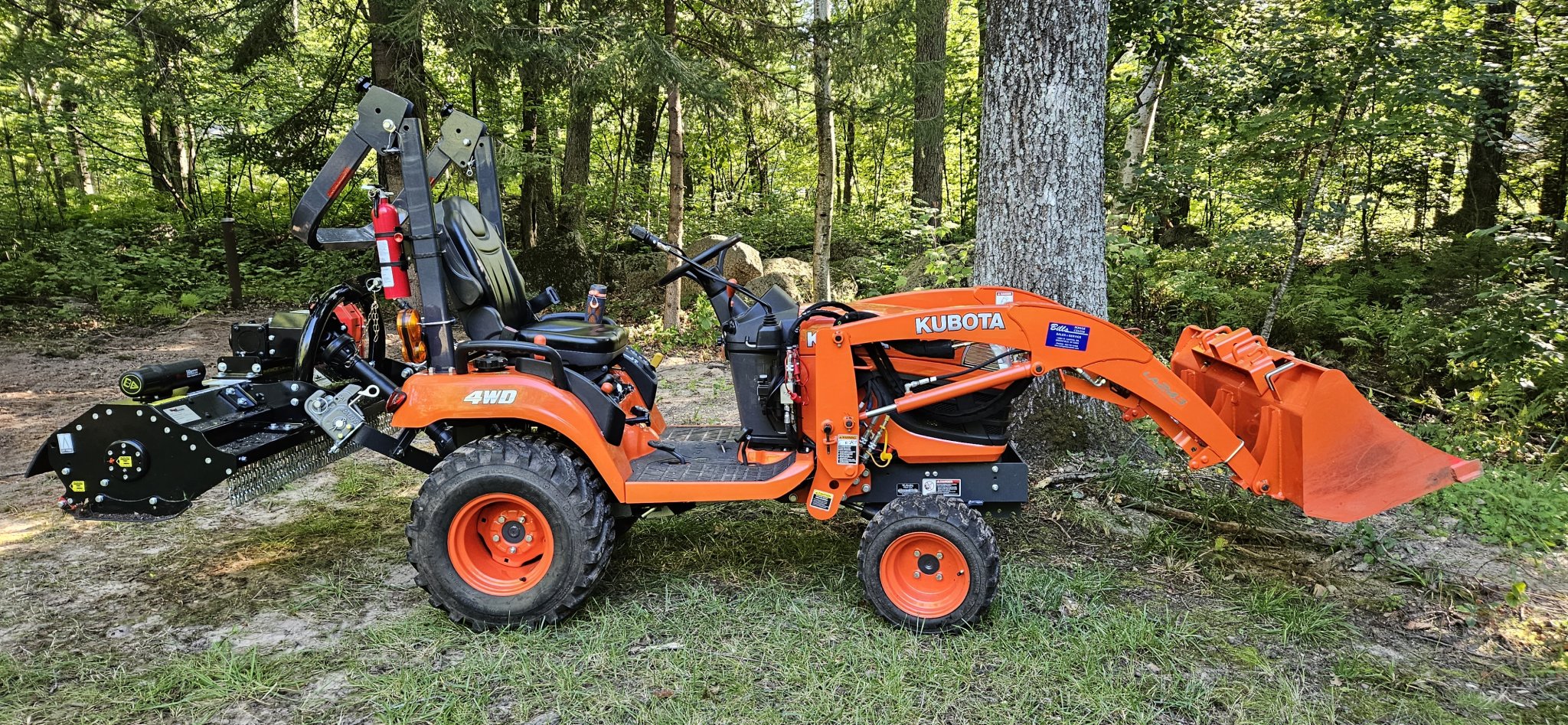

I've only had a few hours on the WoodMaxx FM-54, so far it's awesome. I have it set all the way up and still scalped a few rocks, the flails are in good shape considering and don't need sharpening despite the impacts.
The 6-point metric socket set I own doesn't have a 16mm, and that was an issue as the torque specs couldn't be reached with a 12-point (it slipped).
The slip clutch is beefy, the PTO shaft fit great on a BX without cutting.
WoodMaxx suggested having a fire extinguisher on the tractor so I added one.
Great balance with an empty bucket, plenty of ground clearance.

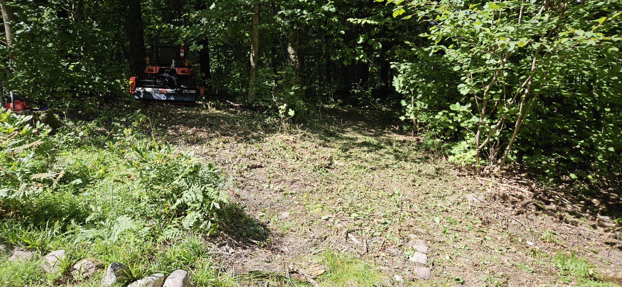

The "before" shot.
Cutting an opening behind the trees to the right with a tri-blade on a straight-shaft trimmer was unpleasant, I had to start high to see what needed to be cut at ground level and work my way down, but it was a good comparison of what a high-powered trimmer and brush blade required verses a flail mower. The brush trimmer was a lot of work and progress was slow.
I lowered the bucket, pushed the brush under the tractor, drove down the hill, and let the flail mower chew a path, then went back up the hill the same way. By comparison there is no comparison.
With the brush cutter there's fallen brush that needs to be picked up, with the flail mower there's mulch. The flail mower's roller and skids could be raised which will lower the blades for a closer cut now that the rocks can be seen, but there wasn't time this time.
I used the mower along the road and lawn edge with great results. This was a good investment and makes short work of clearing out 3/4" and smaller trees, brush, grass, brambles, ferns, briars, and pretty much anything I'd want to run over with a BX.
Adding mounts for a brush trimmer (for close cleanup) and chainsaw (for larger trees) is now on the to-list.

Very nice! Is the cutting drum driven by belts? My Del Morino doesn't have a slip clutch but does have three drive belts. The gear box has a free-wheel feature but that's to allow the cutting drum to spin down when the PTO is turned off. I assume that the belts will slip if there's too much resistance at the cutting drum.
WI_Hedgehog
Apr 24, 2024
1,129
1,646
Milwaukee, Wisconsin, U.S.A.
The cutting drum is driven by 3 belts that should not slip in order to reduce belt and pulley wear.
The drum spins down in approximately seven seconds. From what I remember, selecting the BX tractor's rear PTO locks up the PTO shaft and the shaft does not free-wheel, so IF I'm remembering correctly there is likely a one-way clutch in the FM-54 transmission.
The flail startup is really quiet, stopping is much quieter than in the videos though everything is new and the flails/bolts/arms don't have wear. It's kind of like running a mid-mount mower (until hitting something fibrous like a tree).

I have a slip clutch on both rotary cutters but none on the flail. I was just curious as to why WoodMax has a slip clutch on the PTO shaft but Del Morino doesn't.
WI_Hedgehog
Apr 24, 2024
1,129
1,646
I would guess cost, the slip-clutch is perhaps overkill, except that the WM-54 flails cut forward and want to dig in verses ride-over something like a smaller rock or stump. If the flails cut front-to-back and pulled themselves up-and-over a stump that might be different?
I'm new to more than a yard tractor with MMM, rear sweeper/bagger, tiller, and snow blower (though I do design & build stuff), so can only guess. Yours is a great question because the PTO shaft with clutch is heavy, and "that ain't free" so there's a reason it's there.
8,356
11,757
Maybe, maybe not. WoodMax has a great reputation, based largely on their US made chippers, but they also sell imported stuff from Asia. I'm fairly confident that their line of flails are not made in the US.
IronCraft flails (made in India) don't use a slip clutch on the PTO shaft, and in their manuals for their standard and heavy duty models they state ...
"The gearbox unit is equipped with a free wheel inside, able to absorb the rotor inertia during stopping, and to prevent possible damage to the transmission system machine-tractor that would be caused by an instantaneous stop of the rotor. Consequently, the use of a cardan shaft with free wheel is not required."
I've noticed that the rotor on my Del Morino will spin down for 15 seconds or so, maybe more, once I disengage the PTO. The Del Morino models also have a free wheel device inside the gear box.
WoodMax says this about the gearbox on the FM models.
"Cast iron 540 RPM with internal over-running clutch – when the PTO shaft is disengaged the built in over running clutch allows the PTO shaft to stop turning while the gearbox and rotor shaft slow down gradually. This is an important feature, without it, the gearbox will slam to a halt when the PTO is disengaged, causing stress to the gearbox and your tractor. This feature should not be overlooked when shopping for a mower."
Befco (not the Chinese knockoff company Betstco) also uses an over-running clutch in the gearbox but don't have a slip clutch on the PTO shaft. Befco is one of the top flail manufacturers in the world, and like many Italian based companies have a lot of experience with flails which are ubiquitous in Europe among farmers. So I have to wonder why WoodMax has one. Are they not confident in their gear box or the over-running clutch? I'm just curious as to the difference in design approach.

(great information snipped to respond to this part) I'm fairly confident that their line of flails are not made in the US.
WoodMaxx answered one of my e-mails regarding this: The flails are manufactured in China at a facility they have a long standing relationship with.
Hey, I'm curious to know how the install went on that URC090D bearing. I'm facing a bad bearing myself after only 20 hrs of use on a $4k mower, and I'm a little upset by this when everything has been lubed. Here's a video of the bad bearing, other side is fine but after this shaking I'm guessing I'll need 2.
I see I'll need a lock ring socket but curious as to what other special tools will be needed. While I'm still in my 24 month warranty, I'm thinking I'm stuck doing the repair myself or having the pay my dealership since they ordered it through a regional distributor.
Thanks for any help you can give.
