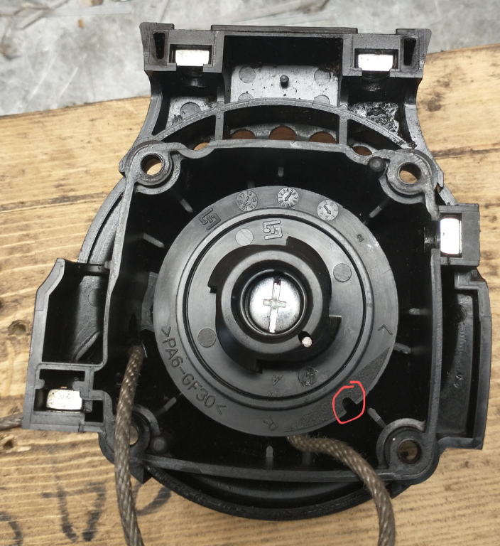

Reassembled. Brain was a bit dead, so it took me a while to figure out how to use the notch (circled in red) to wind up the rope. I turned the reel the wrong way a couple of times and bent the spring, but fortunately I was able to disassemble and bend it back. Only turn the reel in the direction that tightens the spring. The notch actually makes winding up the rope incredibly easy.
