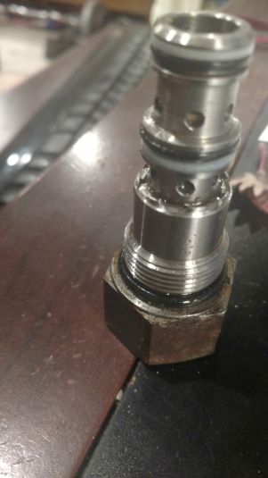

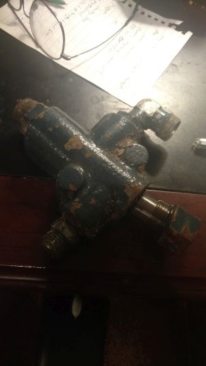

I am having a similar problem with my L3750. It is on at least its third priority valve now and symptoms of no loader/3 point power and slipping fwd reverse have returned worse than before, this priority valve is oem and less than 6 months old. ($523 each)
I checked out that discussion and it was useful, that person was able to file down his problematic plunger inside his priority valve. The L3750 has a different priority valve, and I am pretty sure the plunger is non serviceable (see photos). It is housed inside of a plug. (Photos are of a non OEM part that I pulled off my machine.)
Any ideas based on the diagrams and photos of how to service this plunger or bypass the priority valve. Could I rig up a priority valve from another machine?
33,940
9,154
Have you measured pressures into and out of the priority valve?
