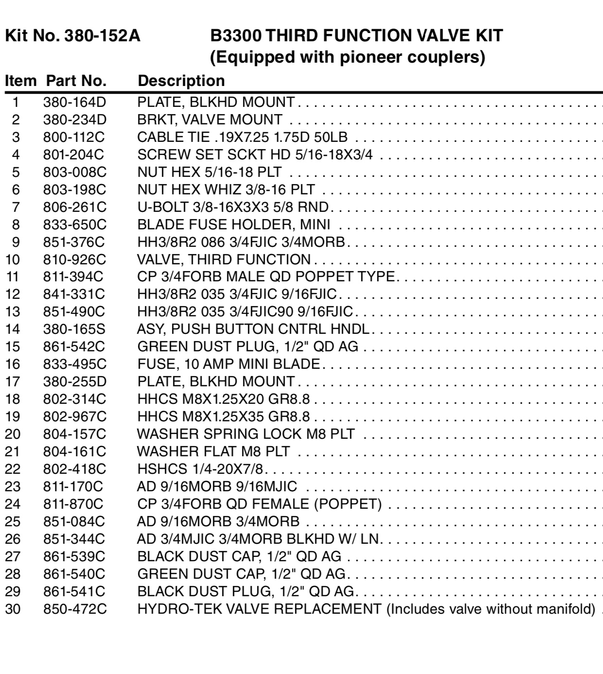

Hey everyone. I just received my new L2501 last night and I was expecting the Kubota/LandPride 3rd function valve to be installed. It showed up with a Hydro-tek branded valve. I can’t find any information for this valve online. Does anyone have any experience with this brand? Just curious how it holds up to other brands or if I received a lesser unit than I paid for.

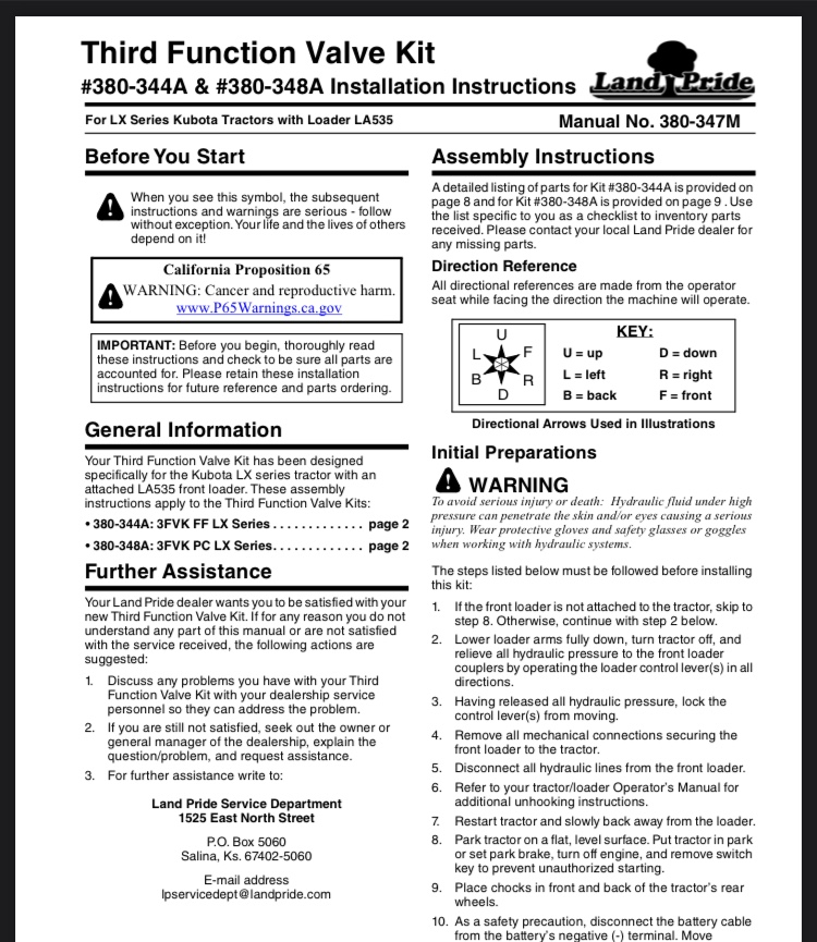

That seems to be the brand of valve listed in the install instructions, fwiw.
