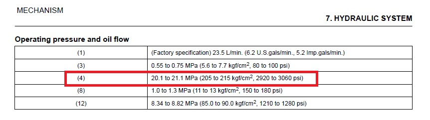

These from the BX23S Workshop Manual WSM showing 3060 psi maximum:

Turns out:
--Okay to take readings from the bypass valve
--Gauge is correct
--PSI ratings here are incorrect
Shout out: THANKS DAVE!

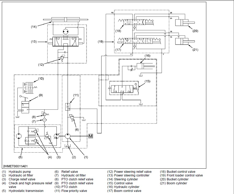

That pressure looks like it is within the HST transmission, not an external pressure.
Hydraulic pump (1) Has a pressure relief valve directly on its output. I assume that PRV valve is normally set to open at 1850 PSI or so.
Dave's insight is interesting, and maybe possible, do not know. Seems like system pressure would still be held at the setting of the PRV on the output of the hydraulic pump , unless something external is happening within lines that are isolated by closed control valves, which does not seem to be the case with your testing , but I honestly cannot say.
The drawing seems to show the HST pump as separate from the pump that drives the hydraulic cylinders.

@Henro is correct, those are your reliefs for the forward and reverse circuits in the HST.
The relief you are concerned with for the hydraulic pump is item 6

Today I learned the BX’s PTO clutch is engaged through a hydraulic circuit — items 8,9,10 on the schematic above. No wonder I’m not able to “feather” the engagement.
Thanks for posting that @Kubit
