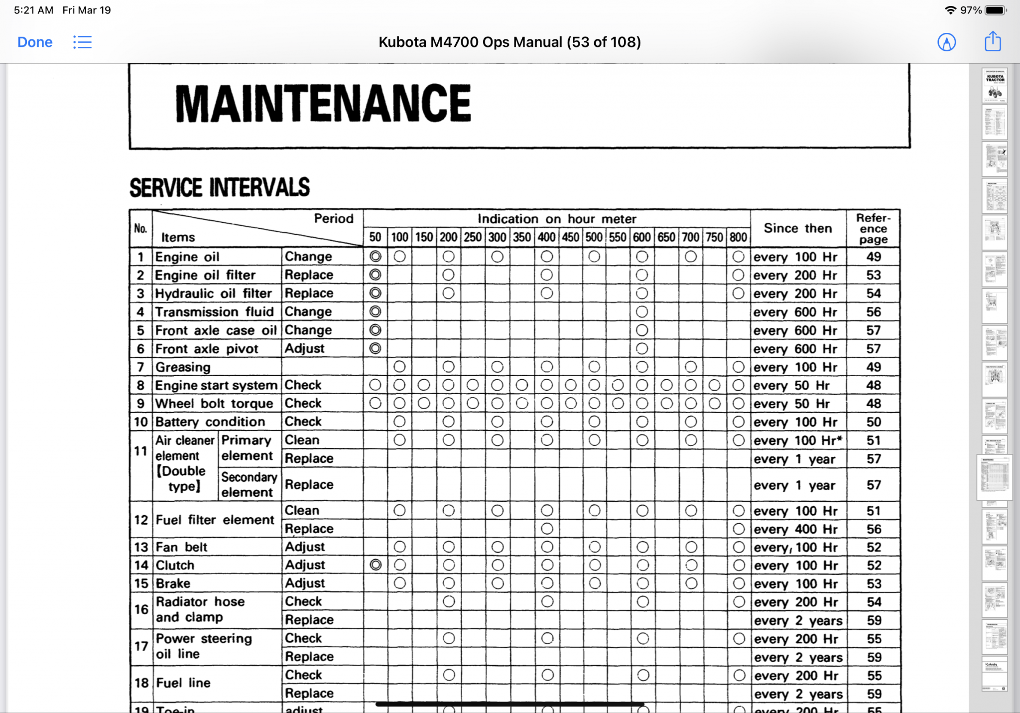

And each model machine has it’s own Maintenance Schedule which should be followed. For example, the M4700-M5400 series changes the HYD filter every 200 hours with no fluid change, and changes the fluid and filter at 600 hours. NO chronological filter or fluid change is required. That’s clearly different than other models. READ your manuals.
