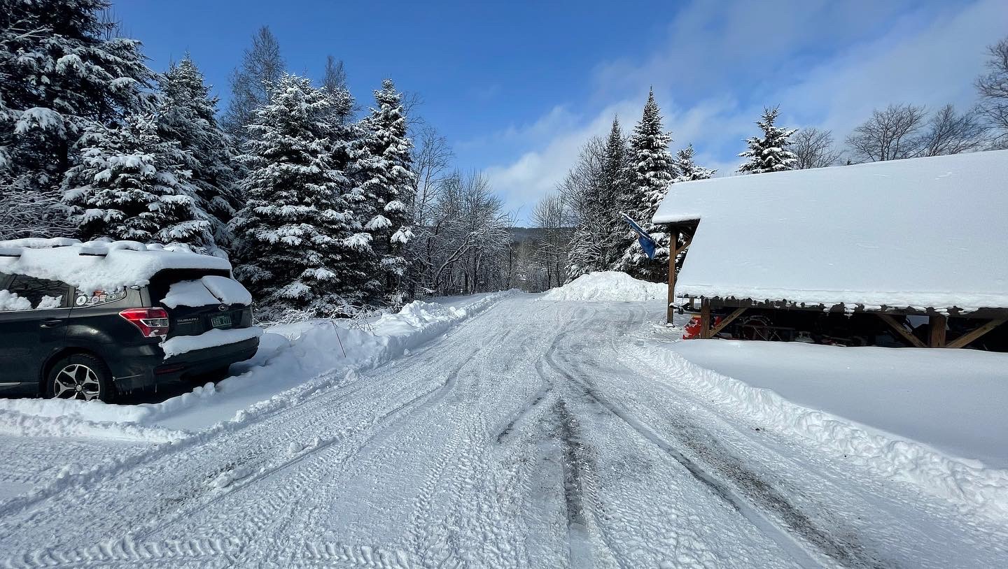

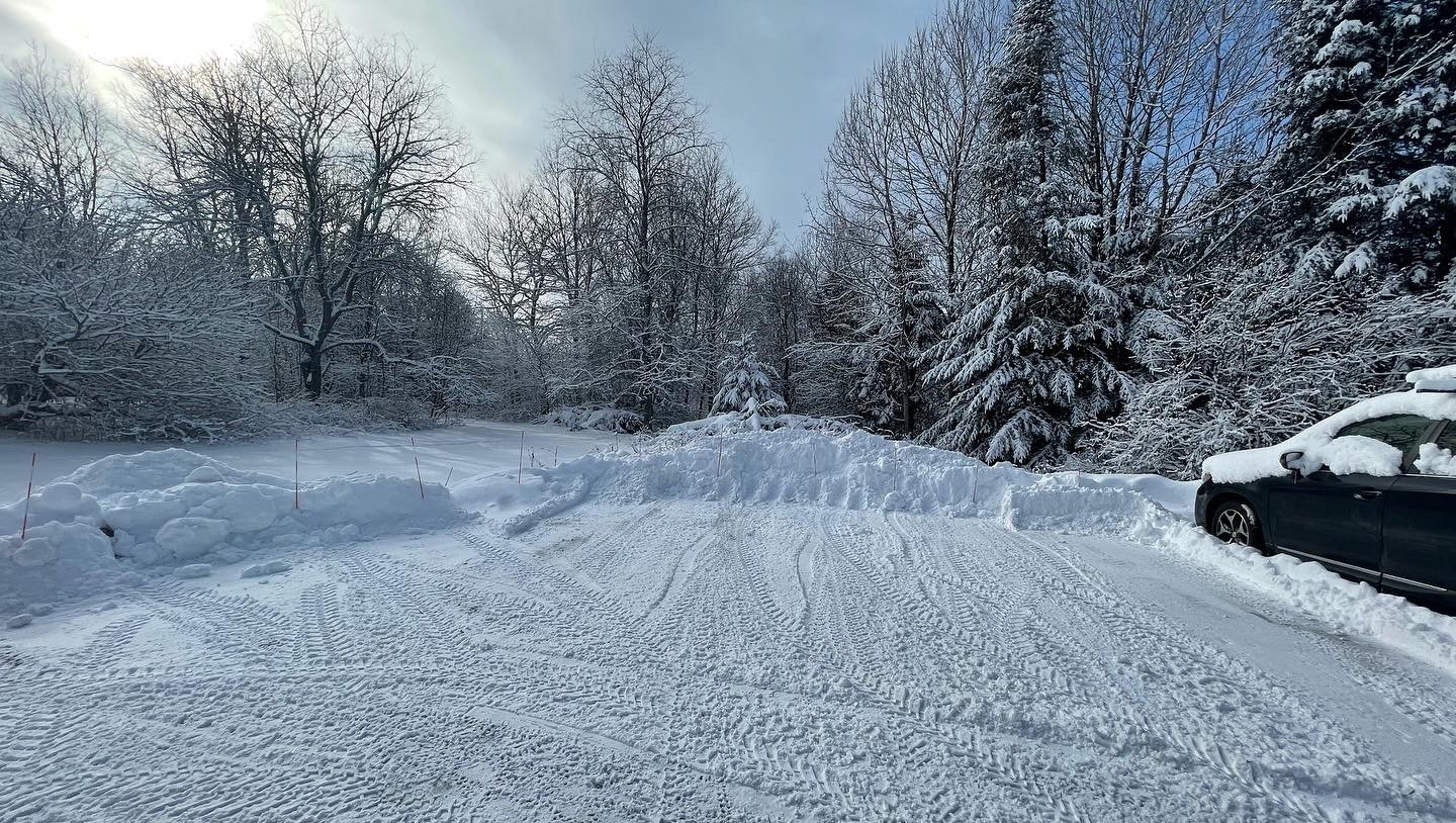

Photos of my recently cleaned driveway as a reward for reading all of that.
View attachment 73635 View attachment 73636

thanks for the photos, that looks slick.

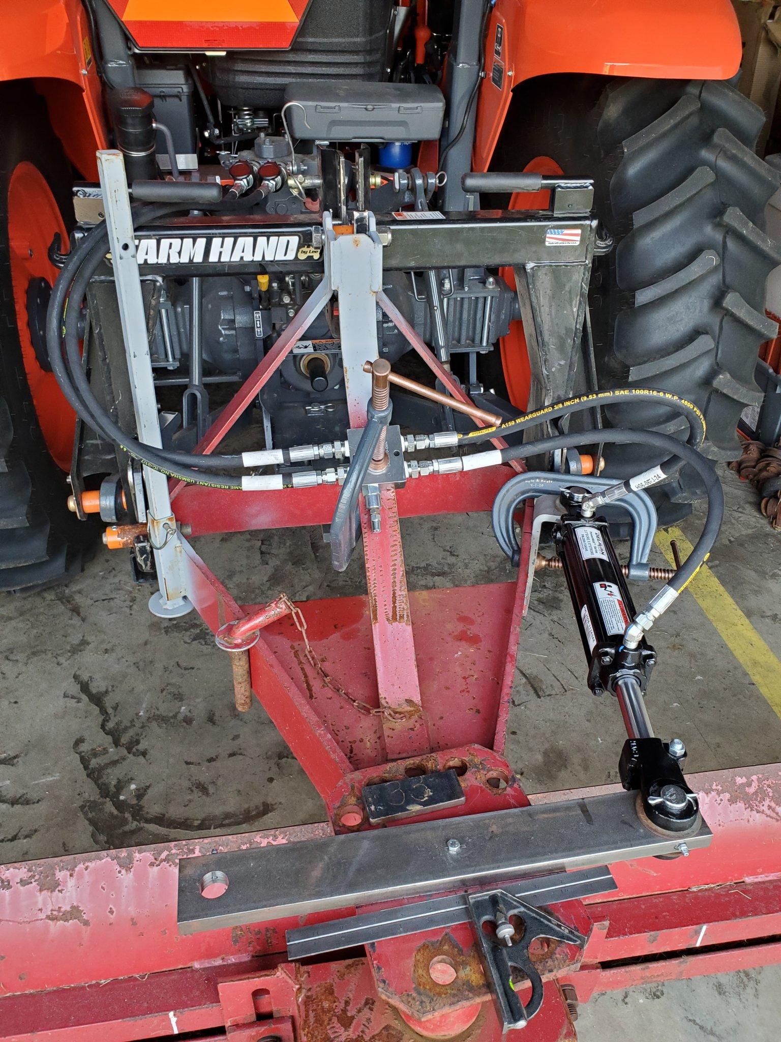

Look at Mcfarmall pictures. That bar lets you swing blade around 180 and attach cylinder to other side.
It might be worth considering if you you attach with a pin and don’t need to unbolt/ reattach while working. I typically use the blade in forward cutting positions to pull gravel from ditches or remove most of the snow, then reverse the blade to finish up.

Looks to be a single cotter pin on his. I'm sure something could be done where a lynch pin could secure it.

From those pics mcfarmall submitted, you could. You'd just have to manually disconnect the cylinder, rotate 180 and then reconnect.

You would just need a longer cylinder, but the longer the cylinder, the more likely it is that you will bend it by accident. the nice thing about hydraulic retrofit is that you could design it to be easily removable when you want it to be in manual mode.

Exactly. My 8" stroke will get me 45⁰ either way. 2 bolts and 2 pins and all the hydraulics come off for the summer to protect them from the elements and full manual operation is possible.
