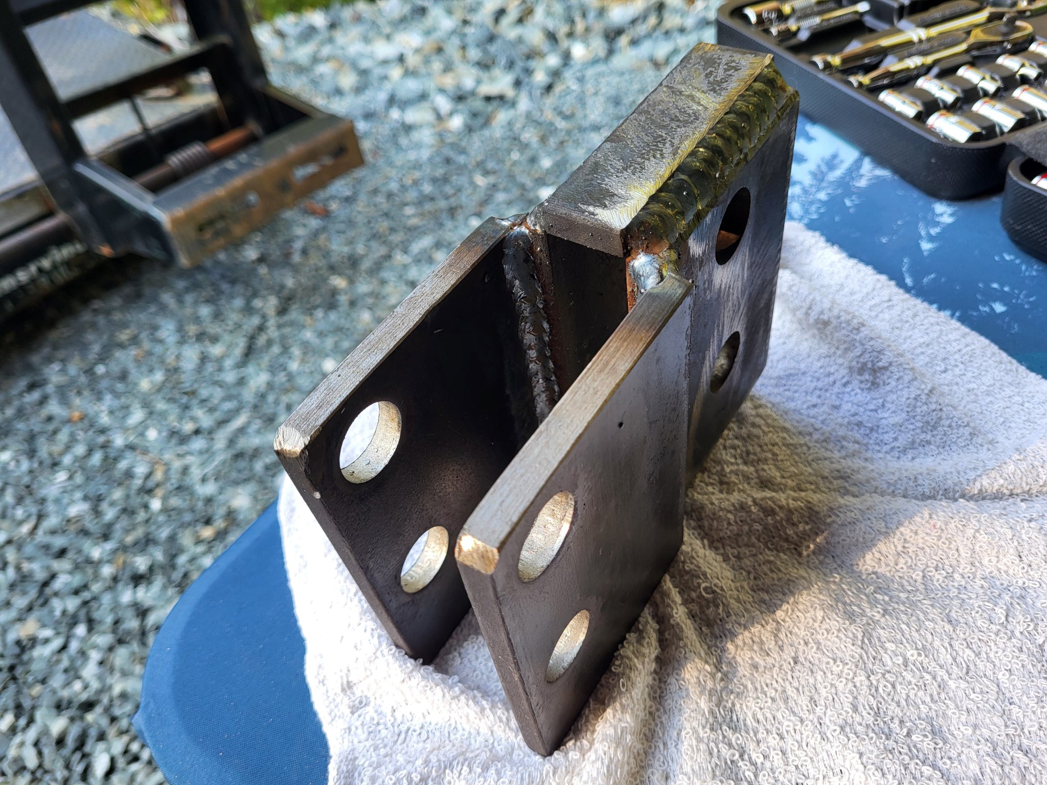

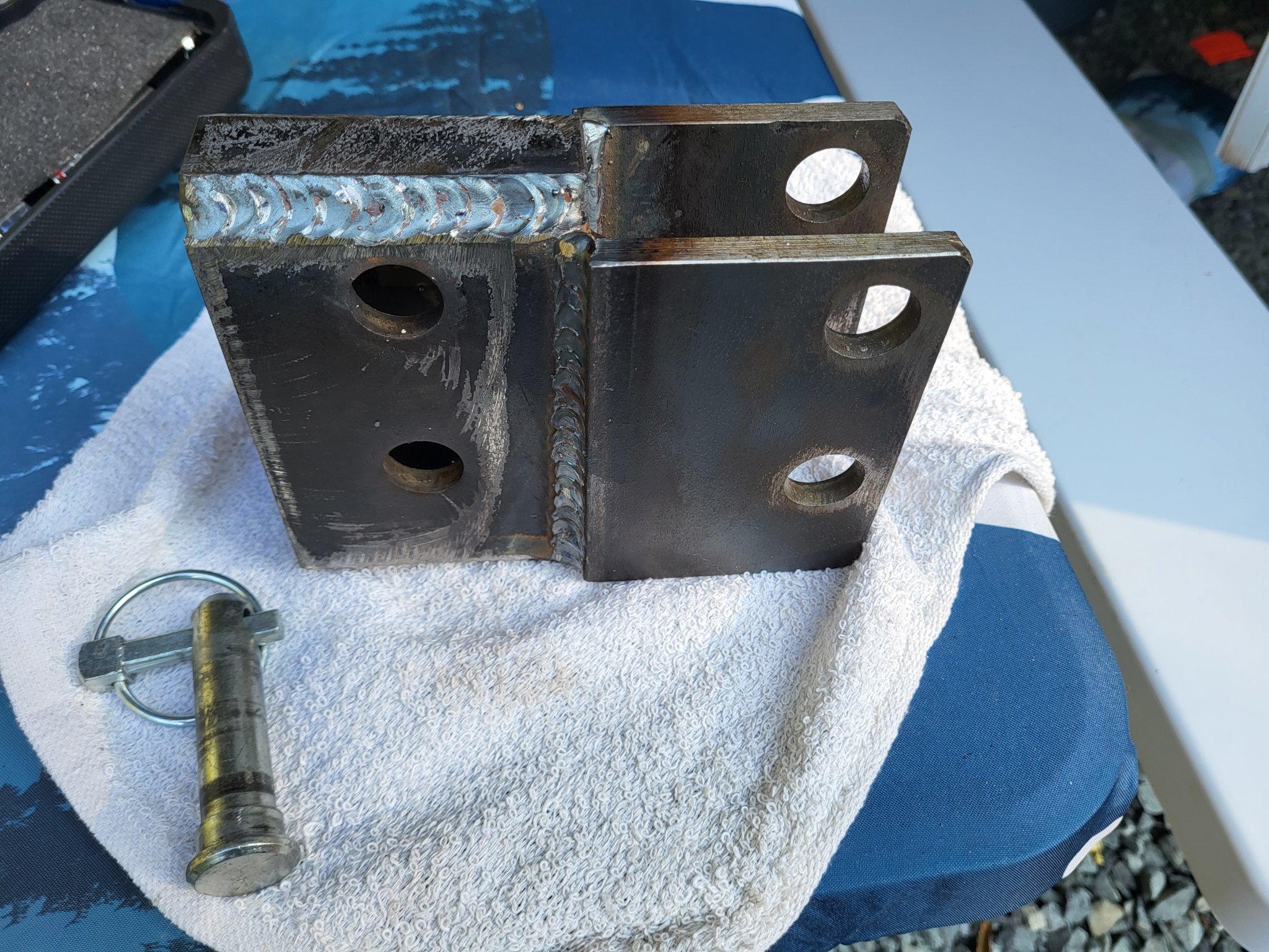

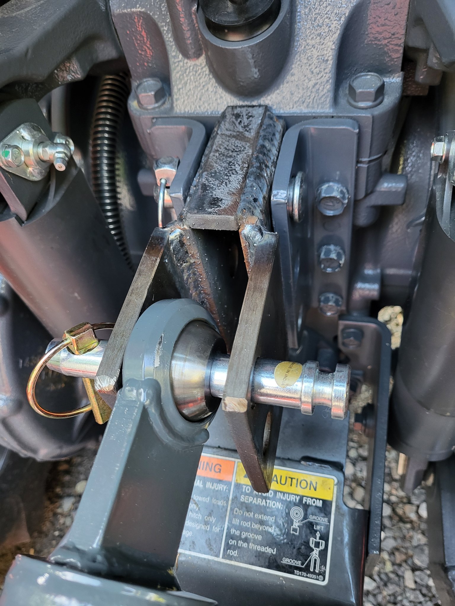

Eureka! Got the top link extension from the welder just in time for weekend. Great folks and quality work. Checked it out for fit and it does the trick. The top link now easily reaches my implements and allows me tip back the box blade. Need a few pins from the dealer but a success. Flap disced it and primed and painted this evening. Will let paint hard set for 24 hours amd re-install.
Also figured out I can just reach top link hydraulic control lever through the cab open rear window to get link adjusted to proper length for hookup. Finally coming all together. Thanks again all for advice.

Thanks Jyoutz. Tried TSC. This pin is not available there. It's the pin that holds the hydraulic top link to the tractor. It has to be short to fit between the lower 3pt lift cylinders and still make it through the bracket. The pins at TSC are too long. In fact, the parts department at dealer also sold me ones that are too long. I'll bring the needed pin with me today to dealership. Fortunately they are open today despite the holiday weekend.

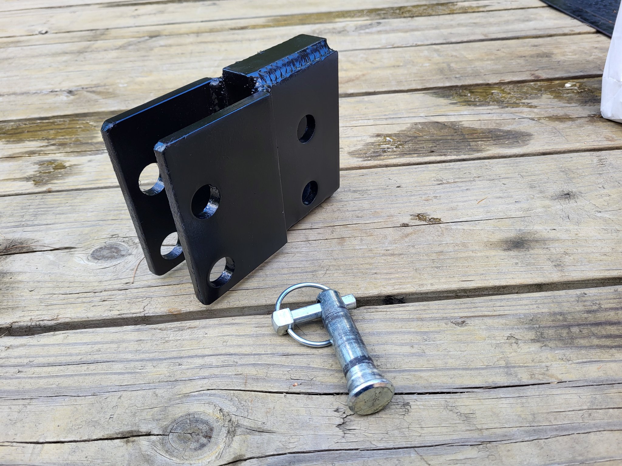

Top link extender done and installed. Now on to the next challenge. Always something interesting when it comes to running the tractor.
