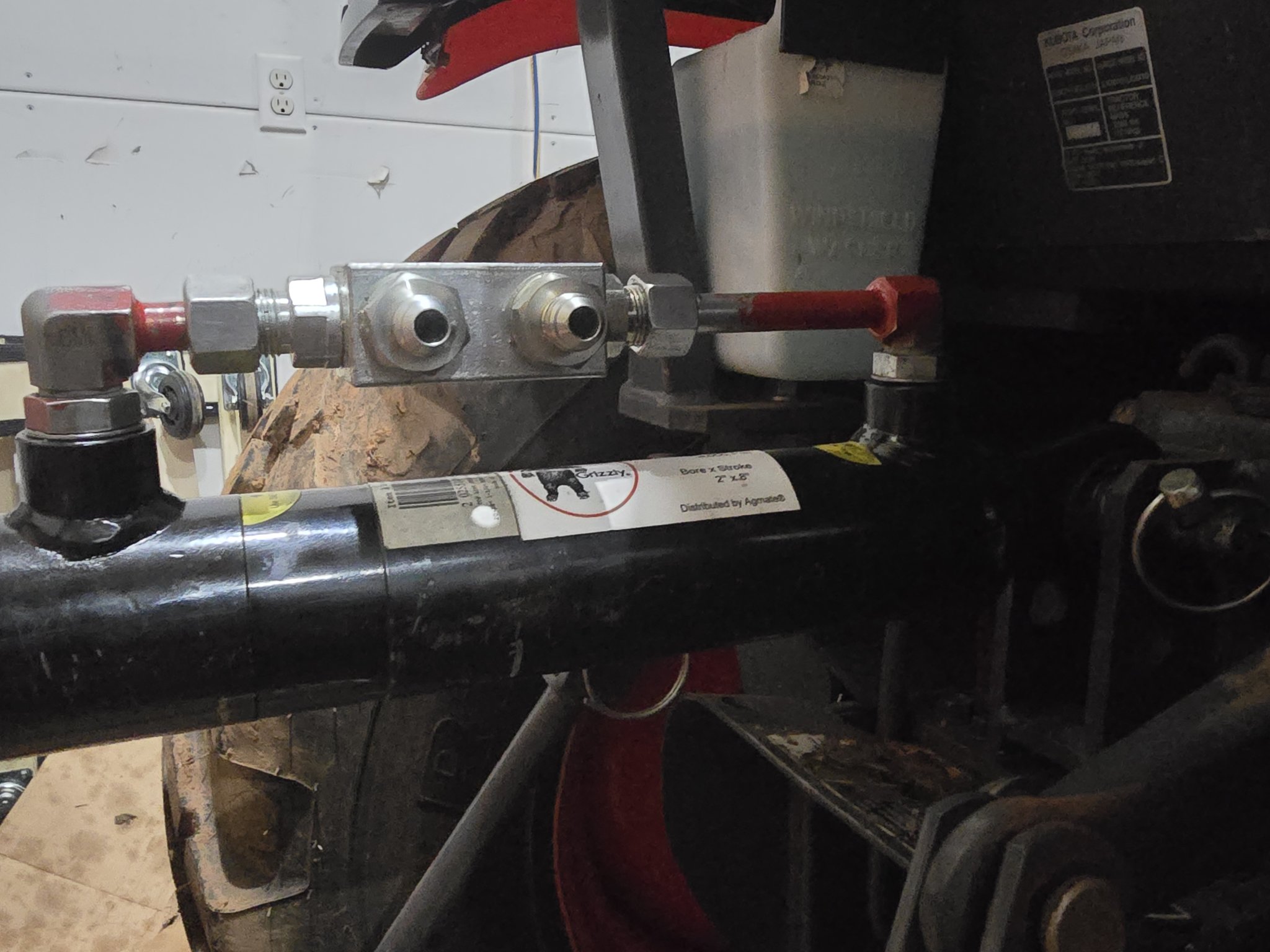

Here we go. I found a different valve in the Netherlands. $49 USD shipped to Canada and $23 Canadian duty. $52 at the hydraulic shop to make up some fittings. So all in all not bad on the cost.
I do need to get new hoses made. Both of mine were chaffed in a couple of spots on both hoses so I'm not going to use them. I'll get them made either Friday or Saturday, i wanted to test fit things first.

I will bite. What are the strange looking elbows screwed into the ports on the cylinders? I have never seen anything like them before.
The fittings that came with the kit were too small for the ports on the cylinder so he modified a pair by cutting the ends off and silver soldering the tubing into them.
