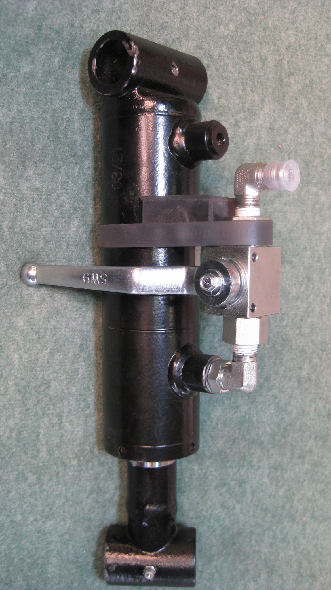

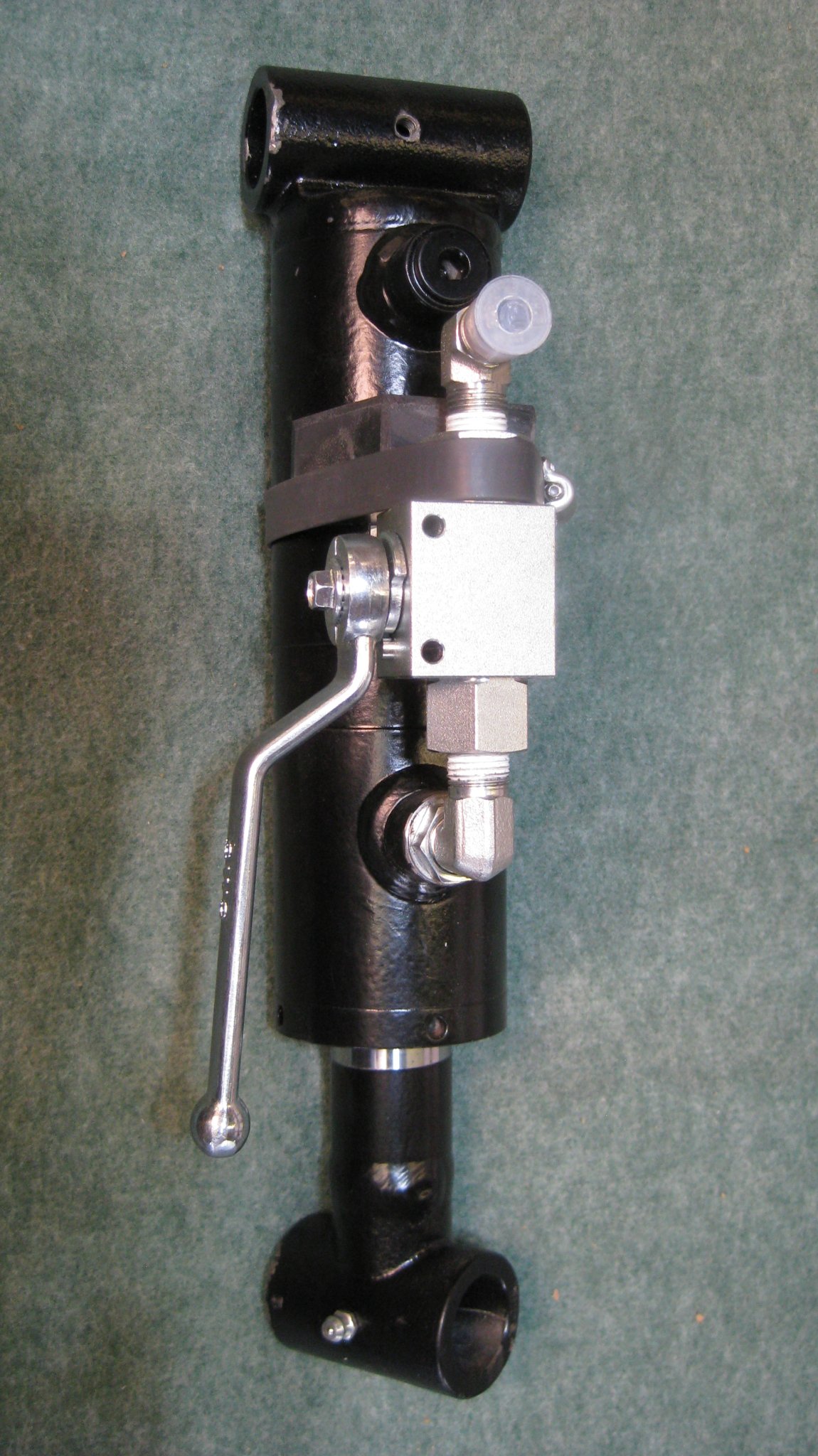

Depending on the circumstances, but some times a simple on-off hydraulic rated ball valve is a good solution and less money than the check valve.
