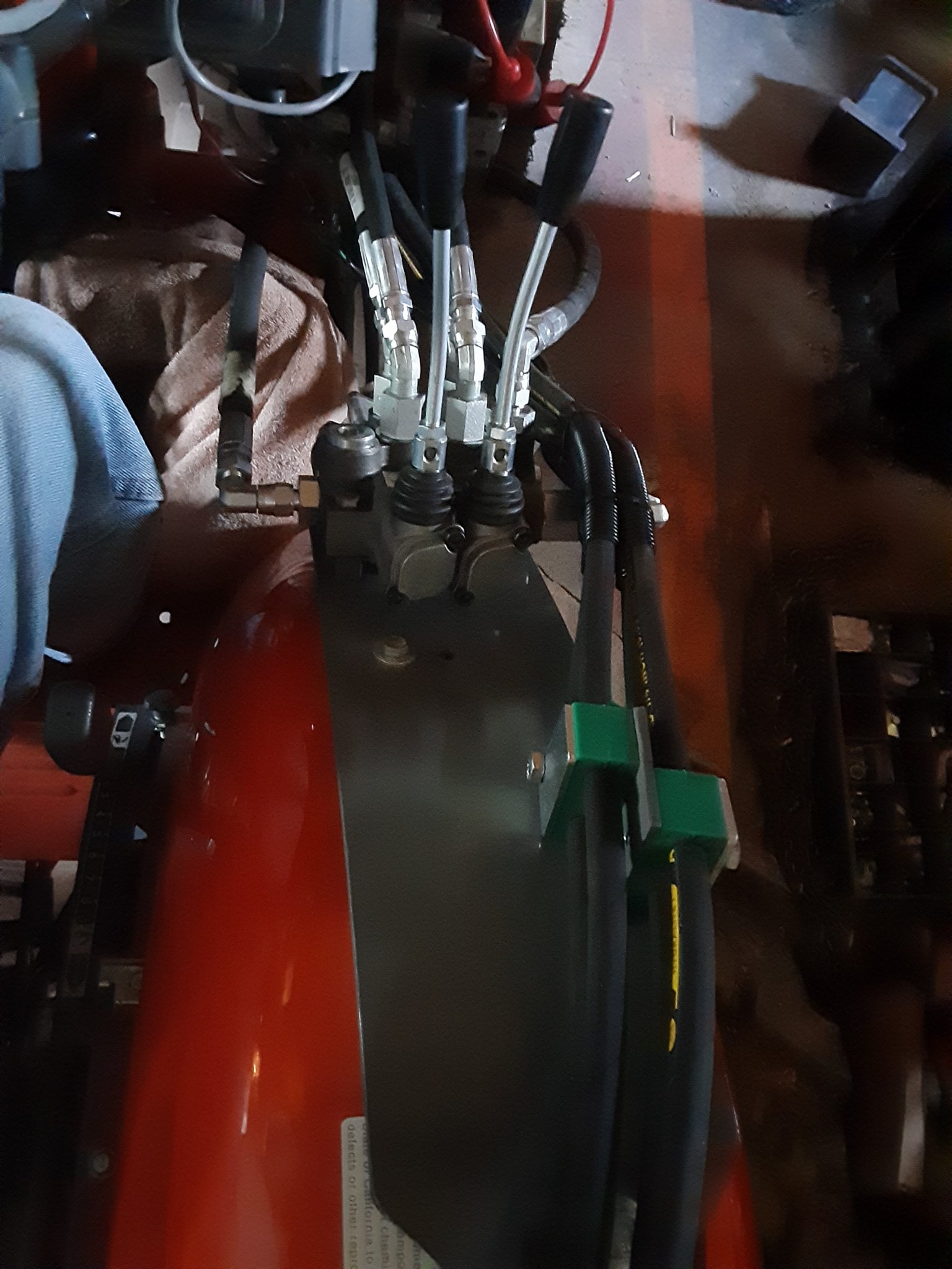

This is the levers but I put a slight bend in them so they are a little further apart.
I mounted my top and tilt valve here on the right fender where the handle holes are as i have a bad right shoulder.

Your valve is one of the ubiquitous P40 designs that are made by a lot of different companies. Summit has changed vendors at least once in the last few years.
Bucher is not that cheap.

I paid about $225 for the valve and another $20 or so for the power beyond.

A Bucher monoblock without float is just a bit more than that. A two work section sectional with float on both cylinders is about $400.
