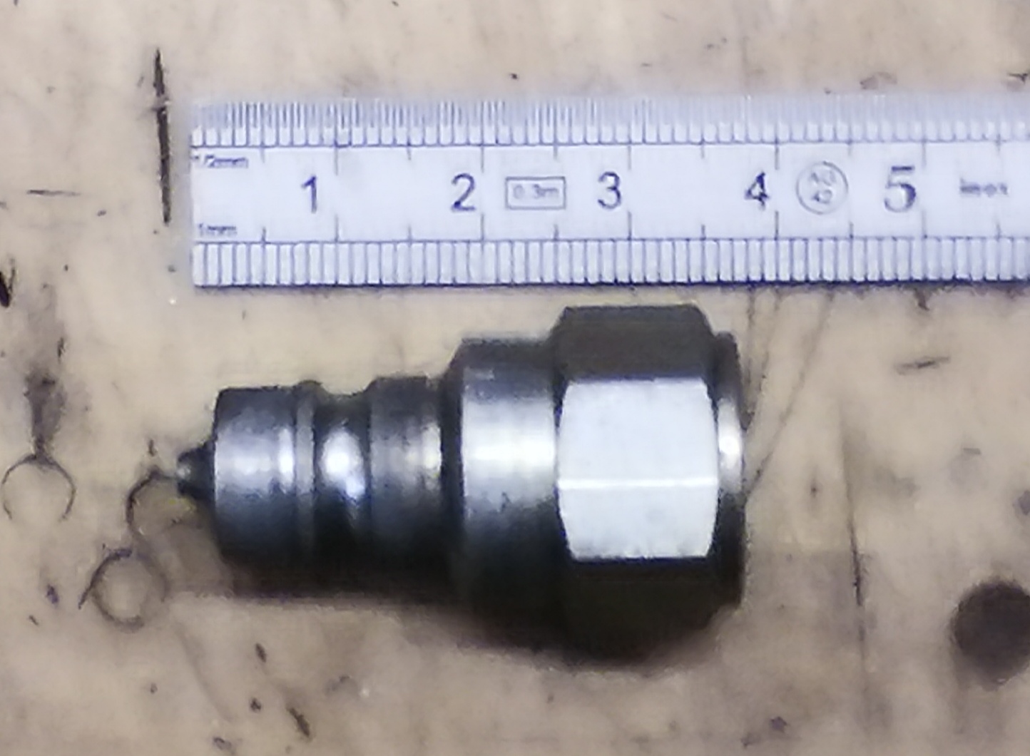

I am looking for the type of quick connect coupling that Kubota used on the small lawn tractors. This connection came from a G1900 grass collector hydraulic cylinder hose.
I believe it is a connection ISO7241-A size 1. The front diameter is 11.8mm, the diameter behind the ball lock groove is 12.8mm and the cylindrical length is 14.75mm.
Can anybody confirm / deny that this is an ISO7241-A connector?

Great, thank you, that helps.
From the diameter that leaves only ISO7241-1 A.
