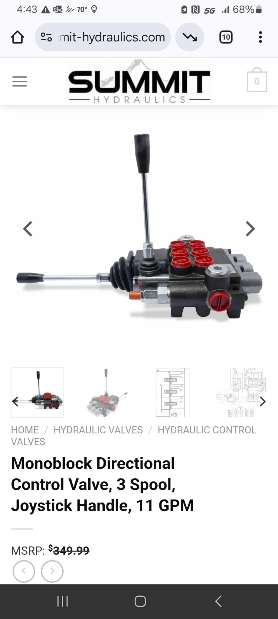

Now, it is certainly possible to design a FEL control bank with an additional spool valve for a grapple. And perhaps one is available via the aftermarket. But it costs more to add spools and Kubota has apparently opted to keep the base FEL price down. You pay more as a grapple consumer because you have to buy the kit if you add a grapple which is certainly more than the cost of adding another control to the existing bank at the factory. But those without a grapple pay a little less for the FEL alone.
Kubota is not keeping valve prices down. Just the opposite. This 3 spool loader valve sells for 1/5th the cost of a 2 spool Kubota valve.
