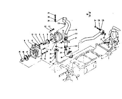

R Robinlarson New member Mar 3, 2019 1 0 0 Rock,mi usa Mar 3, 2019 #1 Can you please tell me the location of the Hydraulic Pump on our old Kubota? We believe it's behind the right rear axle, but can not find a parts schematic to confirm it. Thank you!
North Idaho Wolfman Moderator Staff member Lifetime Member Equipment L3450DT-GST, Woods FEL, B7100 HSD, FEL, 60" SB, 743 Bobcat with V2203, and more Jun 9, 2013 34,641 9,884 113 Sandpoint, ID Mar 3, 2019 #2 Negative, it's on the right side of the engine behind the injection pump. You can get all of the parts diagrams here: https://apps.kubotausa.com/illustrated-parts/ Attachments L245 Hydraulic system.JPG 29.8 KB Views: 4,714
