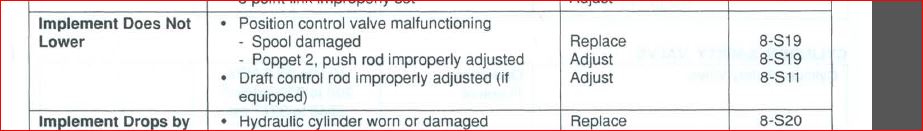

I have a 07 MX5000 with 168 hours on it. I got home this afternoon and wanted to grade my daughters drive but the rear hydraulics won't work. It will raise whatever bleed off occurs but will not go down at all. The FEL works fine. Any suggestions on where I should begin?

Is there a knob between your knees under the front of the seat?
It may be turned to slow or locked position. Turn toward fast position with the lift lever in the down position.

Sometimes you can't fix stupid. I had mistakenly turned the hydraulic control knob. Thanks so much for your help. This site has already paid benefits.
