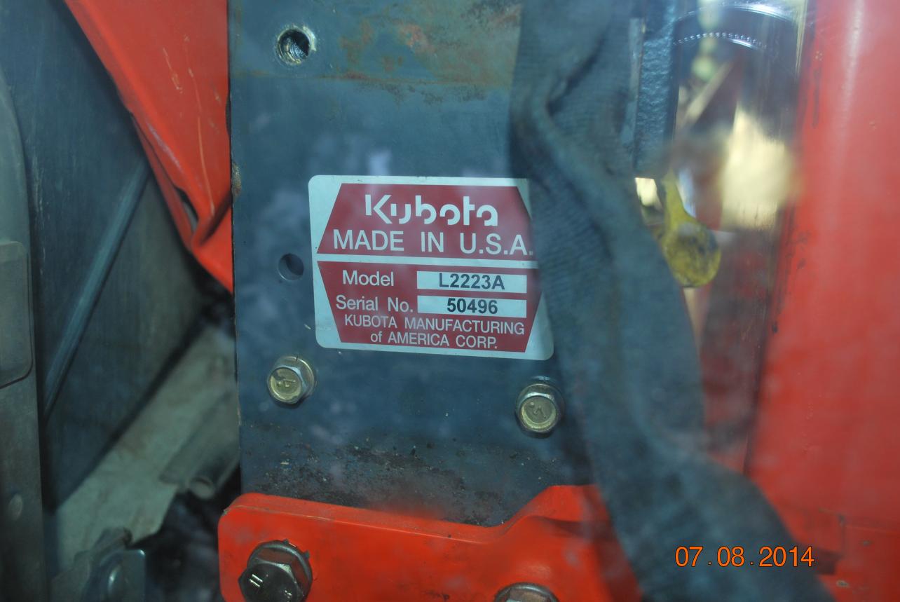

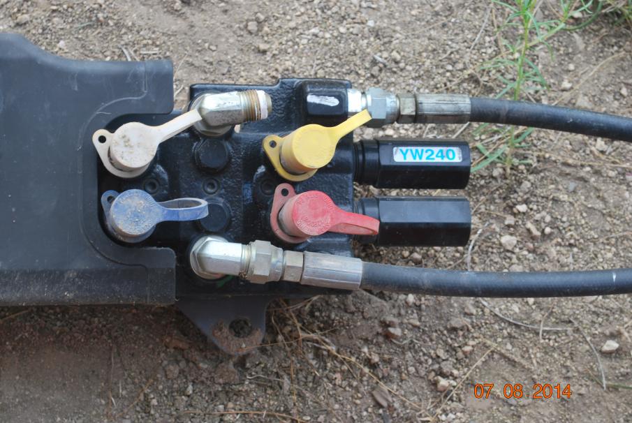

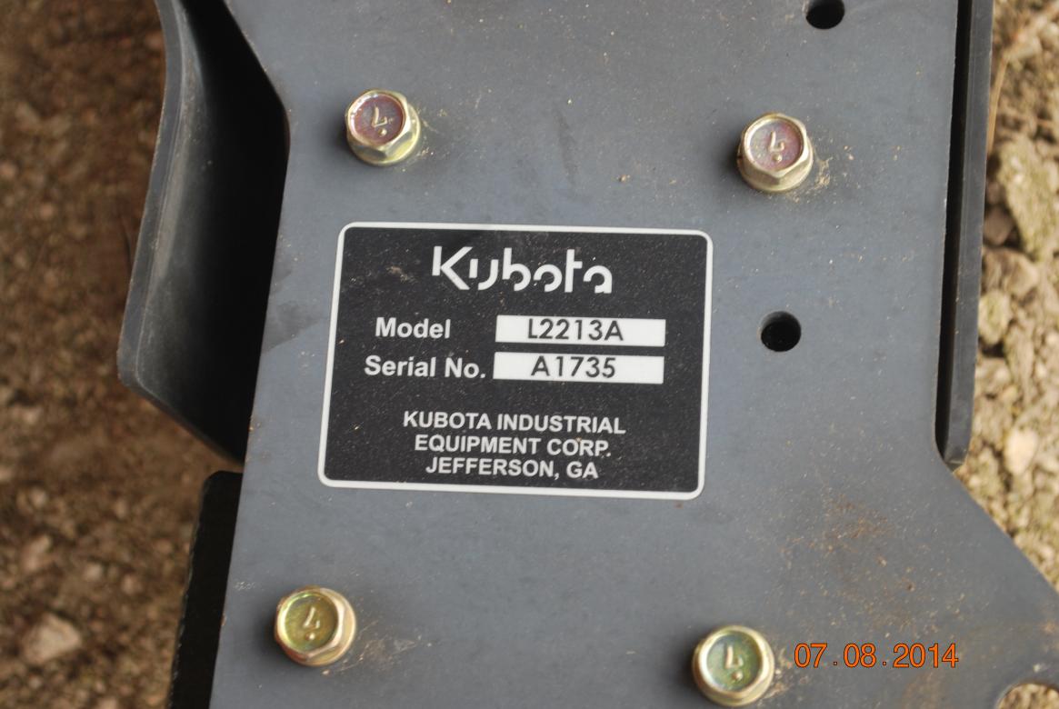

Hear are some pictures of what I have. When I went out to take these I noticed that I have two different models. The "red" block came with the tractor and snow blower when I bought it new in 2004. The other block came with the loader and is the type installed on tractors without a cab. My tractor has the factory cab. The way the QD's are attached in these photos everything works correct except when I push the stick forward the bucket goes up. The only way the bucket can be lowered is by pushing the stick into the float position. If I connect the QD's color to color(red to red, etc.) Moving the stick side to side the bucket goes up and down and moving the stick front to back the bucket dumps and rolls.
33,399
8,705

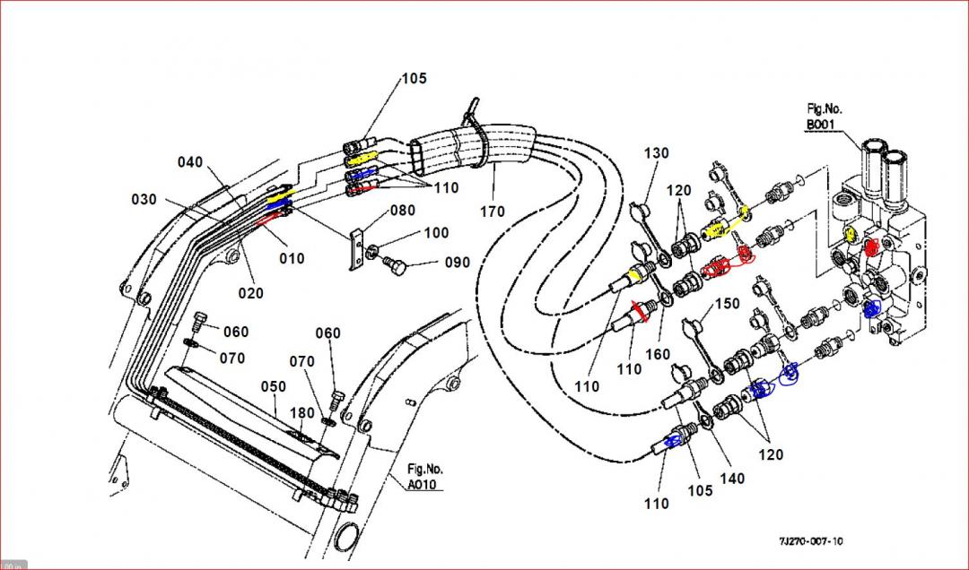

Ok the valve that is not on the tractor right now is a new style L2213A Valve.
The Valve on the tractor is a L2223A Valve.
If you notice VIA the color caps they are the exact opposite hook up.
What you need to make sure of is that the feed lines are right as one valve is the opposite of the other.
ALSO before you get too far swap the QC line so the colors match back on the loader valve.
On my print don't worry about colors not matching yours, just match locations and routing.
On this routing there is only a difference in the location of the 2 front connections, each valve (L2213A compared to the L2223A) is the opposite and the rear connection is the same for both.
