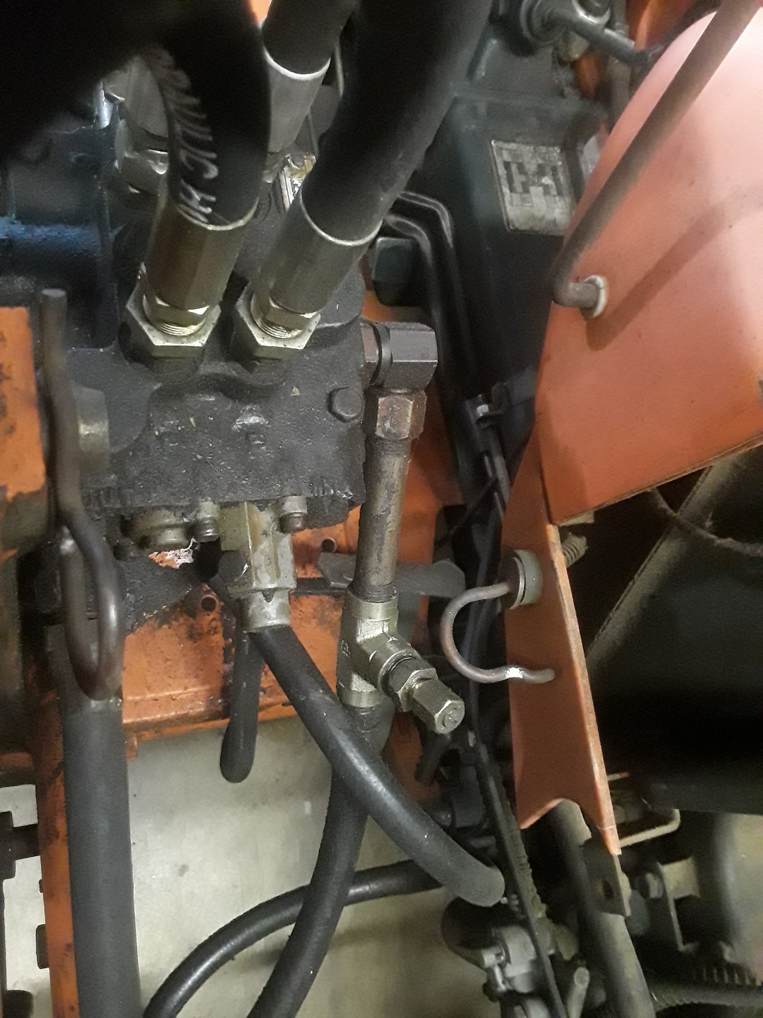

On what are you basing that assessment? Hydraulic pressure gauges are inexpensive and easy to install in the pump circuit. You can install a JIC tee on the inlet to your loader valve and use it as a test point. Keep it capped when the gauge is not connected. To get a pump presure reading just roll the bucket back hand hold it there with the control lever. That will block the pump flow and deadhead it against the system relief.

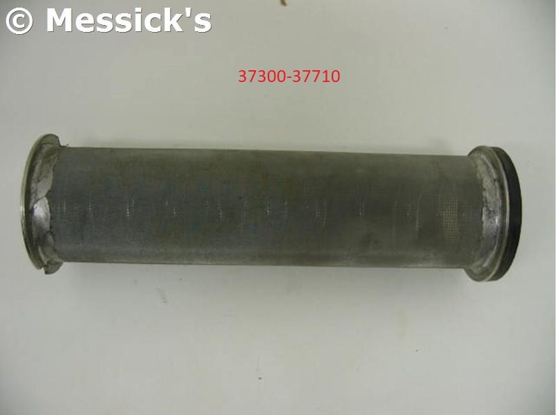

When was the last time you checked and cleaned your hydraulic filter screen?
Recently a number of problems posted on the forum have been traced back to dirty screens.
