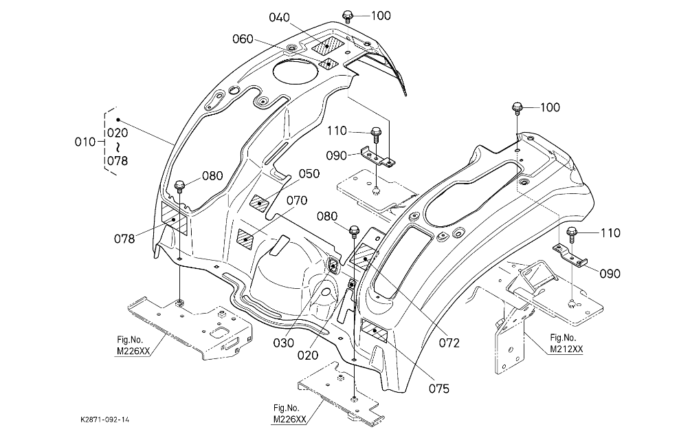

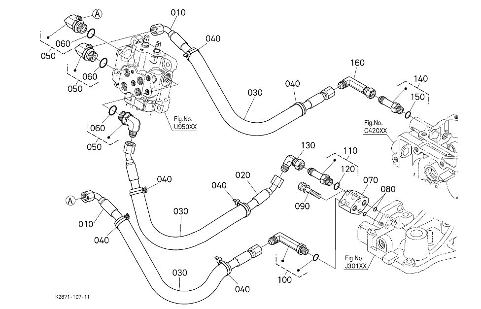

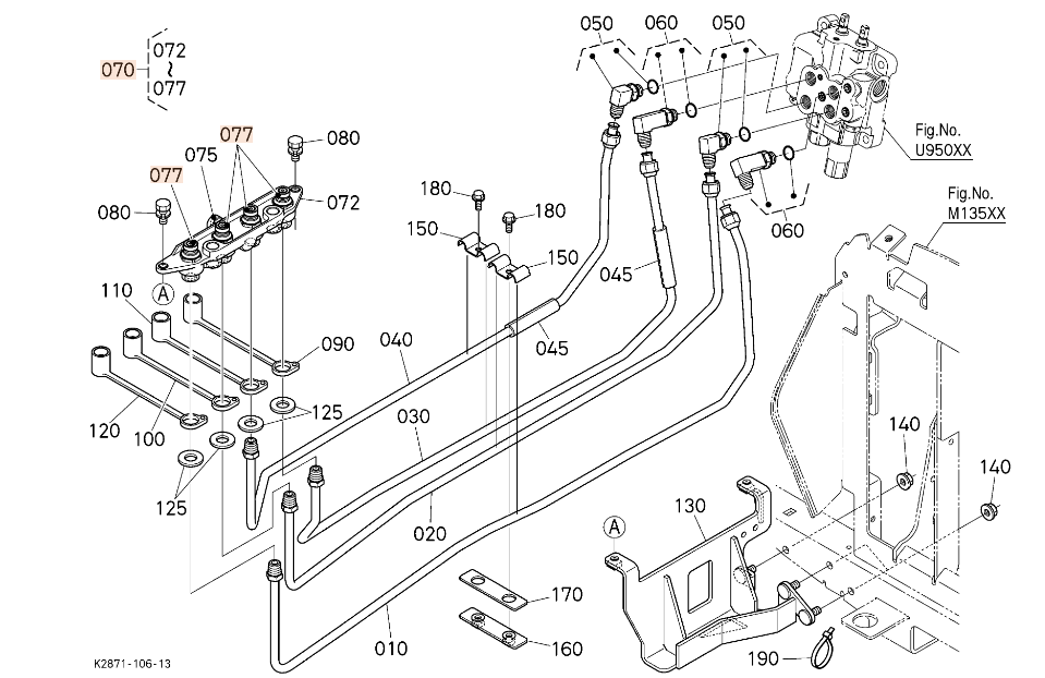

You have 7 hydraulic lines at the valve - three hoses with SAE/JIC fittings and four steel lines with banjo fittings Any one or more of them could be leaking. Its buried up under the fender pretty good - taking the wheel off might give you a better view. I would think worst case the fender may have to come off to access some/all of the fittings. Hopefully not - that looks like its a one piece assembly.

Thanks for the nice diagram, it is very tight in there and that's a pile of fittings to try and find a leak. Tractor has less that 100hrs on it, bit frustrating but this looks like it might be out of my realm.
