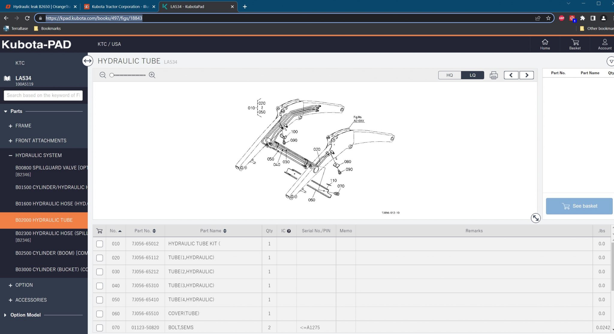

Anybody know the part # for the 16" hydraulic hose on the LA534 loader. The only number I could see is 75532 stamped on the metal crimp, when I plugged that number in I got all kinds of results.

Took the hose off, 7J999-99130, and it has cracks in the middle where it bends. No ware or rub marks, must have just deteriorated over 5 years time. Other hoses looks good. No place in our town to get this hose made so will make the trek to our Kubota dealer, they make them on site. May get an extra if they are not too costly.
