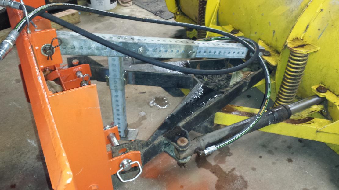

I just bought two 3/8 inch by 6 foot hydraulic hoses for a QA snow plow I built. I compared prices and materials at NAPA, Tractor Supply, Northern Tool and O’Reilly. TS and NT did not have the hoses with different NPT ends. I ended up calling a local construction company and asked them if they had the capability to make custom hydraulic hoses or if they knew who did locally beyond the auto parts stores.
They told me they could and would make whatever hose in any configuration I wanted, if they did not have the fittings I needed they would order them and have them in 24 hours. I told them the hose end specs, length and a minimum of 3000 psi. I also explained my application, estimated bend radius and the needed to be flexible so it may limit how many hose wires. I was given a price for the two identical hoses in 5000 psi that was less than TS, and NT in a higher pressure rating and half the price of NAPA, configured as I need them. I told the guy I would pick them up in a couple of days, he asked where I was coming from and told me if I wanted them now they would be ready when I got there, about 20 minutes.
Excellent service, quality and price, so give the local heavy equipment construction company a call they may surprise you, a lot of them have the materials and equipment on hand since they cannot wait days to get down equipment running.
