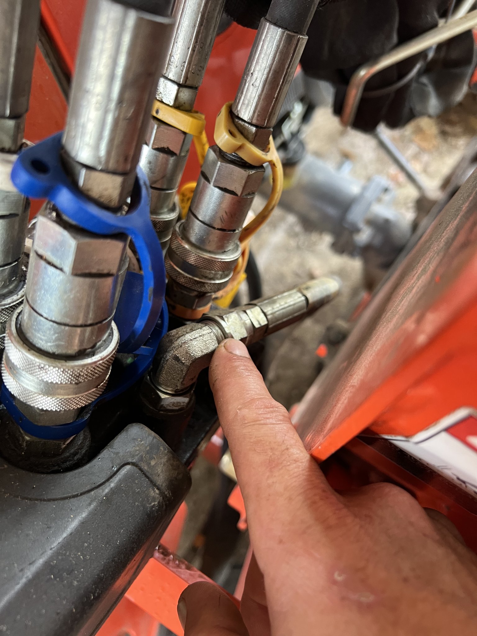

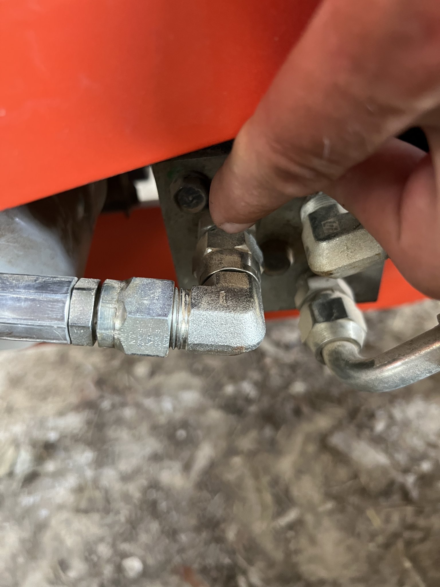

Can’t find the specs on kubota, but I’ll give it a shot…(my tractor doesn’t have 3rd function or rear remotes).
the supply hose from the power beyond port on loader valve to rear connector is roughly 64”. It goes to a bracket with a short tube on it that mounts to the bracket on subframe.
I blew the factory return hose (actually pinched in 3pt lift arms), replaced it with a 72” hose.
Factory hose had a 90 degree fitting at the block under the right side floor board, I just used adapter with new hose.
The return hose is a little longer then factory and I added the 45 at the quick connect (as recommended by other members here) which clears the 3pt arms better.
Hoses are 3/8, fittings on tractor are JIC 8, and it’s 1/2” quick connects on the tractor and hoe.
hope this helps! If you need any more just ask!
