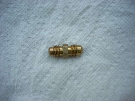

When I replaced my hose:
I used a connector....
I pulled the old hose out and the new hose in.

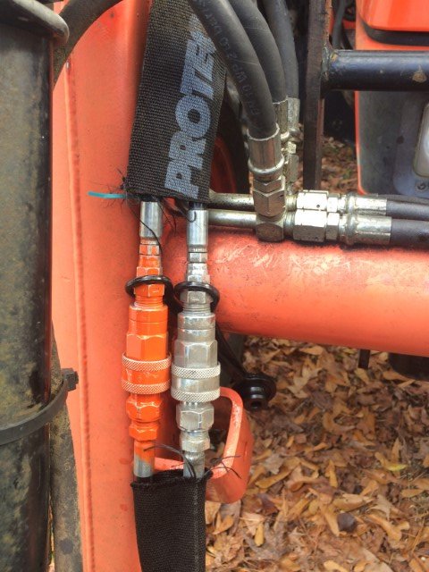

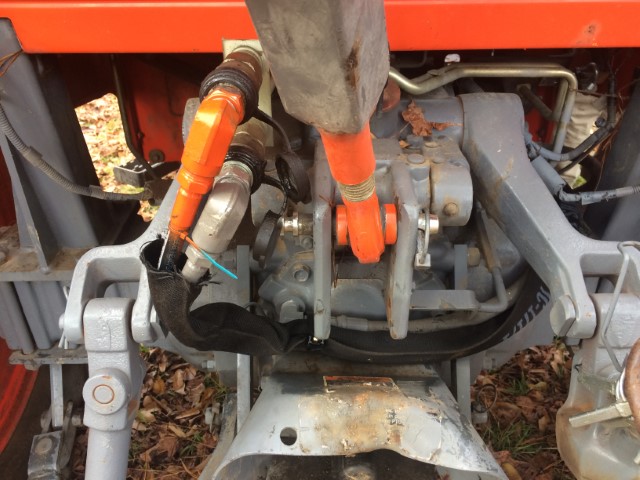

When I added hoses to my FEL thumb:
I put both hoses in a new sleeve....
And zip tied them to the existing hose bundle making a very neat installation.
