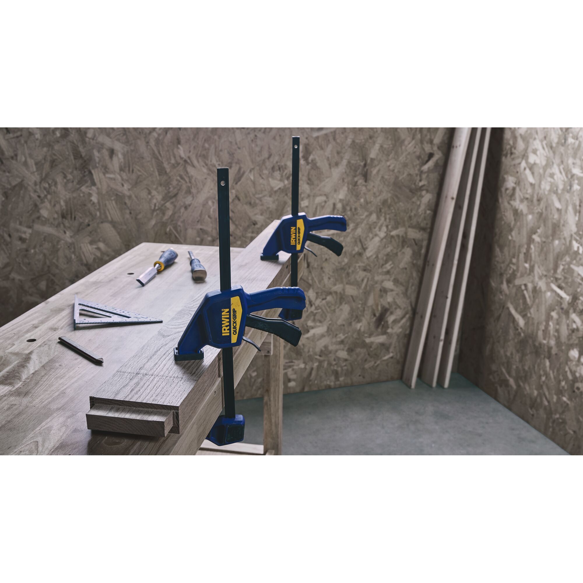

See these jaws for an Irwin clamp (which you have to buy also).
There is some company that sells them already converted but I don’t know how to find them.
The clamp is this kind of thing
