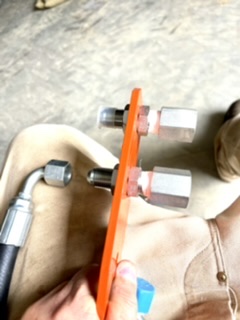

I am a novice tractor owner and just started my install of a 3rd function kit on a M7060. I decided to mount all of the equipment before making the hose connections. Kinda of nervous about screwing the connections up since I only have the loader manual diagrams as a guide.
My 1st question is, what connections get Teflon tape? Using this photo as a reference, it seems that beveled fittings do not get taped, is that correct?

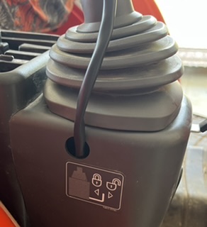

2nd question is - Is there any reason that you shouldn’t thread the kit on/off switch through the plugged hole on the side of the stick console?

I don't use Teflon tape at all on any hydraulics. I use only pipe dope, and very sparingly on the threads only when necessary. Many of the fittings seal by pressure and not the threads, so no forms of sealant are necessary. Use a paint marking stick to identify both ends of the hoses, so you know exactly where each one is going and coming from. You can use letters, numbers, or similar marks that will mean something to you, but not necessarily anyone else. I have about 5 or 6 different color sticks that I use, just like Kubota does on assembly.

Only NPT (National Pipe Thread) gets sealant and be careful not to get any into the fluid stream.
In my photo is the capped side on the right with Teflon tape NPT then?

Capped? What I see is a bulkhead union with a JIC male and a hex of unknown type. My guess based on the application is the hex is a female NPTF fitting intended for use with a hose with male NPTF ends. That connection would require a thread sealant. If it is in fact a cap the bulkhead fitting is likely another male JIC fitting and no sealant is needed.

NPT is usually used on rubber hose ends and they usually join the flat-faced couplers to the rubber hose.
