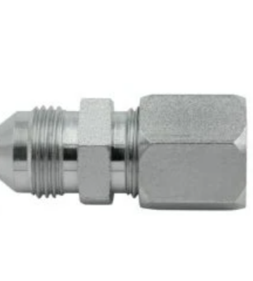

If it's too inconvenient to remove and replace and the end is accessible, hydraulic compression fittings are available. You'll need to know the line size (metric or imperial?) and hose end type and size.

That’s the exact fitting that came off. I’ll look into compression fittings. Thank you for the info!

Last spring I did some work on a Ford skid loader that had a small fire. SOme of the hydraulic hardlines had gotten hot enough it melted the braze for the ferrel. I used those compression fitttings to repair. Cut the original line square, cleaned it up with some emery paper and put the new fitting on. They need to be super tight- 3000 psi system on that one.
