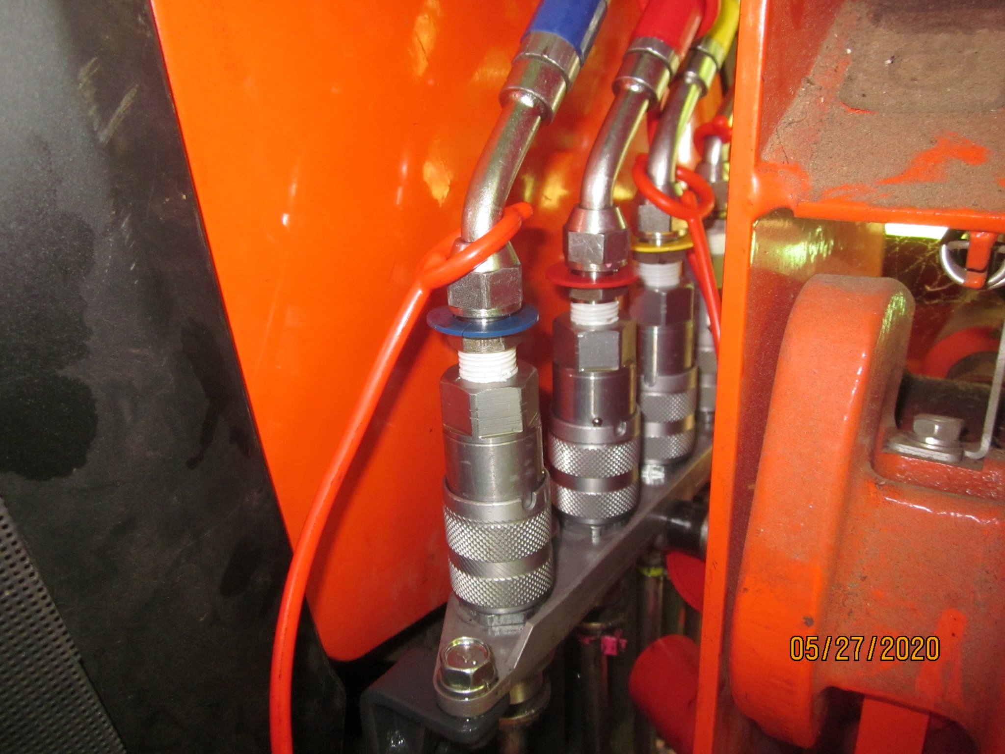

The fittings on the BX2380 are not Pioneer style fittings. They are flat face connectors. My quick coupler leaked. Had it fixed under warranty. Began leaking again. (Yes, I always kept it very clean!) Replaced the female side (loader side) of the coupler with 4, 1/4 NPT flush face Summit hydraulic couplers and 4, 3/8 JIC to 1/4 NPT adapters. Hasn't leaked a drop since. IMG_2626.JPG

The fittings on the BX2380 are not Pioneer style fittings. They are flat face connectors. My quick coupler leaked. Had it fixed under warranty. Began leaking again. (Yes, I always kept it very clean!) Replaced the female side (loader side) of the coupler with 4, 1/4 NPT flush face Summit hydraulic couplers and 4, 3/8 JIC to 1/4 NPT adapters. Hasn't leaked a drop since. View attachment 44842
So I did exactly this but all my fittings are leaking. I used thread dope, stilll can’t get it to stop leaking. Any suggestions?

It’s hard to tell. I think it’s the tapered joint but I’m not 100% on that. Everything has oil on it after I run it for a few minutes.
12,779
7,262
If you have matching fittings and and use a suitable sealant a tapered pipe joint will be pressure tight. If its not pressure tight you have miss-matched fittings, poor quality fittings (unlikely with steel hydrauluc fittings), or improper assembly.
