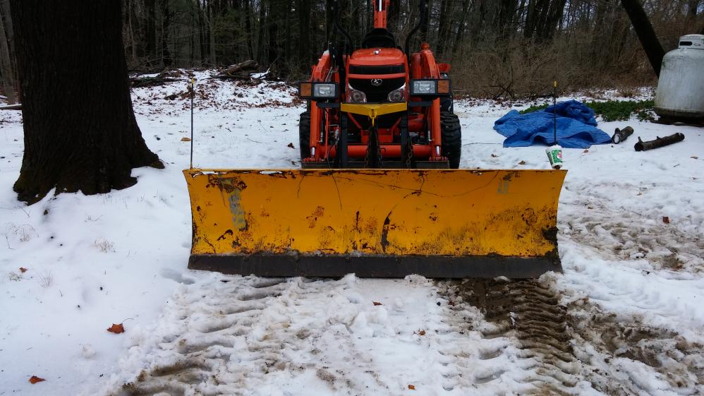

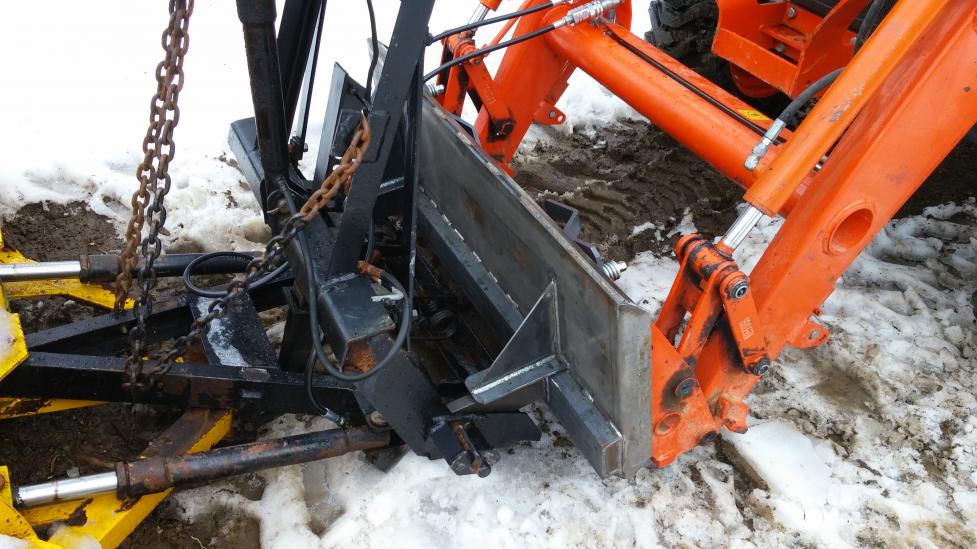

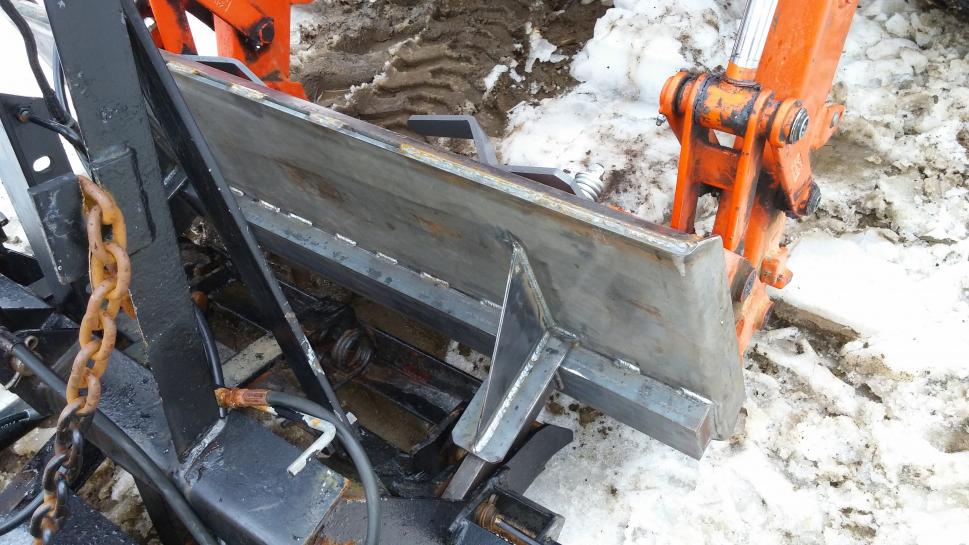

Thanks all, here is a postmortem of the hookup for this plow:
- Picked up some new hoses with the correct hydraulic fittings
- Welded on some braces and pins to connect to the 1/4" quick attach plate onto the plow.
Attached it up today, and tested on some of the small amount of snow we had a couple of days ago. Hydraulic works as expected.
Please find attached some pics, in-case anyone is interested in the setup:
