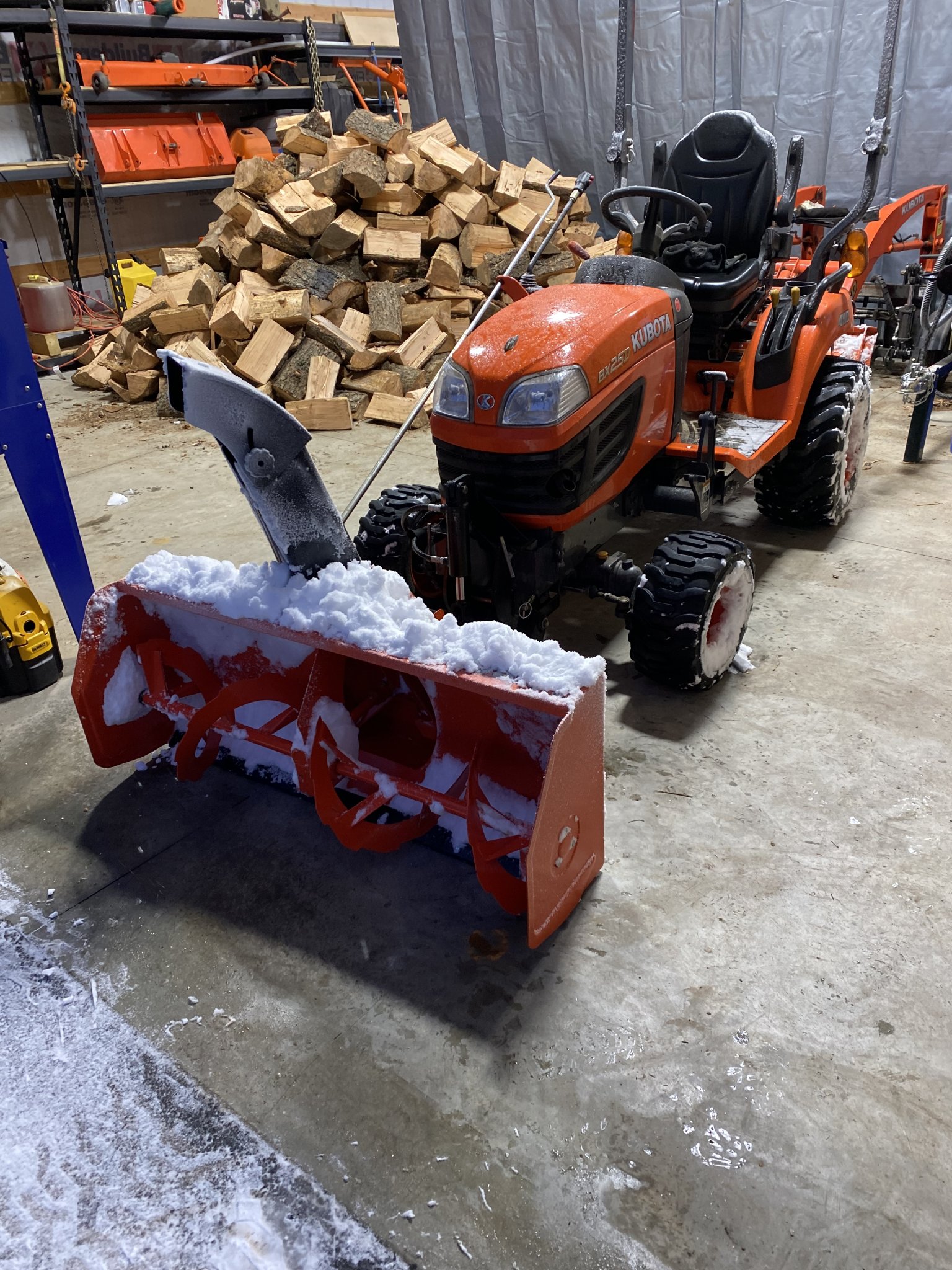

Haven’t been here in a while, but today while blowing snow off driveway, I realized the crank handle for rotating the chute, SUCKS . I just don’t like it. I would much rather move the stick to left or right. Is there a post here that has pics of hydraulic motor? P/N, Fabrication is no problem. No electric. Hydraulic only. 6C7A9800-1A19-45A0-8D1F-375C71E58D31.jpeg

I can’t help with that as I have a 3pt not sure it would be the same. I do however want to say I’m envious of your ability to rack and stack your implements!
Thanks. Yes, it’s normally all on shelves. Grapple, blade, and blower too. Wood pile got in the way of putting everything where they belong.

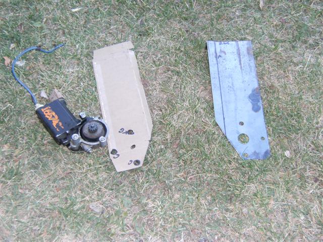

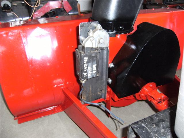

Here's another one that I did that might be of interest to you. Used a window motor coupled to the rotator shaft, using a 3/8" universal joint and a 12 point socket that fit nice on the gear of the motor. A piece of steel to mount the motor on and bolt it to the blowers frame. Worked excellent.
That is a 1960's Delco window motor, and a very powerful motor. Do you have any others that you could spare? thank Dusty
