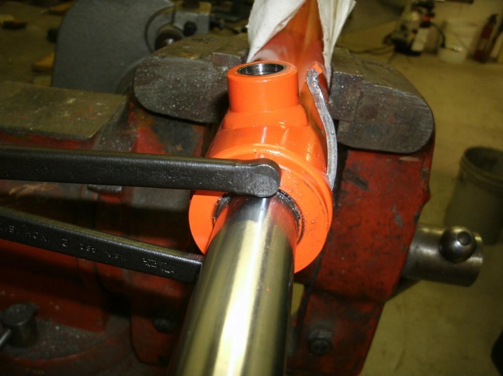

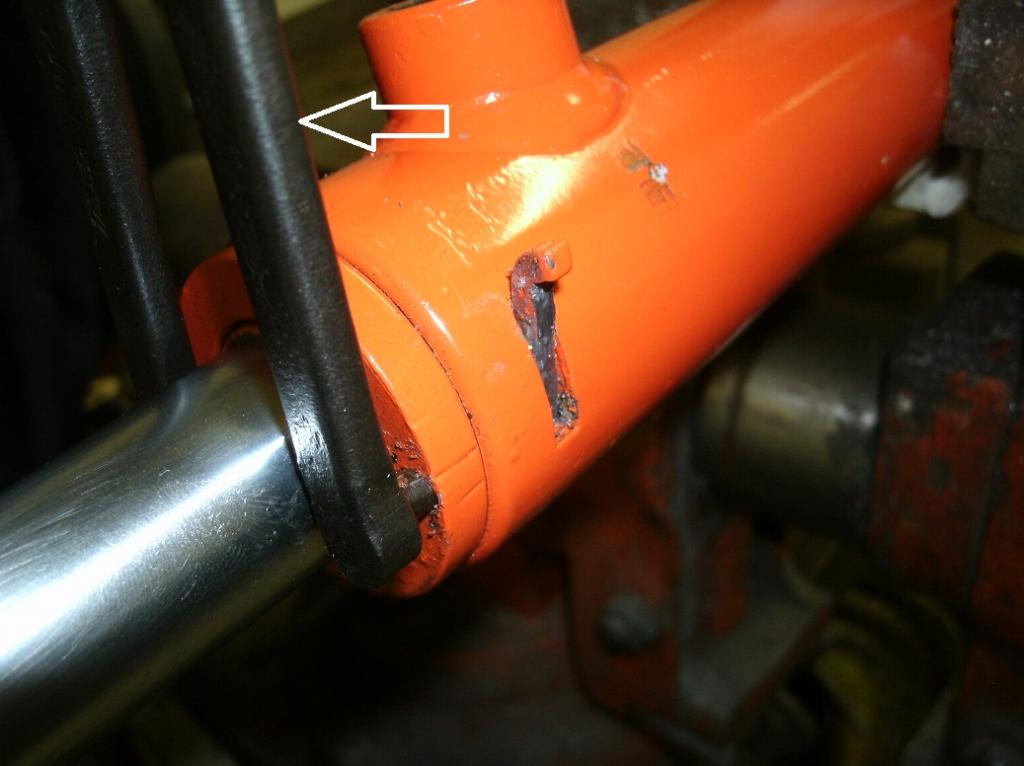

Like Dave said, that square stock is pushed through the opening to lock the cylinder in place. It simply curves (bends) as you push it in. To get the old piece out, you can grab the extended hook you can see with a vice grips and tap it out. It will uncurl as it comes out..

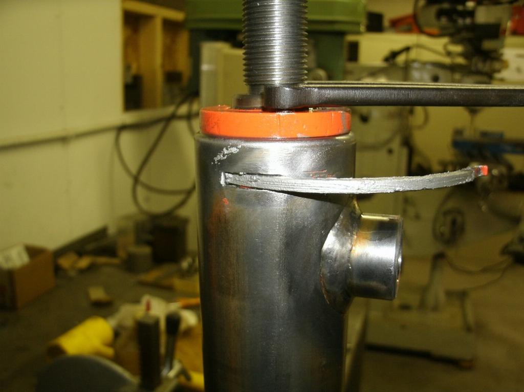

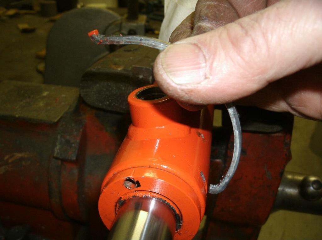

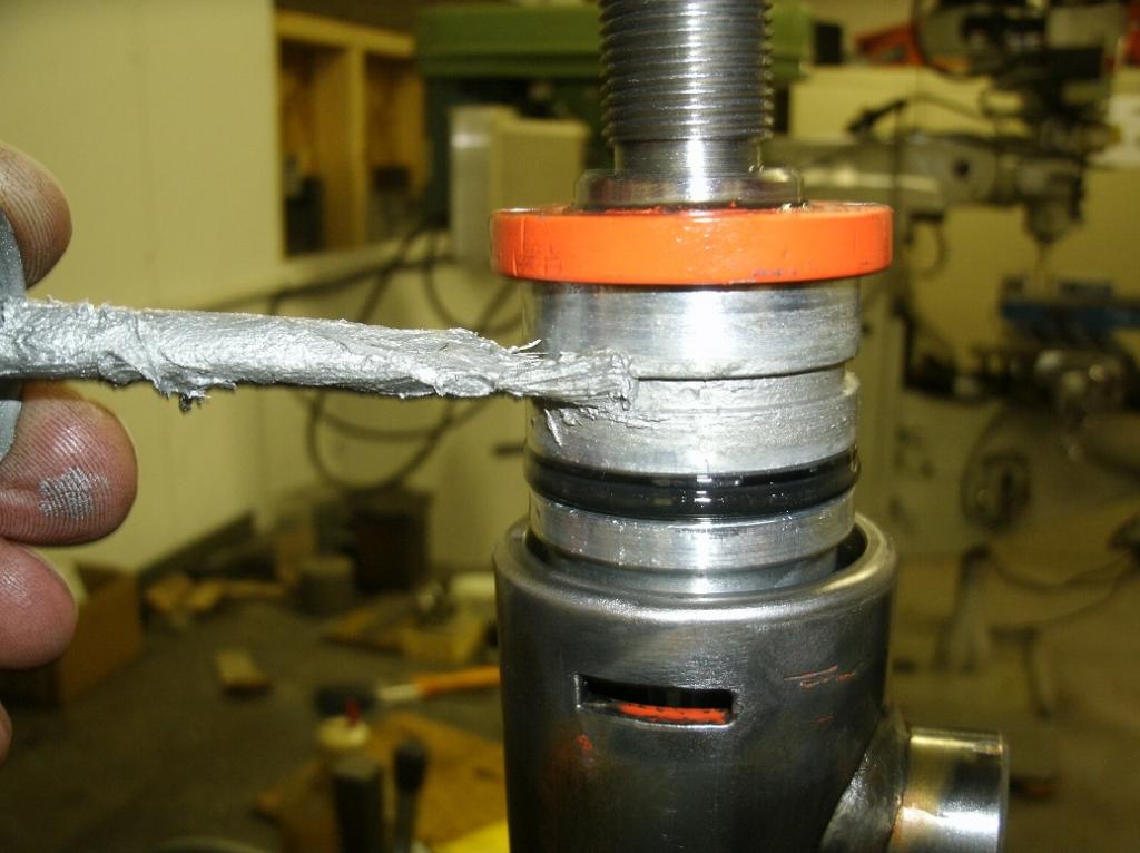

Here are a few pictures from a cylinder I modified with the same retainer design you have. Maybe they will help. I will add it is a good idea to antiseize the retainer to aid in future removal.
