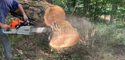

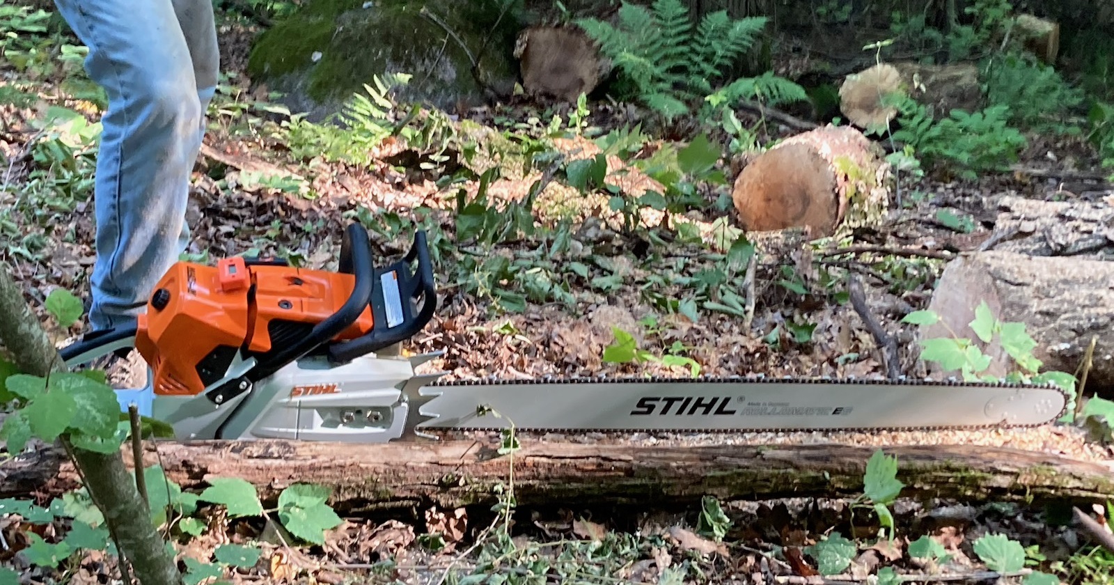

MS462 . It is a ferocious wood eating beast. Its best to operate it while wearing a flannel shirt and a grin. Its the epitome of manliness.
Great saw for sure.
I get out my SOLO 603 if I need to feel 'manly', but honestly...the older I get, the heavier it feels. ;)

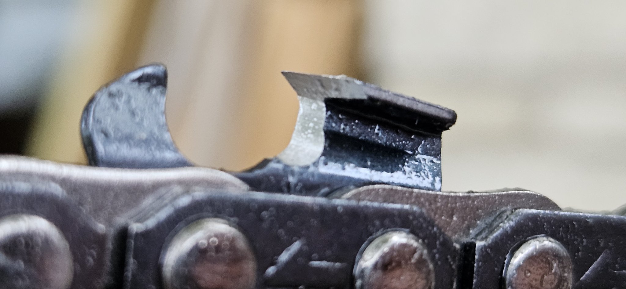

Some of the newer stihls are trying to make the saw lighter by making the bar and chain lighter. .050 gauge has been around a long time and it seems to be the norm over the heavier .063 gauge bar and chains.
The elastomer pull handles on Pro saws is because two-stroke engines can run forward or backwards, so if a slow pull on the higher-compression Pro (vs Farm or Consumer saws) causes one to pop-off in reverse it doesn't dislocate the operator's fingers.

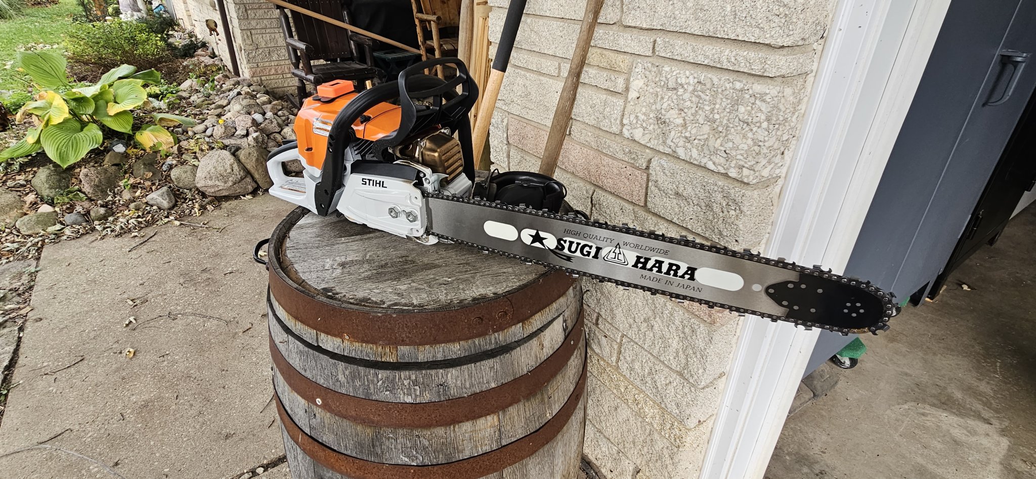

The light bars bend easier. I have Tsumara, Sugi Hara, and STIHL light bars, STIHL are the lightest, Sugi the hardest and longest lasting though most expensive, and Tsumara the most affordable (and they spring back after getting twisted up in a windfall). I run light bars when possible because most of my saws run 0.063" gauge chain--which is pretty uncommon in the U.S. so most people want to run .050" for availability reasons.
