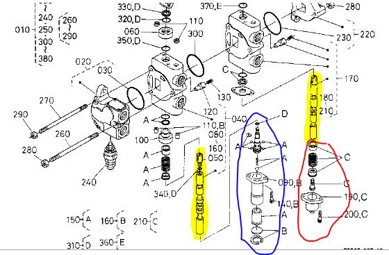

While they look longer, the actual valve is the same length (in yellow) it's just the detent is added (blue), if you removed the detent, and used the end of the old section (red), it would be the same as the original regen valve.
Now in rethinking it, I'm thinking that the spool out of the lift could give you a very undesirable result, uncontrolled fast dump as the float section of the valve would leave the spool in a wide open state with moving the control too far.
So best bet would be to get a hold of Husco as they have 5000 series without regen, and they could give you the right valve #.

The boom valve spool IS longer. I have both here on the bench. If it would work I could adjust the linkage so it doesn't go into float, But it won't work without a lot of modification. I have resolved this in the past by using a valve from a Ghel skid-loader when we were a Ghel dealer, those days are past since Kubota now have skid-loaders themselves! I was hoping someone was savy to a valve from another Kubota product that would work! If I restrict the flow it makes the rollback much to slow and still isn't very smooth.
