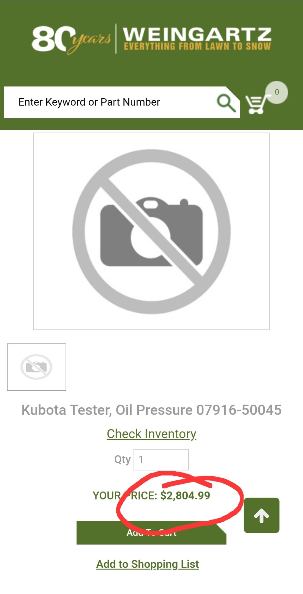

Hi, I need to run some pressure tests on my HST. My unit is an L48 backhoe and the HST is extremely weak. I don't have high range. Low and medium ranges barely move the tractor.

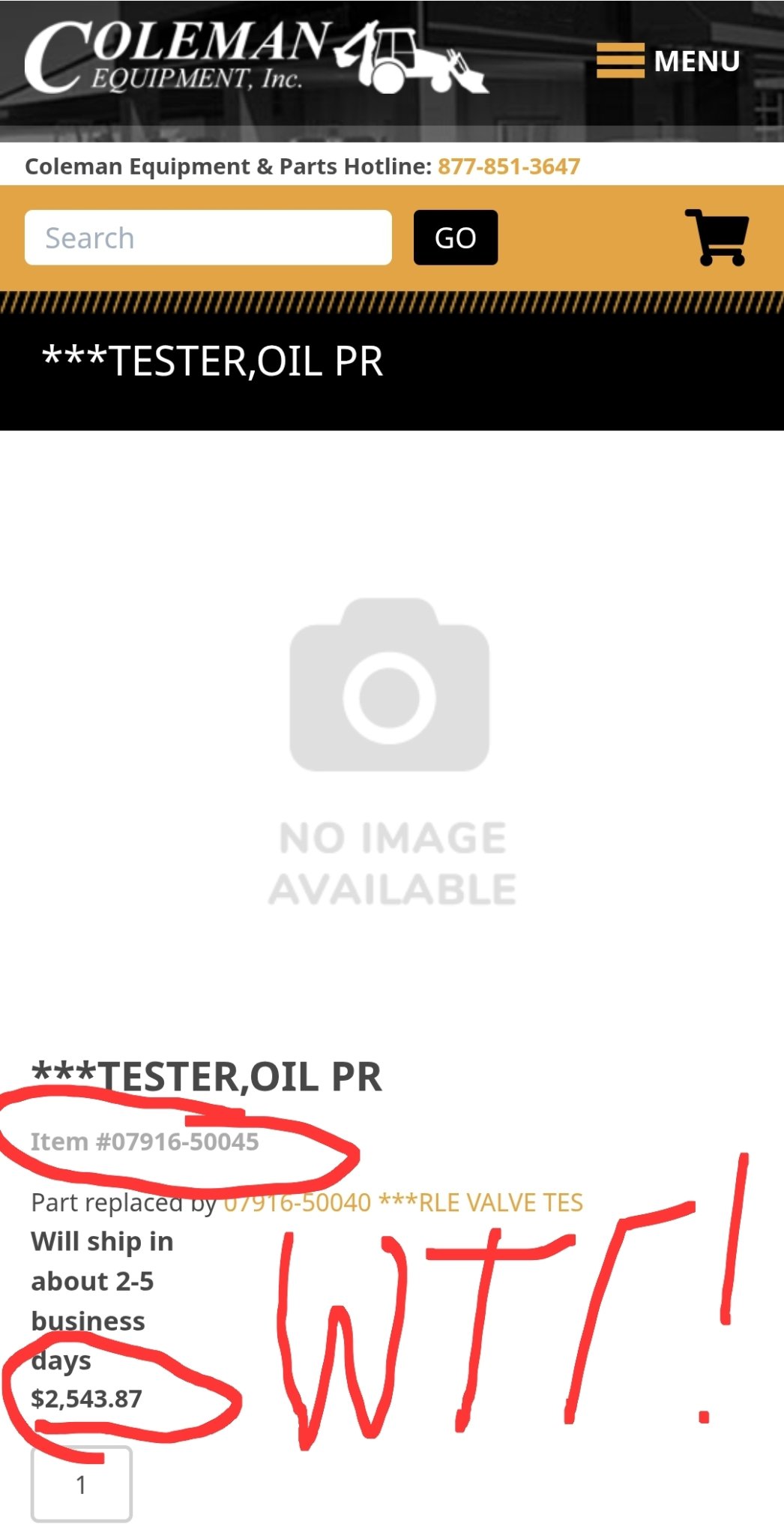

Is there anything on Amazon I can purchase to test the pressures? I looked up the units listed in the WSM and I can't find them online.
I'm on the pressure testing stage of the diagnosis.

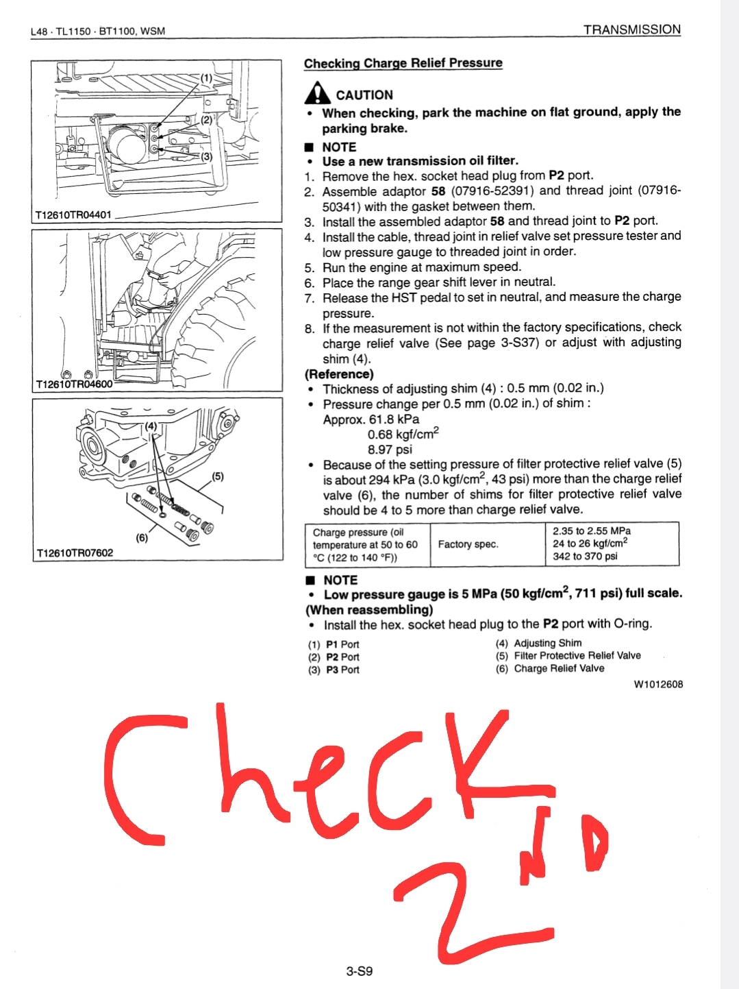

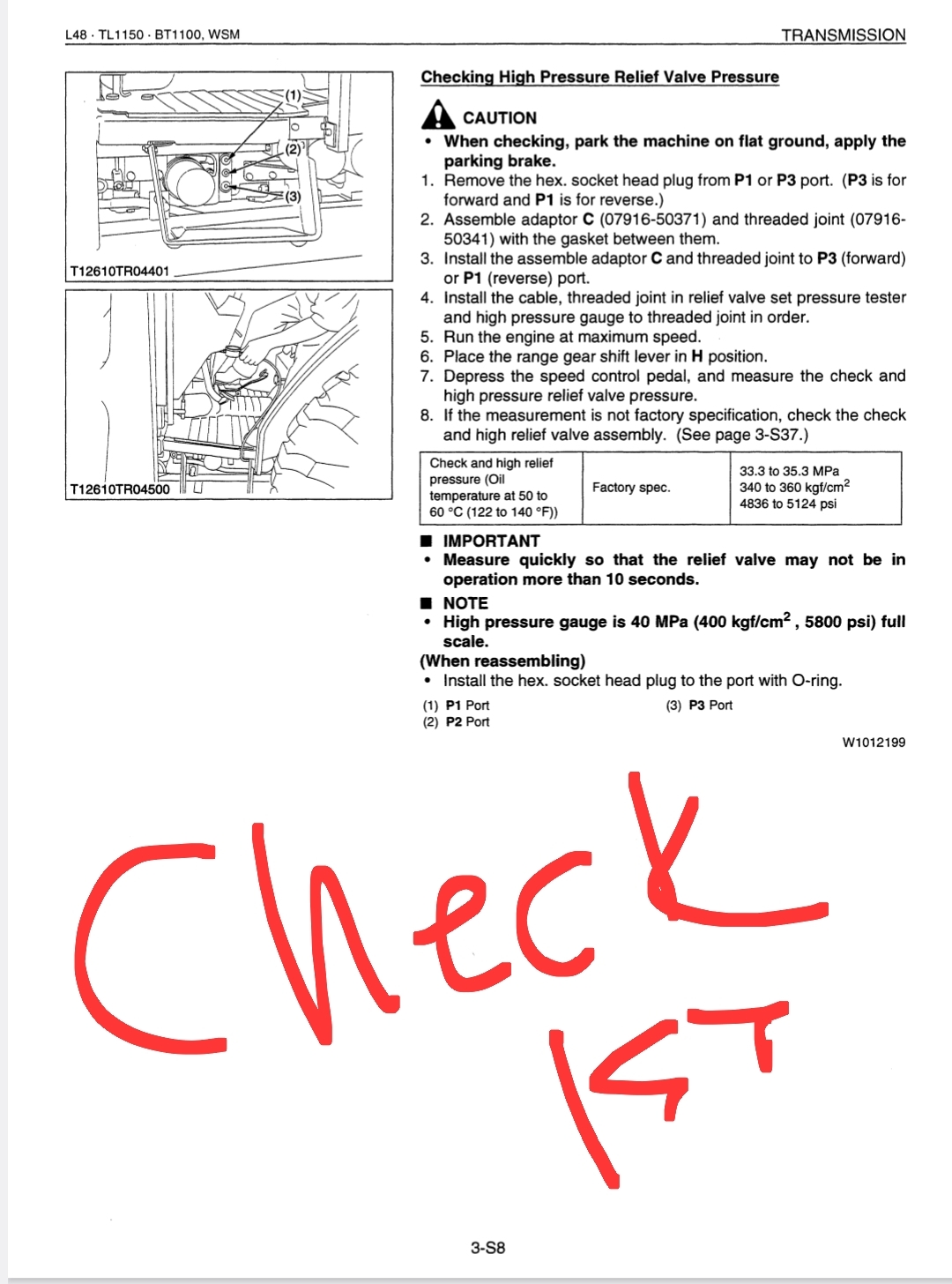

I’m reading those instructions as P1 is reverse, P2 is charge and P3 is forward. P1 and P3 will be up to 5100+ psi, P2 will be just under 400psi. Will probably need 2 gauges with those reading in or near center of their scale and any appropriate adapters to thread into the ports.

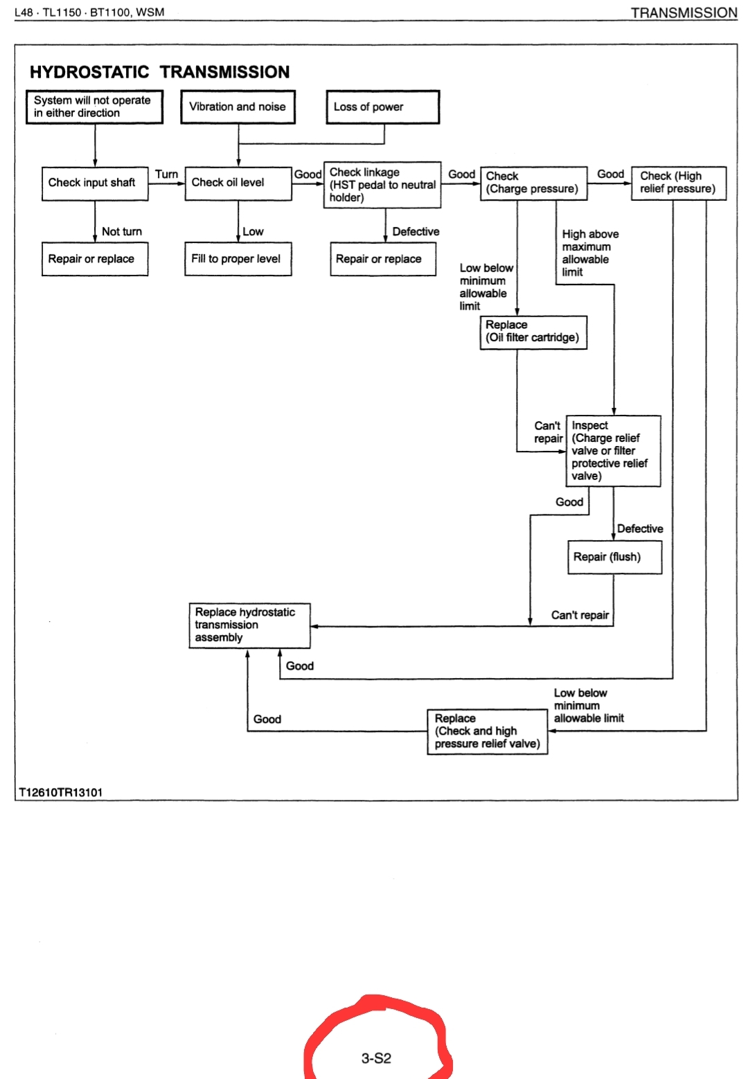

It's pretty vague when the WSM says "Check Charge Pressure". Which port and where? I can only find "charge relief pressure".

As Stated check the clutch first. To test the hydrostatic pressures it looks like you will need at least 1 6000-10,000 psi gauge (I would lean away from a 6k psi gauge and go towards the 10k) I would use 2 in each P1 and P3 port and a 800-1000 psi gauge in the P2 port. From what I can see adapter 58 is PT 1/4 which is likely 1/4 JIS taper or BSPT. You will have to adapt your gauges to that.
Charge pressure is what I would look at first as it is the most important and telling measurement, especially measuring how much it drops when trying to travel. .

Oh and the kits mentioned above will not work to check the high pressure but could be used to check charge pressure although less than optimally. Kinda like checking tire pressure on your ATV with a 150psi gauge designed for Class 8 truck tires.

For now, I'm not even sure what to buy to test pressures. Can anybody point me in the right direction?
There may be alternatives, let's see what the clutch does first.

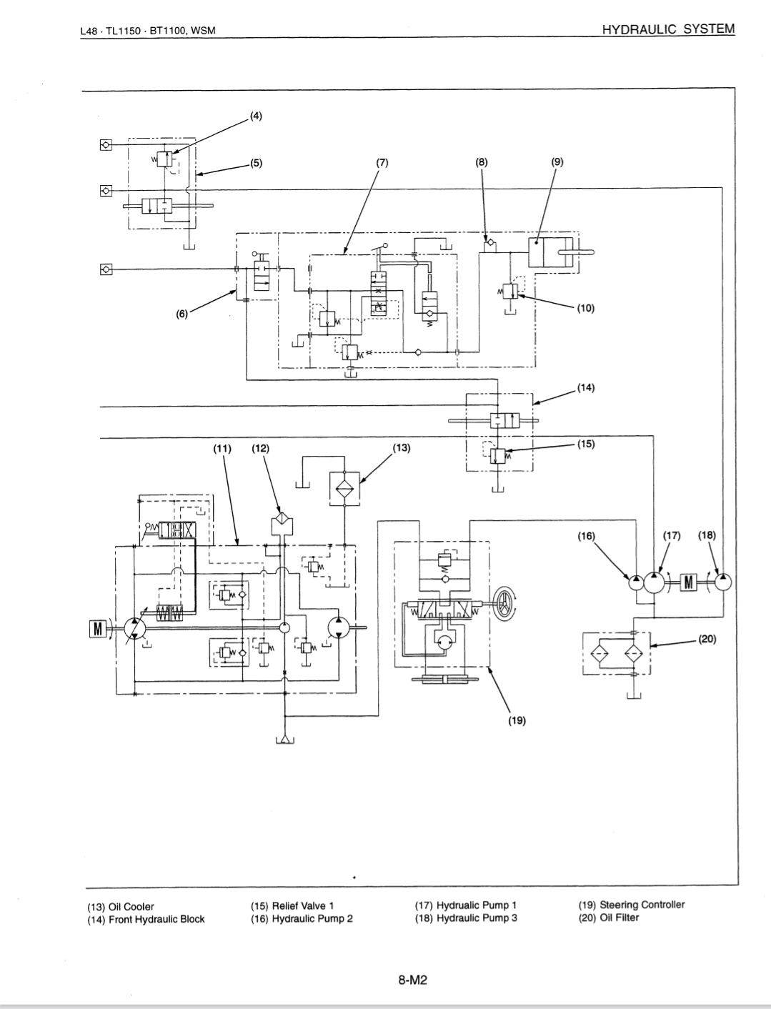

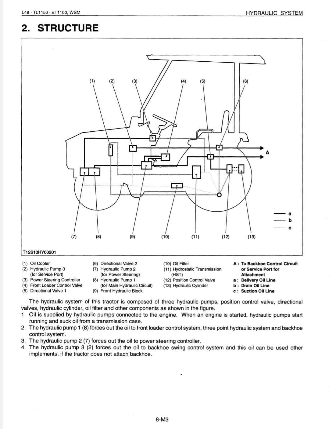

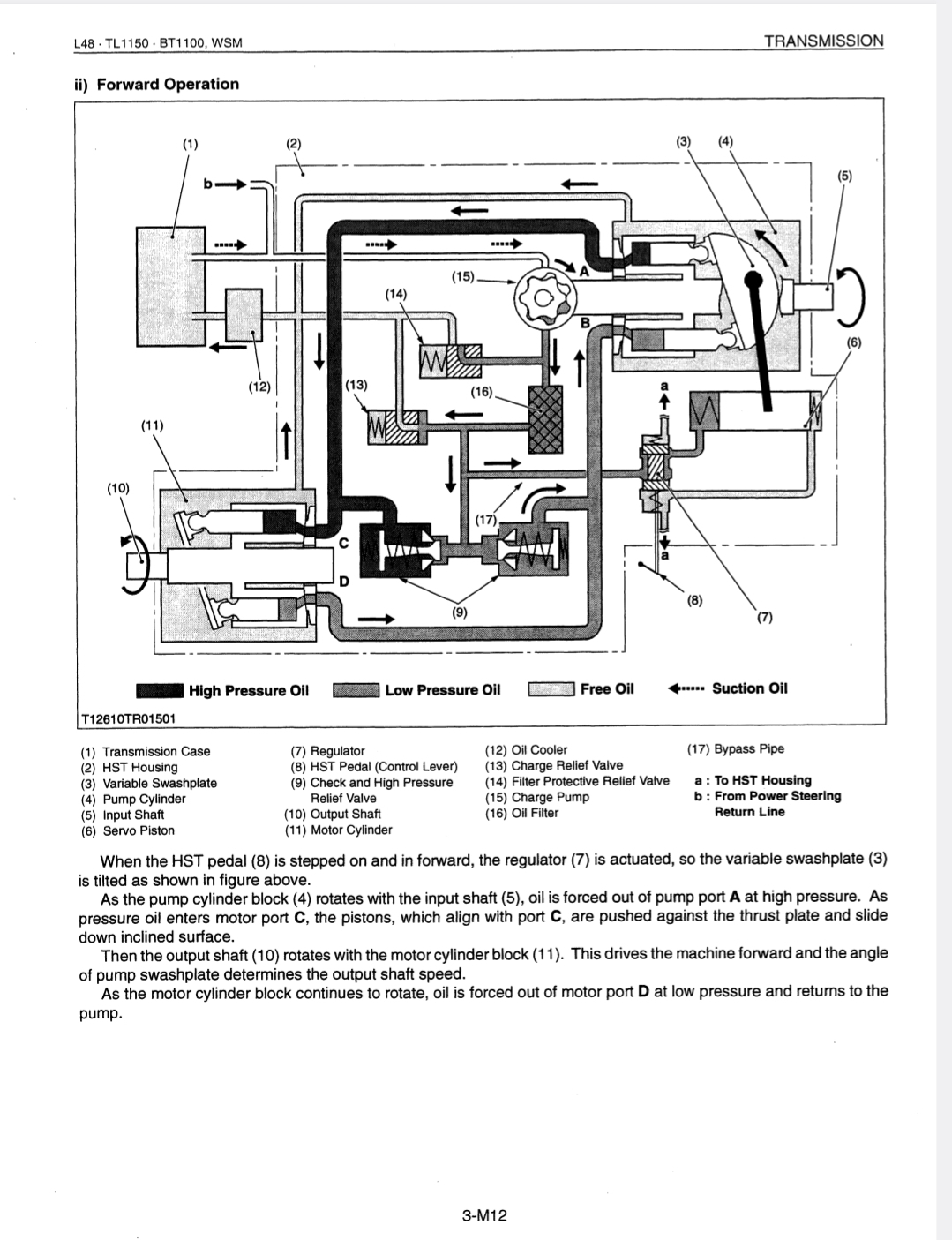

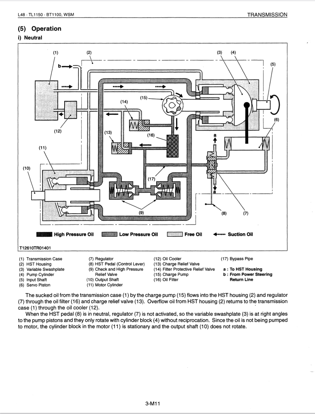

Since you have a WSM, please post the hydraulic diagram. There may also be a separate HST hydraulic diagram.
