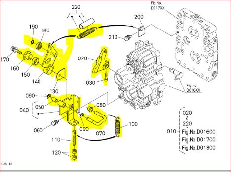

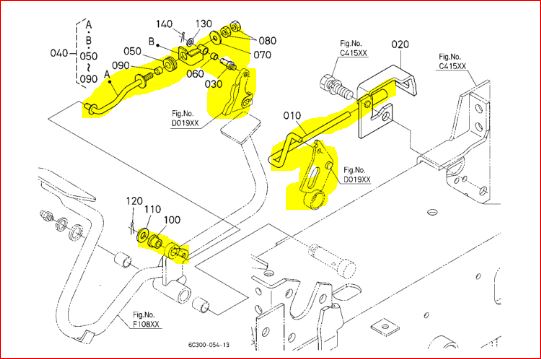

The damper does not do the centering, it just Dampens the movement of the pedal, Buffers it to make it smooth and not too quick to move.
You need to check all of these parts as they are the centering setup.
If the pedal just moves back and forth with no centering at all, I would look at # 20, #70, and #170 (loose #170 will make it not center ever).

If you get stuck, take some pictures of the linkage, maybe something will jump out at us! ;)
