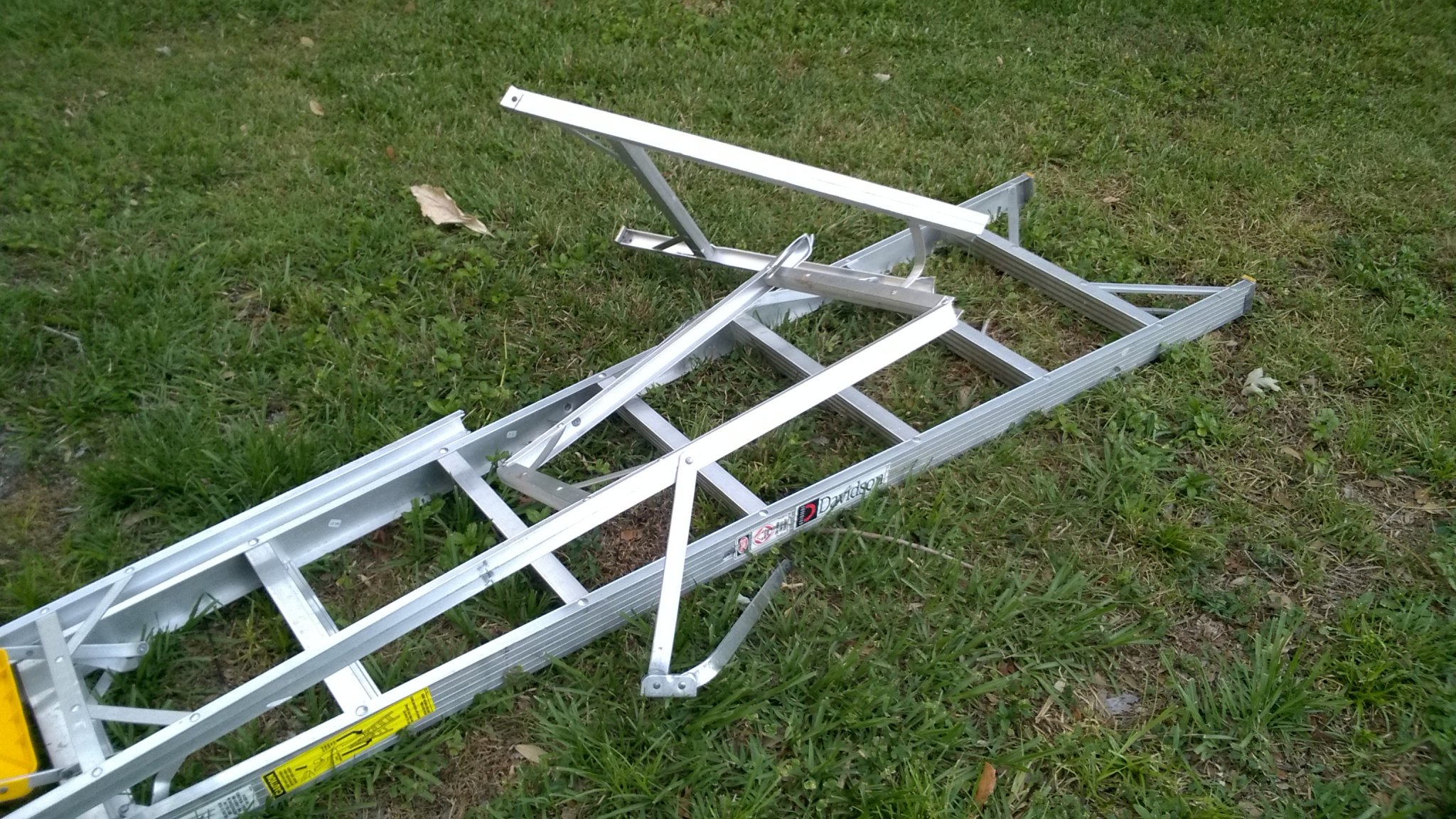

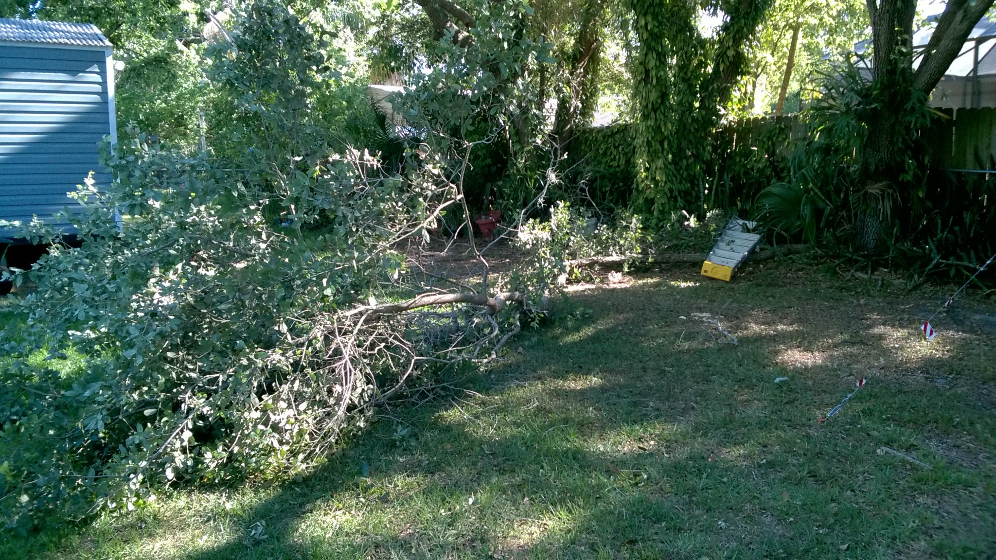

This is why this is so scary to me. The branch on the first picture was barely 6 feet over the ground on the far end, bowed down, and maybe 12 - 15 feet high by the trunk and about 4 inches thick . So I was going to cut the branch off with my gas pole saw from my 8 foot ladder, my belly was not sticking much above the top of the ladder and the pole saw was probably at about 45 degrees up cutting on the tree to the right of the first picture. I started to make the cut until I heard the "crack, crack" , I backed the saw away and the far end of the branch was already on the ground. So, I finished the cut when the branch instead of falling down, it went sideways across where the ladder was and the next thing I felt was the ladder falling forwards while I was holding to the pole saw in the middle like the balance rod of tightrope walker. When finally all the action was over, I found myself still holding the saw (engine running) but now sitting on the ladder steps with my feet on both side of the ladder as shown in the first picture. I felt no pain discomfort or anything and everything felt fine. So I my initial thought was that the ladder had gotten closed and I fell. But when I turned over the ladder that was not the case. In the second picture is easy to see that the branch came across and broke both front legs of the ladder, destroying them. So I was fortunate that I was not hurt on the fall but also I was not impaled by the broken and jagged aluminum pieces below.

If that is an 8 ft ladder it probably has a 150 lb weight limit lol.
glad you are safe and lesson learned. The only way I will get on a ladder to cut a branch is if I can use the entire tree trunk for protection. That usually isnt the case so I dont do it much at all.

One of the most common mistakes I see. First working off of a ladder but second, when the limb does not detach and fall straight down as the person cutting assumes it will.
Instead it swings down (far end contacts the ground) then tears loose or person cutting continues to cut. Not realizing the limb (now at an angle) HAS to fall with the butt coming back in the direction of the person cutting. Invariably it takes out the ladder or the person on it.
Second most common occurrence is when a person fails to make an undercut FIRST on the limb. Instead makes the cut from the top nearly all the way through until the weight of the limb takes the limb down but the remaining 'hinge' (wood or bark) lets the limb swing back into the cutter.
Usually these are homeowners with little to no experience and they just don't think about the dynamics.

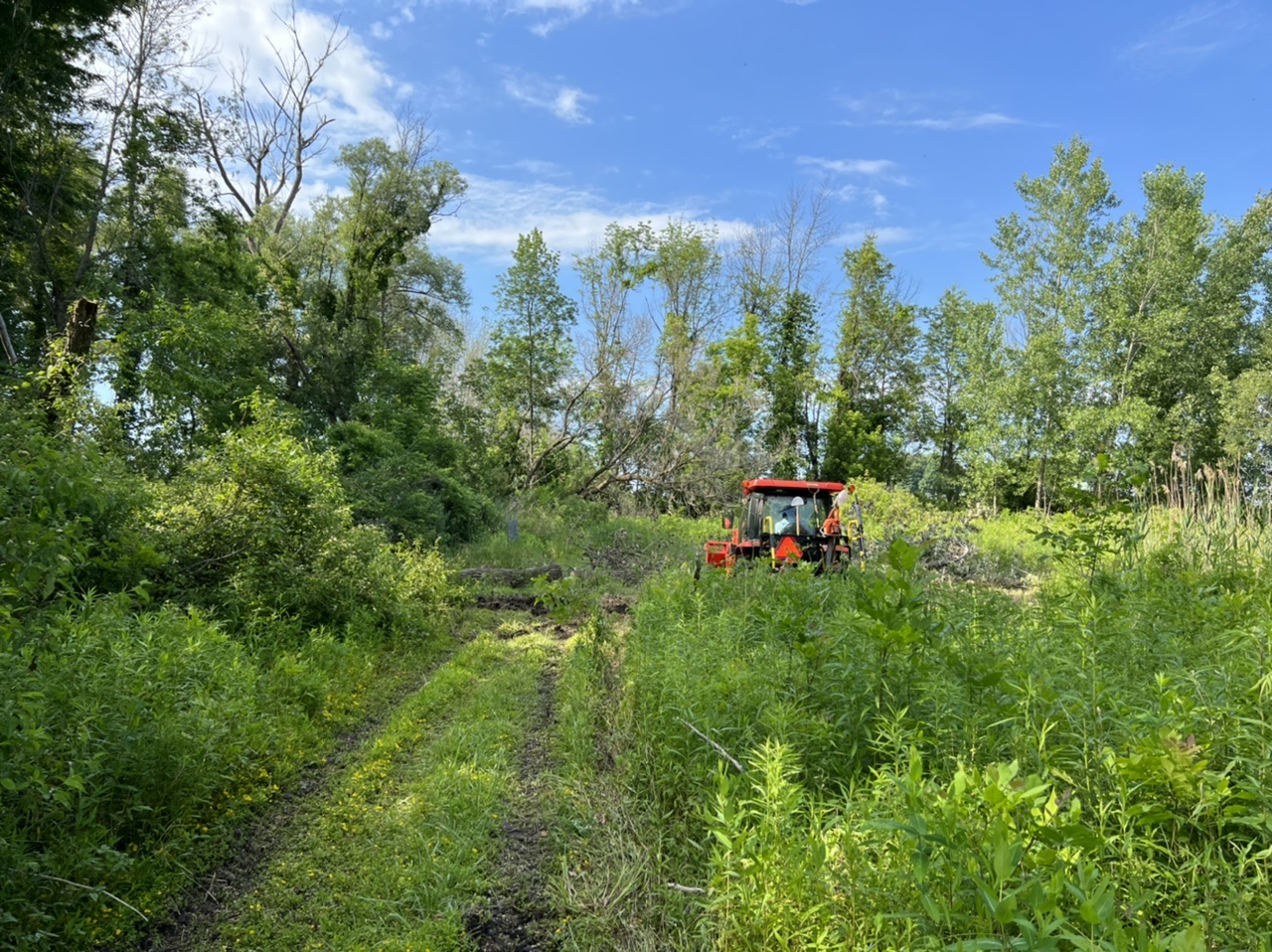

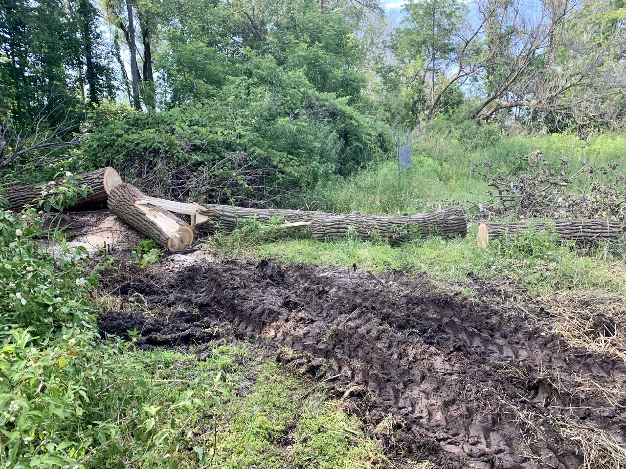

And we are done.
The last 16’ or so of the trunk to the rootball can sit where it is forever as part of the backstop.
This has now officially stopped being a cleanup project and become a range backstop improvement project as the next steps are gonna be piling the trunk sections on and infront of the berm adding height and depth.
last few chunks were a lot bigger diameter than my bar length - so I undercut up about 1/4. Then cut in from the side close to me. Then cut down from the top until the kerf opened up. Pulled my saw and then used the loader to push it (not a lot of force needed) and snap it off letting 4’ or longer sections fall off.
when the very last section came off the trunk gently came up about 4”. And then, Ohh so slowly another 2-3” while I was putting tools away.
So - safe, slow and controlled -only one moment of a “humm”. So - all in all - very successful and my last update on this thread in terms of status. Cause status is “done”!
