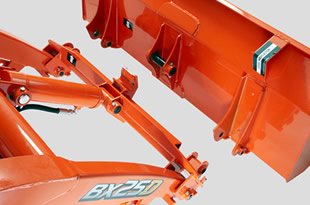

Here's my question: I have the Kubota Quick Hitch system on my FEL. To alleviate confusion, I attached a picture of what that system looks like (poor branding by Kubota on this system). In order to make this grapple compatible with my Quick Hitch, I think I just need to permanently install a pin in the center of the grapple. Is this correct? Is so, does anyone know what pin I would need to install in that center position and where to find one?

If i am reading this correctly then you need to go to a tractor supply store and get a pin the same size as the one you already using on your bucket and put it on the grapple if your not wanting to move pins back and forth. I am assuming the grapple will already have the center mount installed since your saying it list your type already.

Thanks Redlands. I guess I just need someone to confirm that's all the quick hitch system requires to convert a regular pin-on bucket to be compatible?
