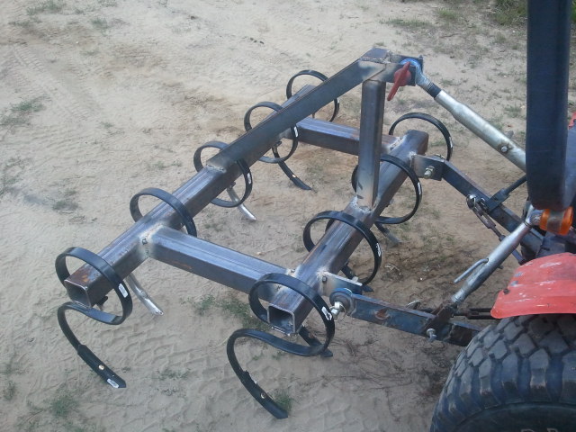

I field cultivator does a great job at ripping roots out, that's what I made mine to do.
Here is the one I made, It's on the B7100 here and 9 teeth was a bit much for the B, I have a 3 tooth one that I made that just rips the ground right up
Here it's on the L3450, the L pulls it without a problem!
