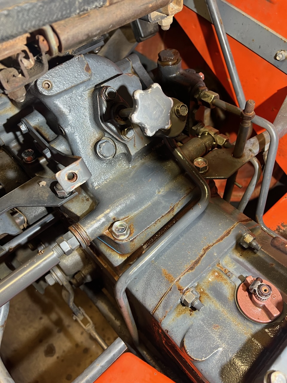

Thanks, looking at the WSM, it seems the plug is next to the 3 point lowering knob.
I am trying to figure out why my 3PH is not working or weak. I replaced the large o-ring on the lift piston. It will lift at higher RPMs but appears to not be strong enough to lift an implement. Thoughts/ideas welcome.

Well a pressure test at that point will not be conclusive. You will certainly see low pressure but you wont know if that's due to weak pump, leaking/weak relief, and/or leaking piston seal. Does the WSM have a procedure for isolating and testing the pump?

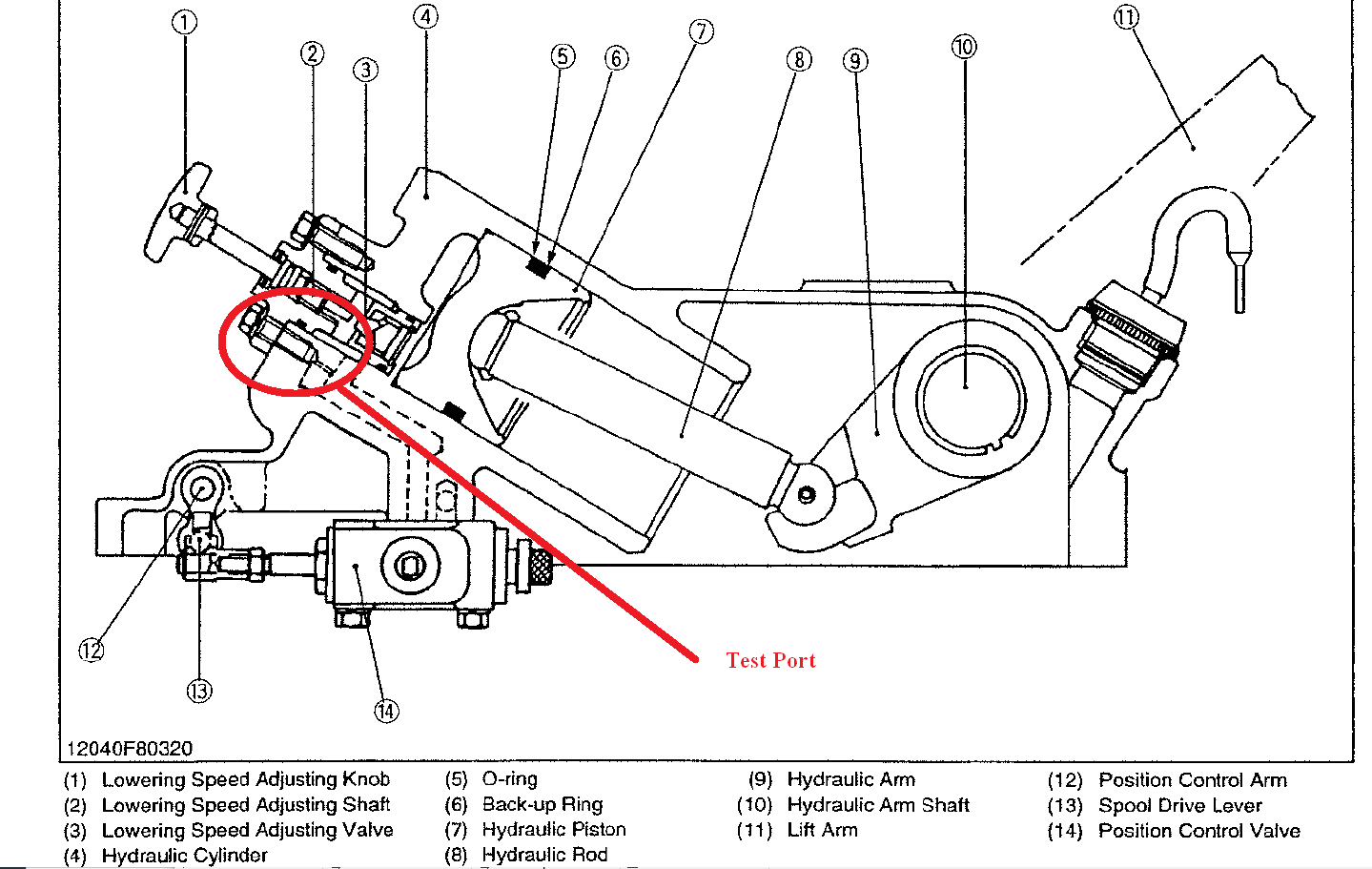

that said hook a hose to that test port on the front of the cylinder, put the other end in the hydraulic filler, start the tractor set engine speed to 2000 RPM and raise the position control lever. If the valve and position control linkage is working you should get a solid stream of oil out of that hose.

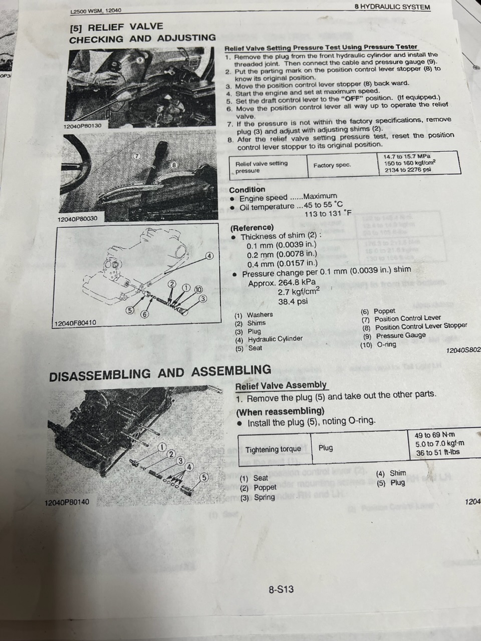

Looking at the FSM, the top photo is hard to see, but it appears it's the plug I mentioned above.
The control valve has 2, one on top and one on the rear, then there is (I think) a relief valve on the side of the hydraulic lines that is on the top cover.
Dan, you are saying to put a hose on the front plug , route it to the rear filler and if there is a solid flow then it's working?
i will say I read the procedure for adjusting the lift rod and I am not certain I did it correctly, I did not hear the relief valve engage.

As I said I am working blind. It's not clear where that front plug connects. If the WSM has a hydraulic schematic could you post that?
As far as my flow test it looks like you can run the hose from that test port to the orange filler right in front of it. It's going to be low pressure (50-100 PSI max) so plain vinyl tube should work. If that test point is between the control valve and pump you may get flow as soon as the tractor is started.

I was gifted a copy of the WSM so my vision has improved - my thanks to the OTT fairy godmother(y)
Not 100% sure but the plug appears to be in the supply line from PC valve to cylinder so the only time there is flow is when the PC valve is commanding lift. Getting flow when you raise the lever indicates the PC valve appears to be commanding lift. So why no pressure?
The WSM procedure for checking pump pressure involves a direct connection to the discharge port on the pump which is not easily accomplished and requires care since there is no pressure relief in the circuit.
You could check pressure at the outlet tube of of the PS priority flow valve. That has its own relief and with a gauge screwed into the outlet port on the PS valve should be close to 1800 PSI. If that is low it would point to the pump. If its not low then the problem would seem to be in the lift circuit of the PC valve and cylinder - e.g. pressure relief valve or o-ring.

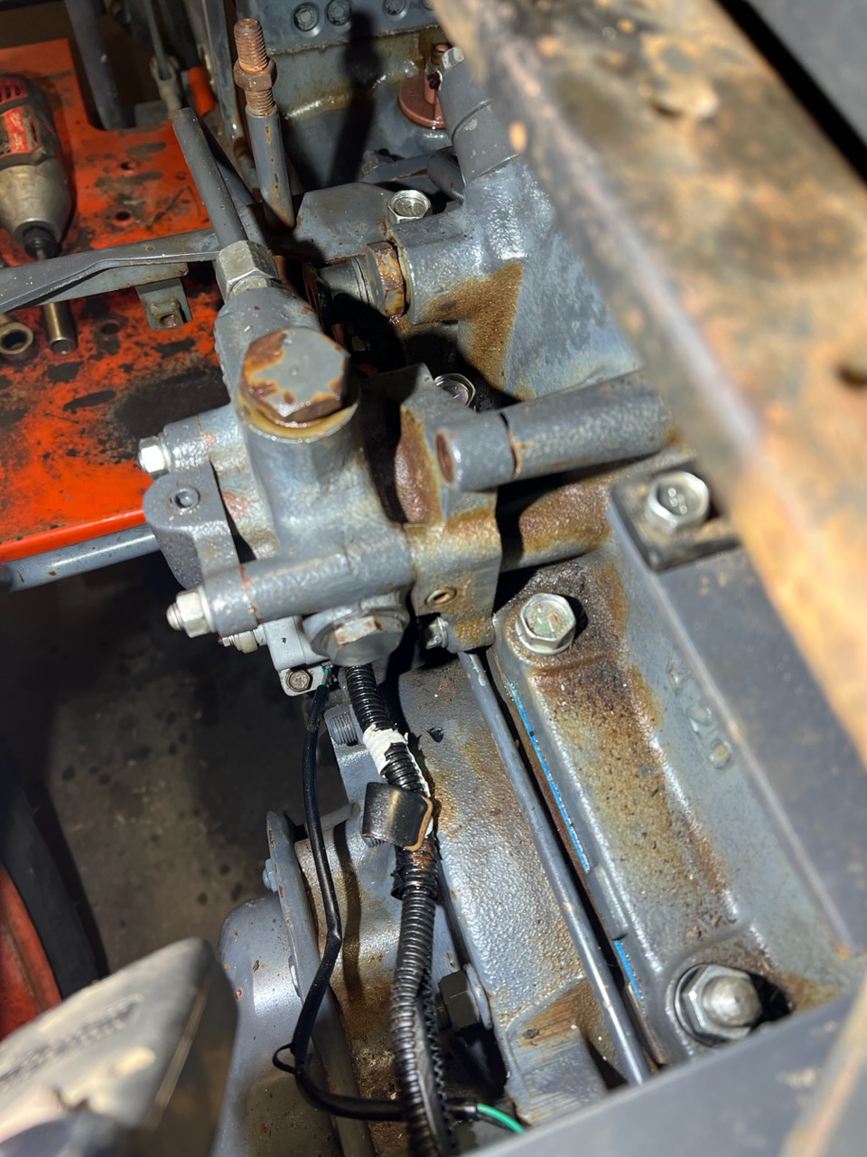

Good question, I think the easiest would be the top of the valve that the hydraulic lines run to/fro, this way there is a relief valve to safety (I think).
This one here on top. It is a 24mm socket to remove. Otherwise the next would be the one on the side, which is the bottom in the photo where the wire loom runs under.

That valve is a priority flow divider for the PS citcuit and gets pump pressure from inside the hydraulic cover. The two hard lines are pressure out to and return from the PS unit. I suspect the hex nut is either the pressure relief or flow divider poppet. I would have to look at the parts diagram to know for sure but neither would be a test point.
Let me rephrase the question - what care you trying to learn with the test?
