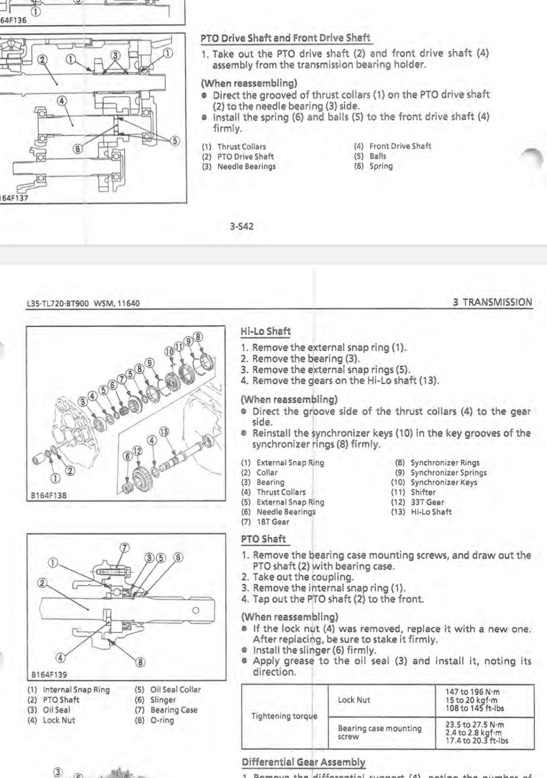

Here's the page from the WSM
There's a spline coupling connecting the PTO drive shaft and the PTO shaft. Bear in mind the WSM's describe a transmission disassembly/reassembly, I don't know what happens to the coupling if you just pull the PTO shaft out.
