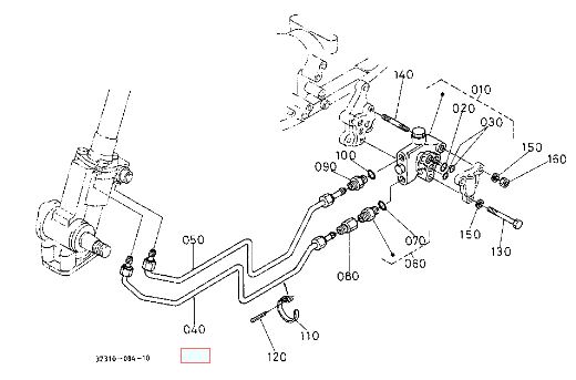

thanks. yes, I did try that too. here is another question.... the top hose has a single fitting, so 2 nuts. easy enough. the lower has 3 actually, two designated by 80 # in the diagram and the third with #40. which ones do I hold to remove?
33,666
8,895
Turn the Flare nut on the line and hold the nut on the fitting closest to the flare nut. ;)
