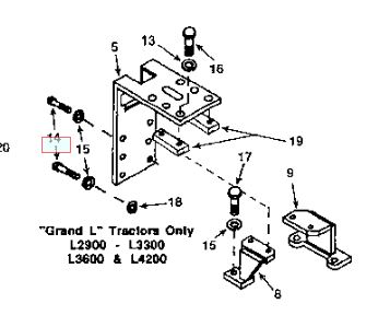

Dont know who's photo i stole, but i think this is the one.its from here, but image is poor.
Depending how its sitting now,pump needs to be connected,starting with outriggers and getting three point arms connected the pinholes below footrests.
Three point arms go over the round tube crosspiece. Then by manipulating three point and hoe itself you can get top link connected. It hooks on one pin,and second pin retains it.
Its fiddly,have a couple aligning bars handy and dont use fingers to check for pin alignment.
Kubotabooks.com has a manual for it.
**check bolts on top link bracket, they like to break!**
I replaced them with wheel studs threaded right to bottom then nuts to hold brackets on. Never broke a bolt since.

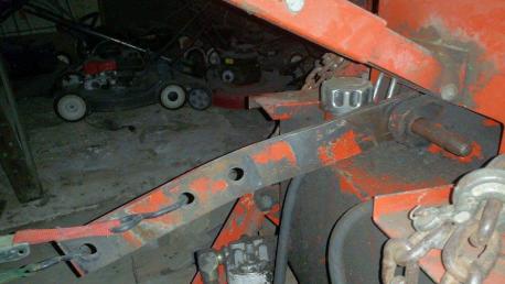

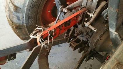

Hard to tell if plate is there,that big flat orange one on tractor is the backhoe upper link. The top link plate rienforcement bracket mounts behind it, and faces forward below seat if i recall. Ties everything together.
Stuff looks kind of rough. Glad to see you want to bring it back up to snuff.

Your tractor already has the reinforcing bracket installed on it. :D
So all you need to do is get new pins and hook it up. ;)
