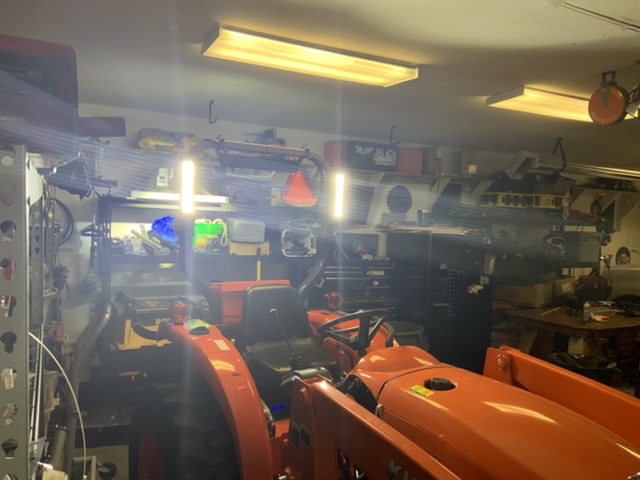

I added 2 forward facing, and a rear facing 18” bar. I wanted them switched separately so I added a sub fuse panel and a 4 bank switch panel that also has a usb plug and 12 volt plug in it. More than enough light, my driveway is 400 ft long and it lights it up clear to the bottom.

My 2 forward facing lights are 12 inchers @ 108 watts each, both on a 10a fuse together
My rear facing light is an 18 inch @ 180 watts also on another 10a fuse
