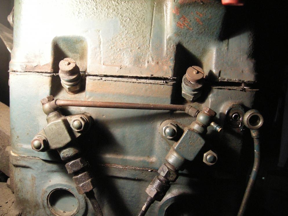

Here are a couple photos of the assembly in question on two different engines. The first is on the tractor, and the second is on the blown engine. Anyway, the fittings on the tubing leading into injector inlet is 17 mm. At the top of the injector is what I'm calling the bleed nut. This is the 12 mm nut you crack if you want to test whether a cylinder is working or not, and also, I am presuming to bleed air out on startup. There is tubing between injectors and beyond that sends overflow fuel back to the fuel tank.
If I've got this wrong, tell me. I'm here to learn. So far, I've not been able to get fuel up to the injectors, and for this reason I can't start the replacement engine.
14,312
6,530
In your pictures, the bottom most nut (2 ea) is the ones you want to loosen. Be sure to have a wrench on the half it tightens onto. You should turn the engine over until you have diesel coming out those lines...without air bubbles in the fuel.
The lines on top of the injectors are fuel return lines going back to your fuel tank. No pressure in them.
I do not loosen the nut on the top of the injector to bleed air. Do not take the parts out of the top after you remove the nut or you have further problems. There is a check valve that is in there and it have to be facing the correct direction or no flow will happen. And, it's so small you probably won't recognize it as a check valve.

Second what D2Cat has stated.
Those "bleeders" are not the primary air purge fitting.
(although I am advised they work if the injectors leak ;-)
Crack those compression fittings below, using a back up wrench on the fitting!
Fuel will flow in less than five seconds if the fuel delivery rod is pushed home and the engine cranked while the valves are lifted.

Thanks for the help. I cracked those fittings and got fuel flow through both. I tightened them up, and after cranking at full throttle I got it to fire a couple times, but it's not quite ready to run yet. There might be a glow plug problem here.
