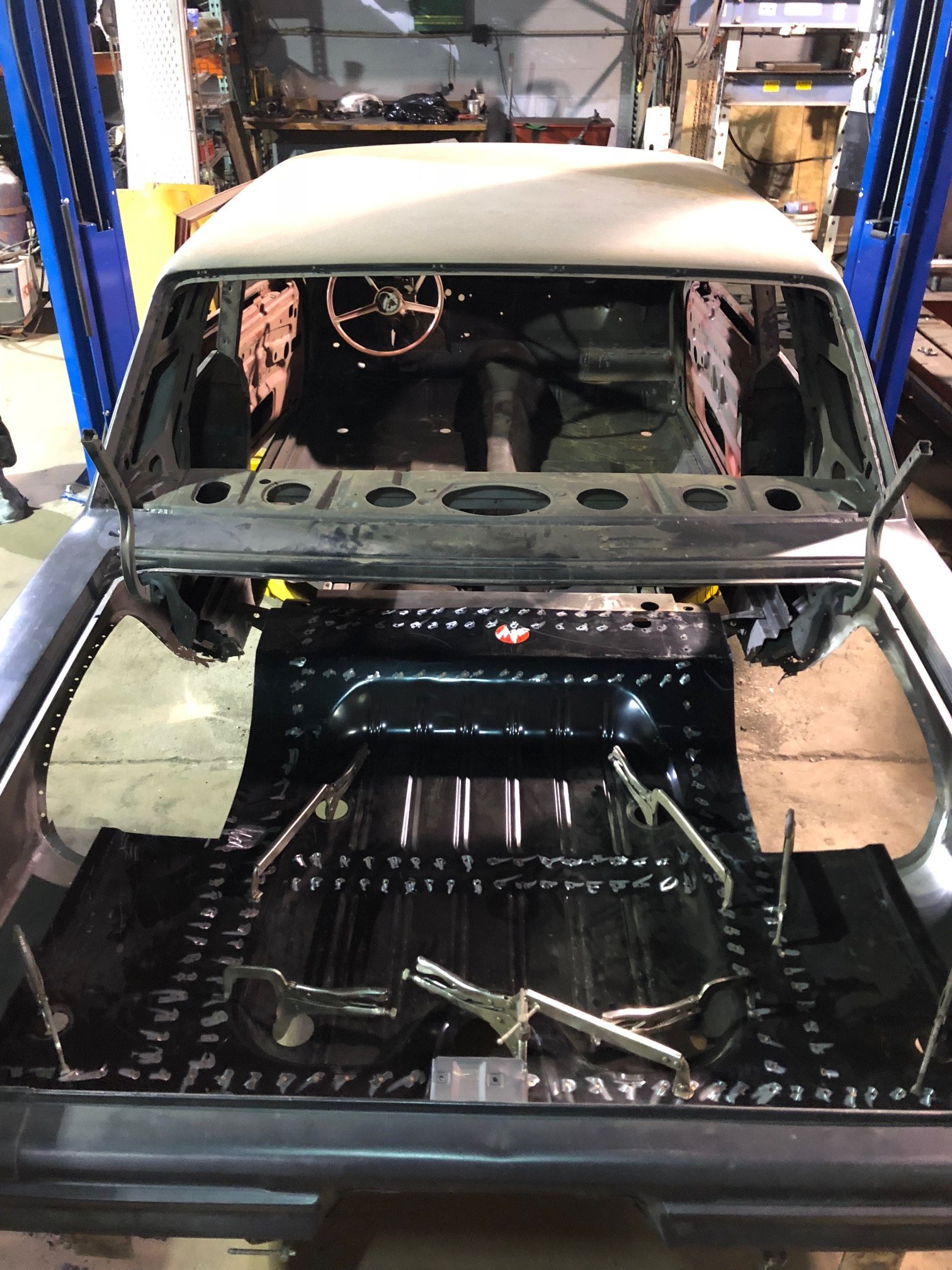

Next vehicle, currently in build, is a 1965 Dodge Coronet A990 Super-Stock tribute car. Only this one goes just a bit beyond the factory equipment:
-572 stroker Gen II Hemi
- aluminum radiator
- hydraulic clutch (blueprinted New Process A833 4-speed)
- 4-wheel titanium disk brakes
- Narrowed Dana 60 rear (for tubs), Powr-Lok 4.56:1
- subframe connectors
- Customized rear frame (lightened and strengthened).
- fuel cell
- Deleted firewall/dash structure (heater ducts, wipers, etc.)
- Fiberglass front fenders
- major diet plan. This car will have a <=3000 lb curb weight.
Just bought the Hemi in August, in kit form. $18K. Should be on the track next summer.

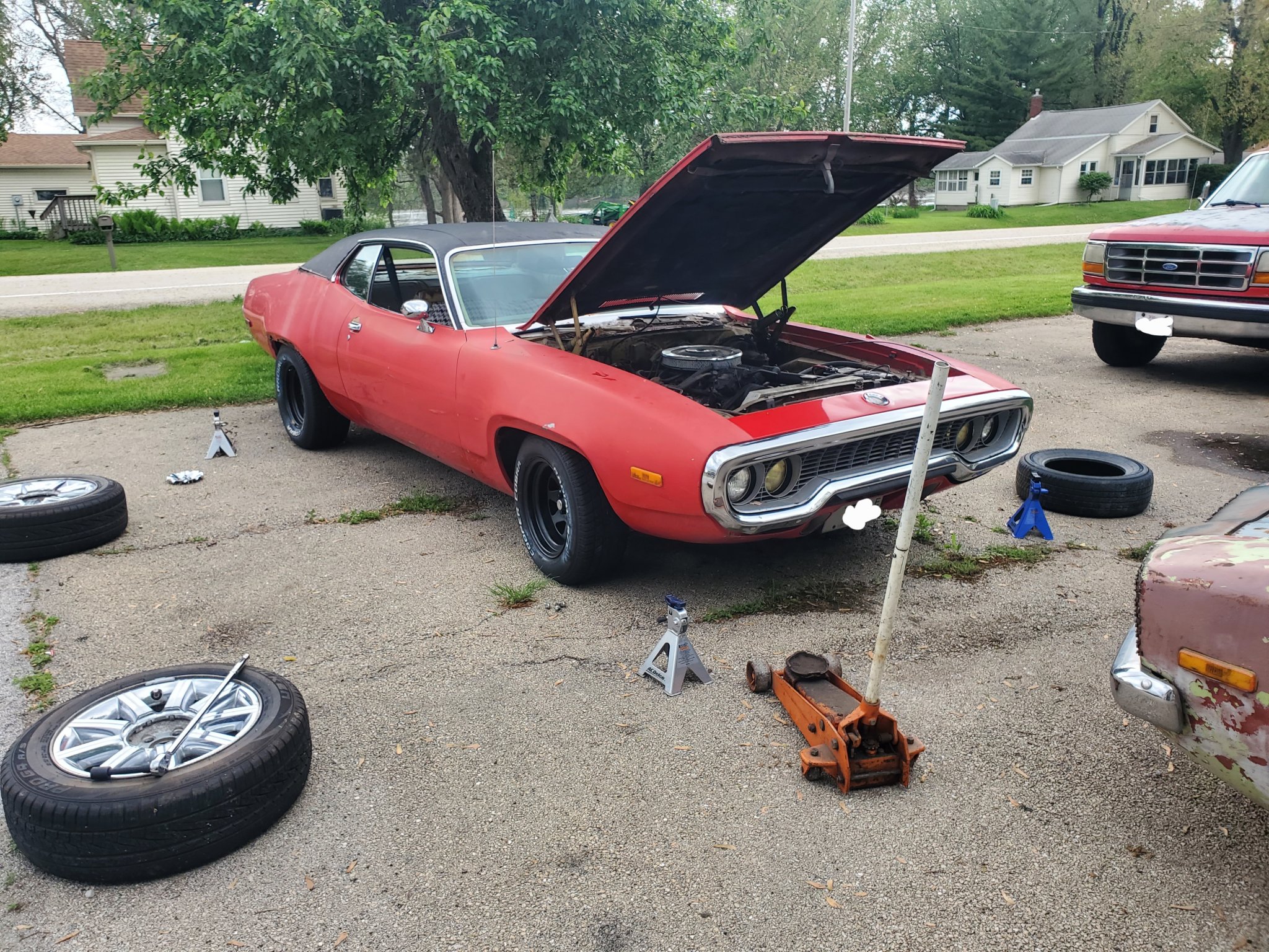

Oh my, is this the official mopar thread? Well since we lack pictures, I'll toss my old project car in the mix. Its down currently due to a frame issue but hoping to get back in it next year.

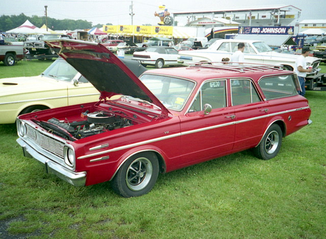

Here's the Dart Wagon, shortly after it was built, 1997, I think. This pic is all over the internet.

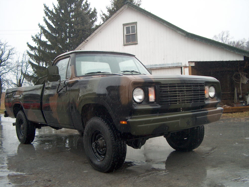

The M880:

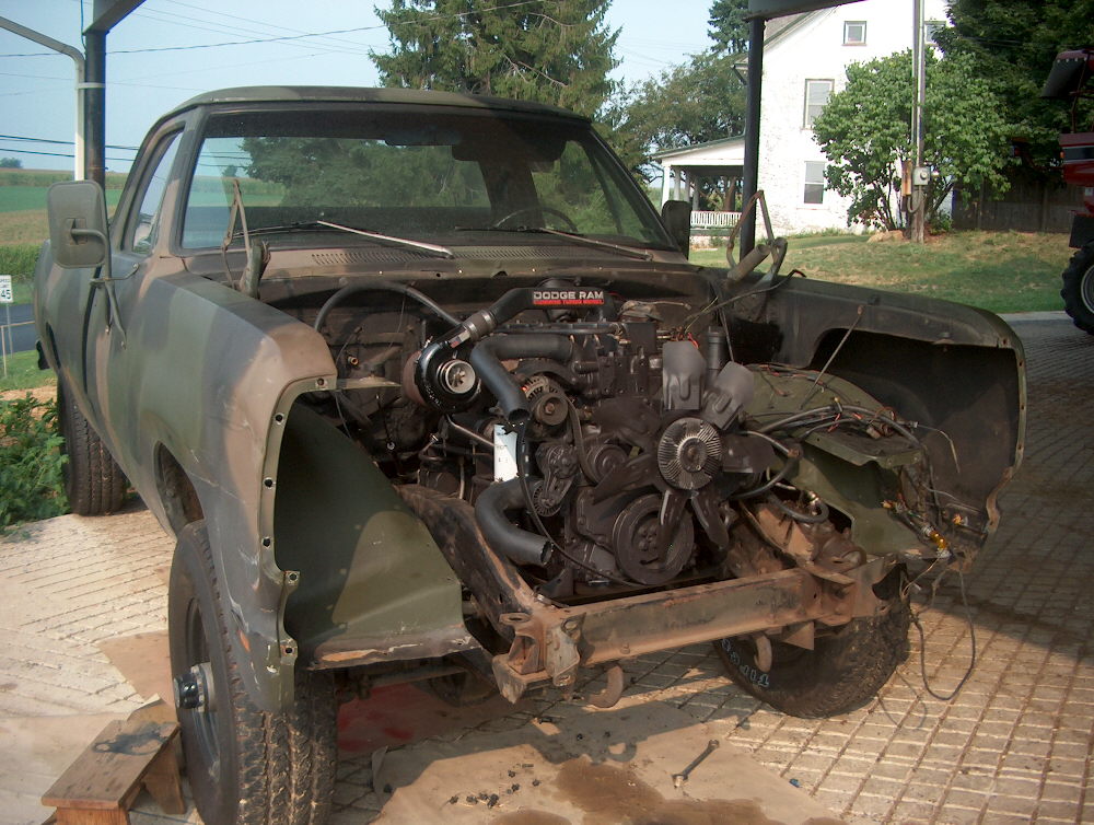

And, a shot during the initial Cummins tranplant, 2006:
Should have mentioned that it was a bolt-in. Except for the trans. This truck has a lockup/OD A518 AT aka RH47. First year for that trans was 1993. The fatter converter pushes the trans back 1.5 inches, which required a different trans adapter, custom driveshaft and a different starter. No biggie...
Gosh, I can't find any good recent shots of the Coronet. {I'll get on that.] Meanwhile, here's an early build shot:
And, a detail shot:
It's currently a LOT farther along than this...Stay Tuned.

Sounds like a sweet ride. Buddy of mine has a 71 RR butterscotch yellow 440 car. Not a 6 pack car but still a ton of fun to drive.
Mines a 72, and the first muscle car I've ever driven. Always been a mopar guy and especially a B-body guy. My dream car would be a 70 charger, but those are out of reach. This one was my buddies car, the same one who owns the 71. Big mopar guy too, especially the 71-74 Plymouths. He offered to let me drive it to shows with him and his 71 nearly 10 years ago now. Took 6 years to get it off him.
Once I get the chassis repaired the build will start from a similar mindset as you. I can't leave anything stock and prefer factory-esque mods with this one getting an slight upgrade in technology. The plan is the ultimate driver car. The vinyl top replaced with bedliner to keep the look but prevent another roof replacement. The 318 a727 combo swapped for a 360 magnum 46re combo from a 99 ram. The engines been made into a 408 stroker. Which grants serpentine drive, OD, and modern A/C compressor mounting. Thr car will be rewired to a marine standard for reliability and ease of diagnostics. Then just holley efi and a brake upgrade.
Ideally the final outcome will be a bulletproof reliable car making in the neighborhood of 450-500hp that still gets 20-25+ mpg, a nice stereo, and ice cold A/C without taking away from the feel or looks. Most people complain about how the old cars handled, I prefer that floating down the highway feel. I have an e46 if I want something to autocross.
