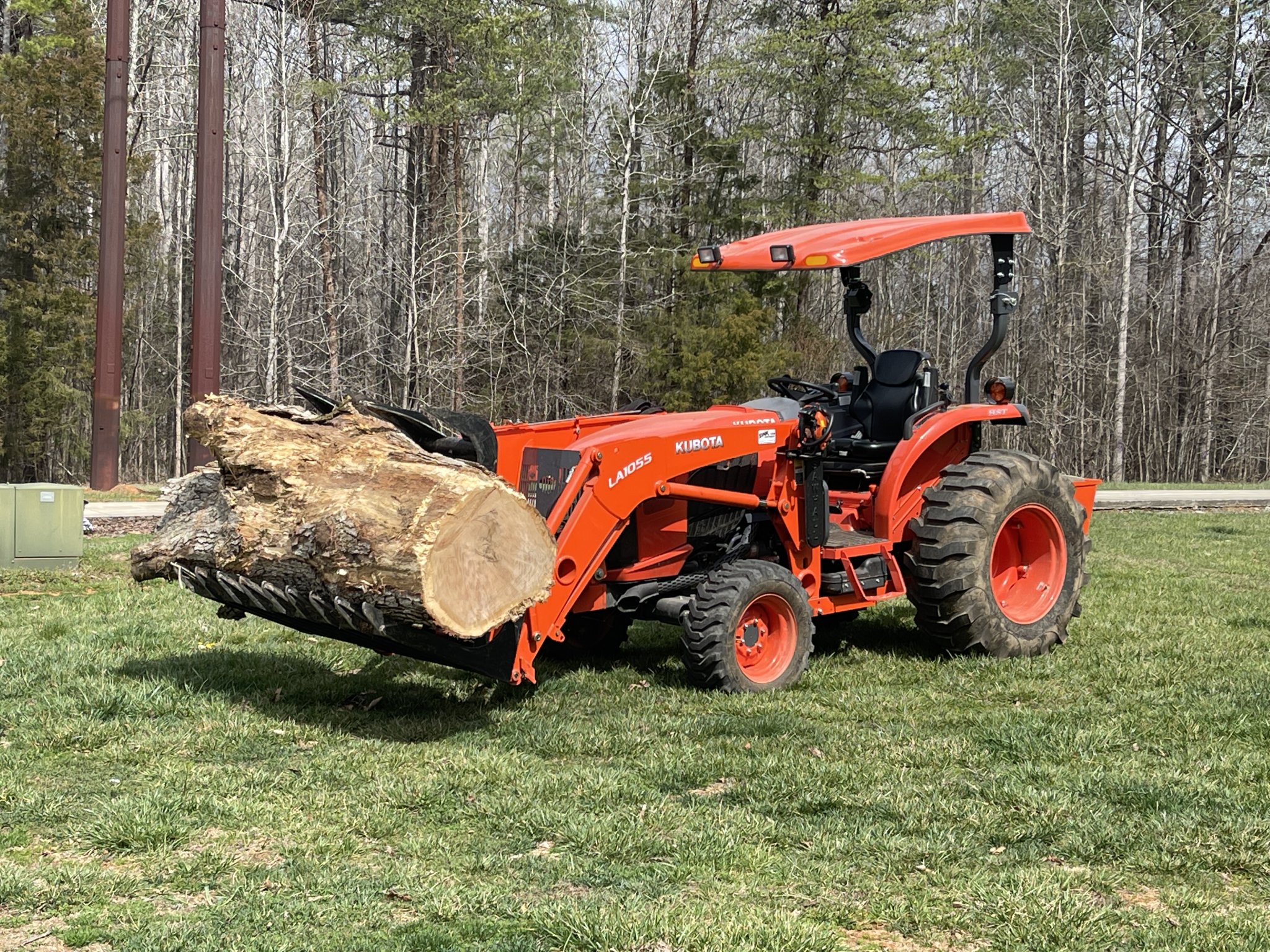

I have a 64" grapple that weighs just over 500lbs. My 4760 has the same loader and lift ratings as the 6060. I have loaded tires and carry a ballast box that weighs close to 1,000 lbs. To me it is a good combination and has plenty of capacity.
