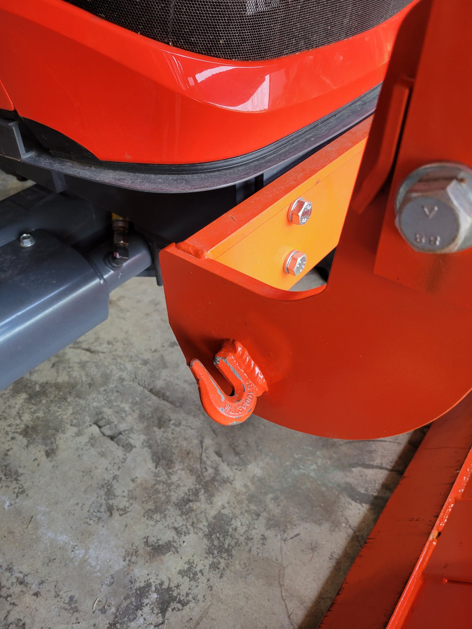

Attach grab hooks to the tractor in strategic locations. View attachment 76564 View attachment 76565
That’s pretty slick!
I never minded using chains to tie down, but it was inconvenient. With a small frame tractor (B2650), it is a bit tricky to get good chain routing with decently straight shots to my tie down points on my trailer. The straps eliminated the quirkiness that was the life of a chain…

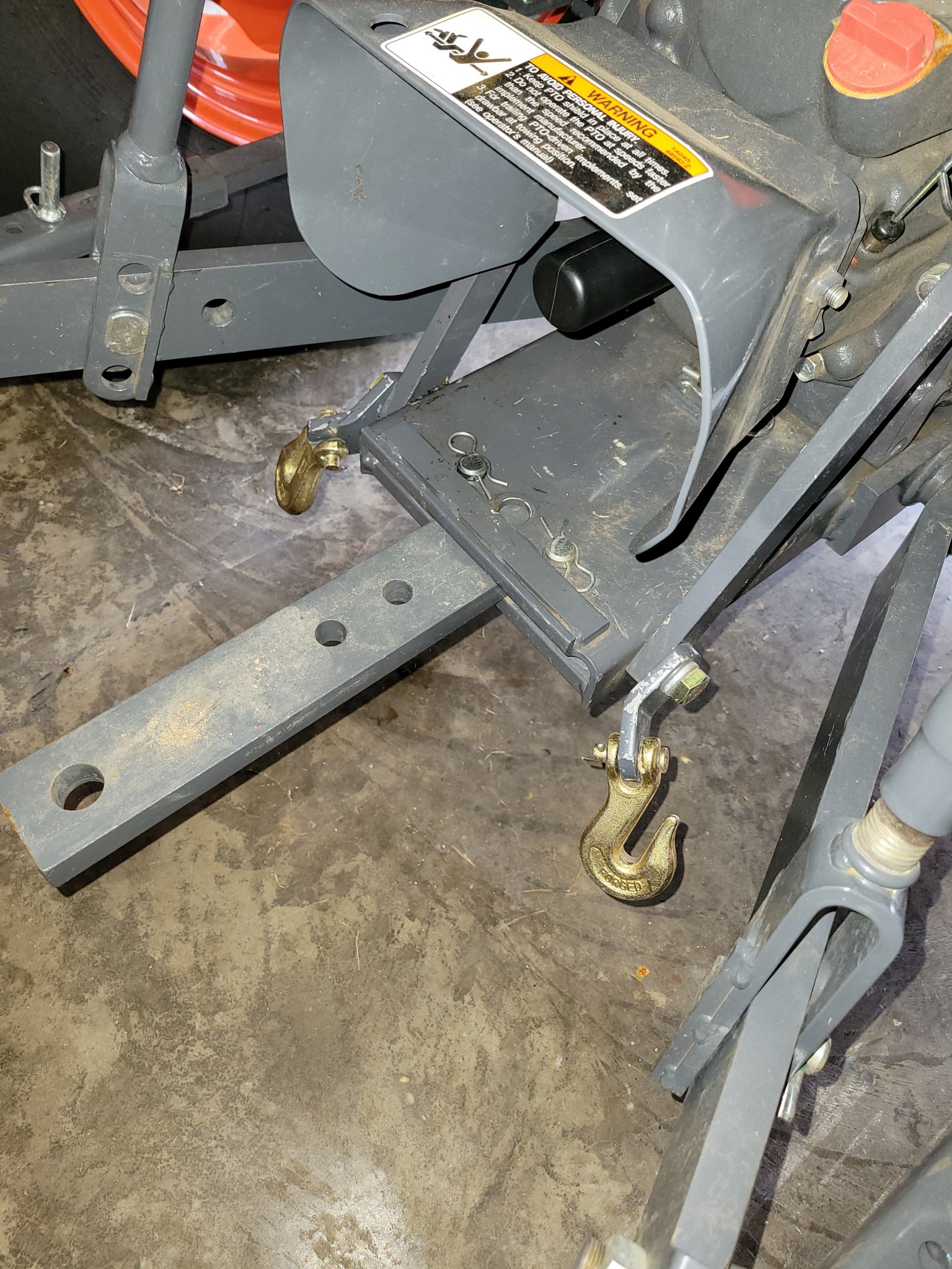

Here's another option for you. Rear clevis and harbor freight hooks that match up to existing frame holes (no drilling/welding necessary). I think the HF hooks ran about $7.
